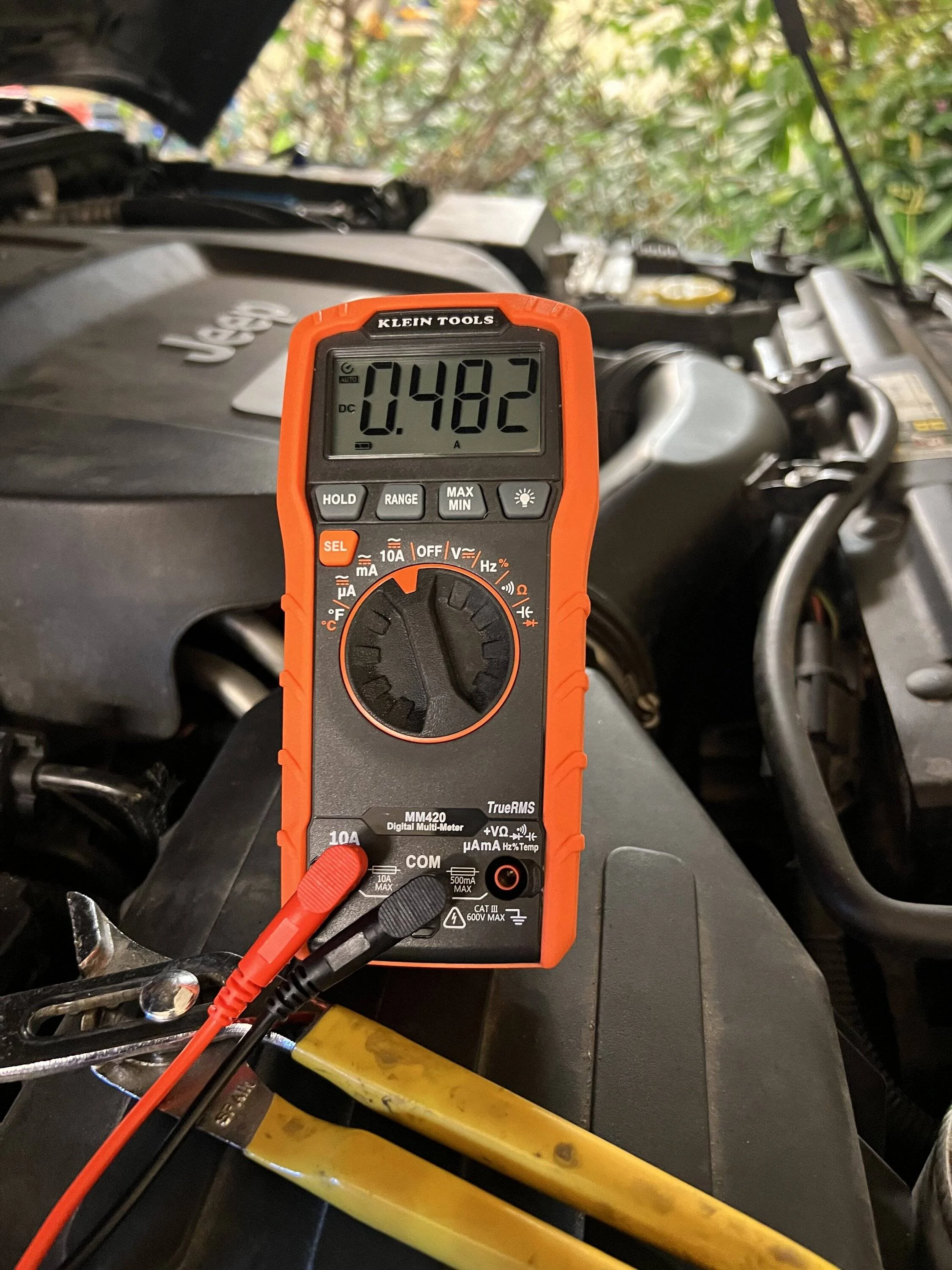

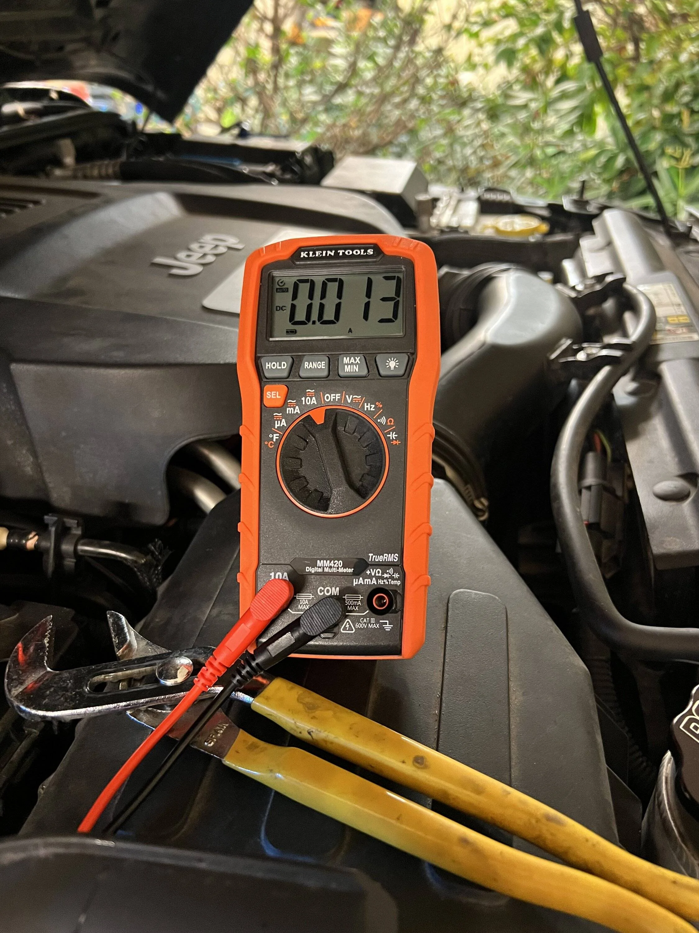

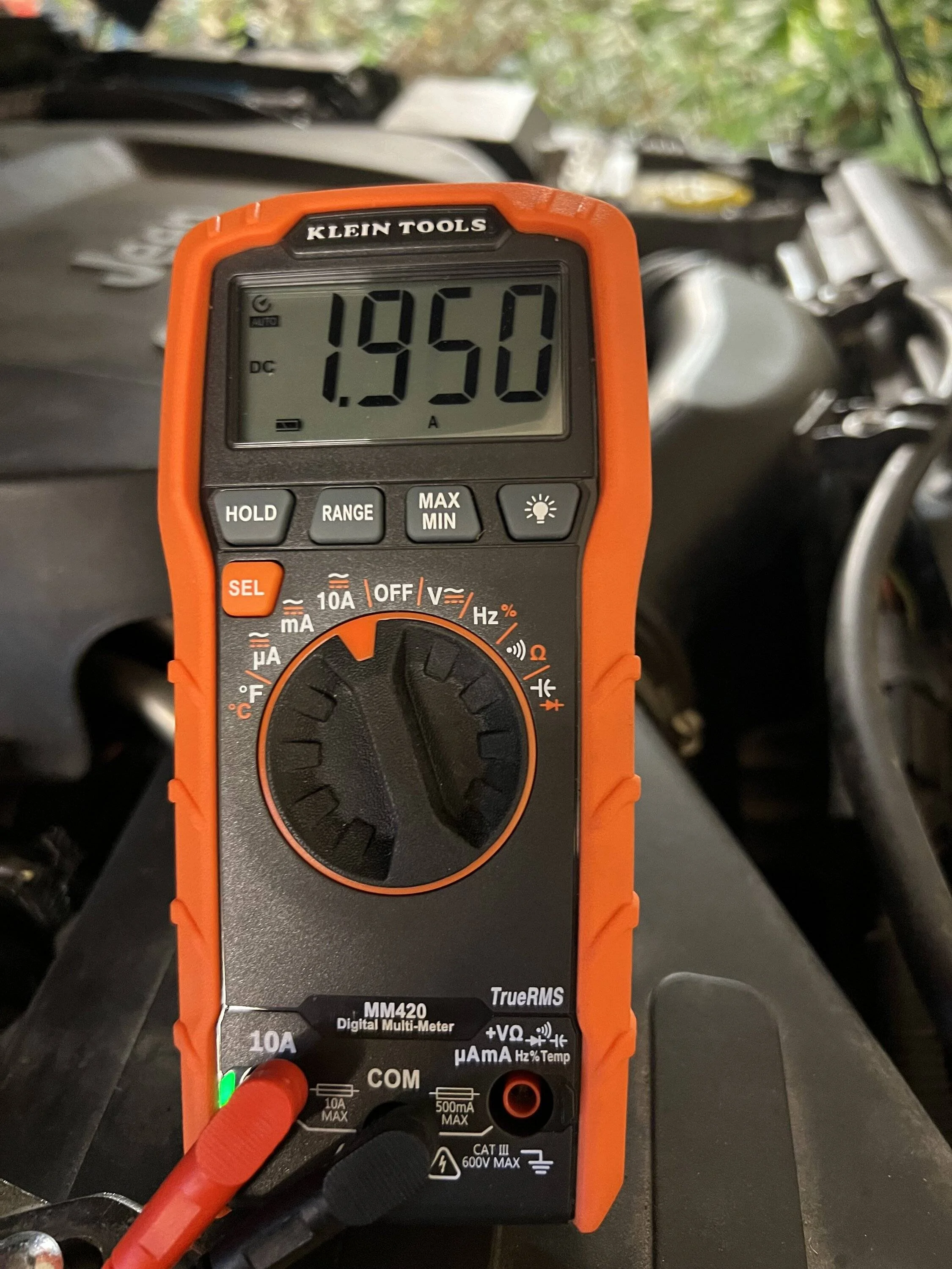

You need to give the vehicle time to settle down all the “wake up” components. When you connect the circuit with your multimeter across the neg post and the neg cable, you wake up the door locks, lights, the head unit and other things waiting for you to get started or looking for your wireless input. It may take several minutes, 5, 10 or more, to drop back to steady state parasitic draw. Your winch bluetooth may be giving you several extra minutes to get set up by staying awake.
Here are some pictures taken at sequential times to show how immediate amperage drops over several minutes.
Initial reading 2:53pm:
Jeep Wrangler JL Warn Winch 50ma constant draw IMG_7793
2:58pm:
Jeep Wrangler JL Warn Winch 50ma constant draw IMG_7795
3:05p
Jeep Wrangler JL Warn Winch 50ma constant draw IMG_7803
