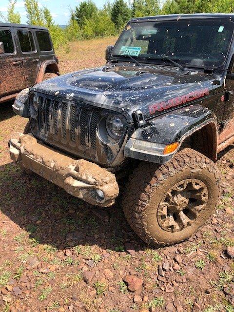

Love my Warn 10-s, last time I used it pulling a 18 Rubi out of the mud is worked like a charm, I also like the Warn 'Epic set" fairlead/hook etc.
Jeep Wrangler JL Smittybuilt vs Warn winch IMG_5044
Jeep Wrangler JL Smittybuilt vs Warn winch IMG_5046

That's a set up that takes up quite a bit of real estate. Personally, I wouldn't want that much junk blocking my radiator, hanging the extra weight off the front end and having the systems separate is more likely to not leave you without one or both if something fails.
JMO.....
i here you, but if you install the winch in the winch bumper, it will sit lower and clears the front grill.
