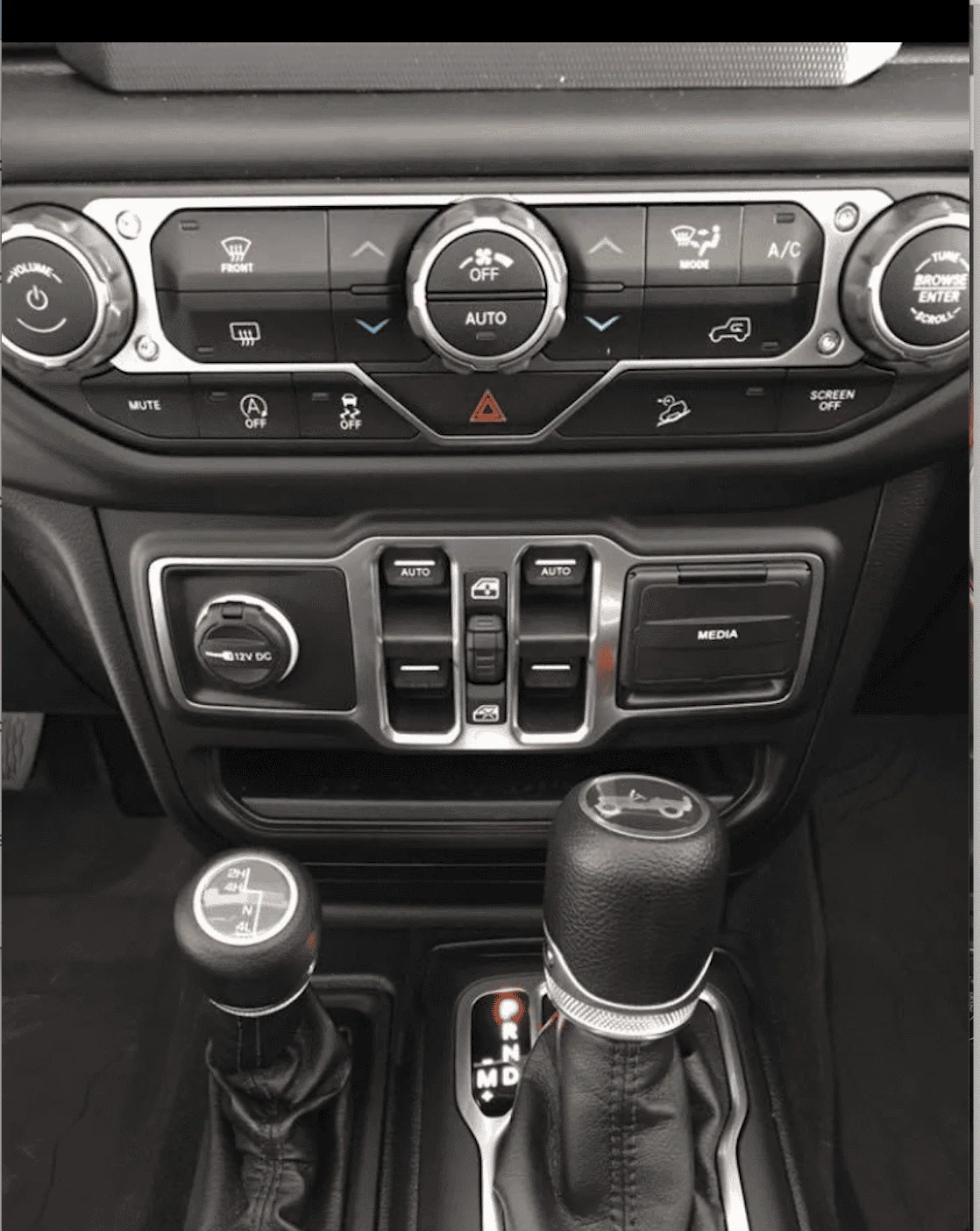

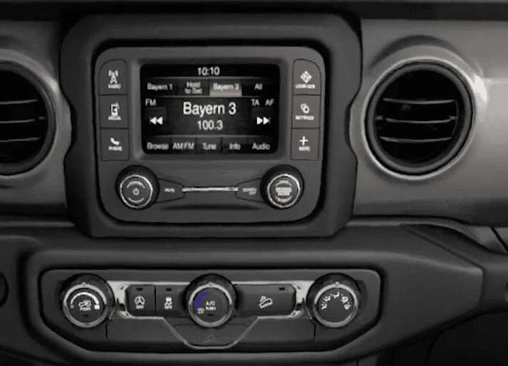

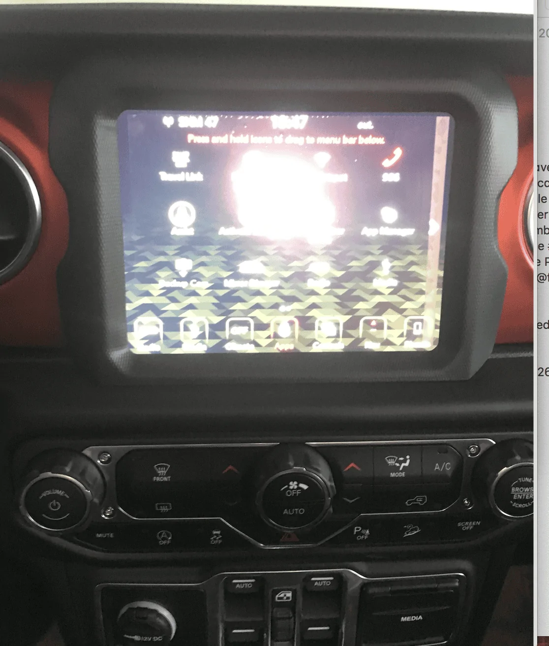

I have a picture of a jeep JL with 8.4" radio showing how the buttons in dash section should look like (1st picture
). I also have another picture of how looks like with a 7" radio(2nd pic). It is possible to convert the original dash buttons (3rd picture) to either 8.4" or 7"?

It’s probably plug and play like everything else, just need to find the part numbers. The one thing I don’t know about is the dual climate controls.

Thanks for posting this up. Digital climate controls were on my wish list, but I didn’t realize they integrated the radio controls. I ordered up the parts to do this, which consist of the climate controls themselves as well as an air conditioning control module which may or may not be needed to do the swap.
Climate controls 6BE28DX9AC
Control module 68249814AE
