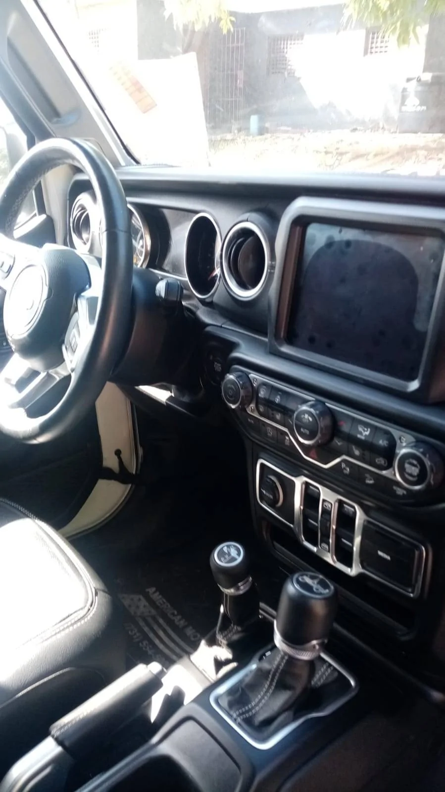

Hi my radio is starting to delaminate I ran out of warranty. I would like to know if you can explain me the process to fix the screen the way you did it.
Jeep Wrangler JL Uconnect 8.4 Screen Delamination PHOTO-2021-09-28-15-16-17

according to everyone else they will replace the radio even if its out of warranty
read back a few pages and see what they say ..
but really its very easy to fix yourself if you dont have that option
get 90% or higher rubbing alcohol - i used 98% alcohol
put a little alcohol on a micro fiber cloth and begin to "buff" rub the coating off .
i used the corner of the cloth and just wet it a little
theres no need to rub at it hard, thats why you use the 90% or higher alcohol.. the anti glare coating will rub off easily and you will notice it for sure once the alcohol evaporates
or you can use another dry micro fiber to speed up the dry time.
to get into the corners if you dont remove the radio beze,l u can use the corner of the cloth to get in there closer or a q-tip ...
once you see the anti glare coating is all gone and clean like new , get some tv cleaner spray or cell phone cleaner clean the screen and get yourself a screen protector online that has an anti glare coating , pop it on headache gone. i will get a photo of the wifes cherokee whenever she is home, she allllllways out wasting my money or doing errands !!! but her radio is still perfect after doing this .
i also heard that baby wipes removes the coating, but i have not tried this ..
the alcohol worked super fast for me and it was clean - but it has to be 90 or higher to work like that
