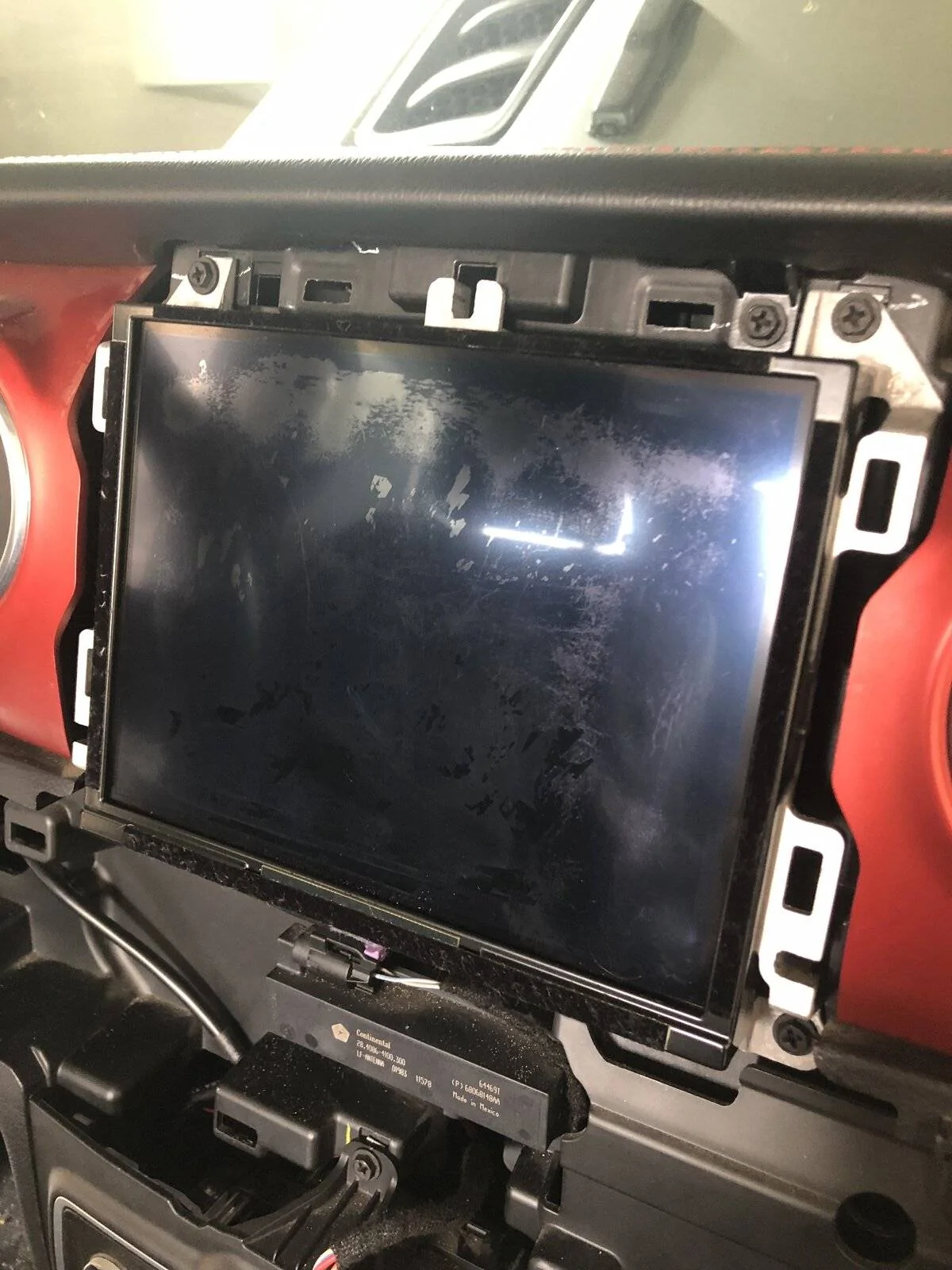

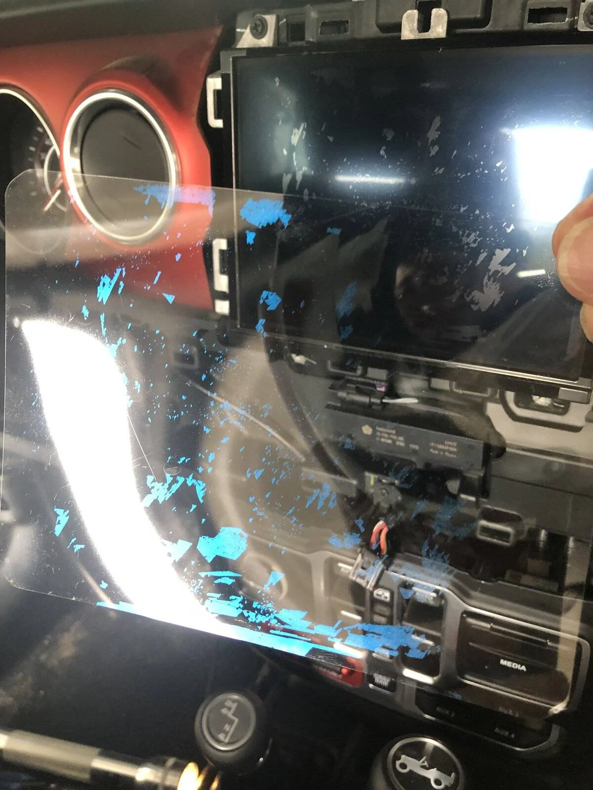

What a joke. Just removed my screen protector and it destroyed my screen. I have a 2018 I bought new with 16000 miles … always garaged. No extended warranty. Past the 3 years.

What a joke. Just removed my screen protector and it destroyed my screen. I have a 2018 I bought new with 16000 miles … always garaged. No extended warranty. Past the 3 years. Can I just purchase the screen… not the entire unit

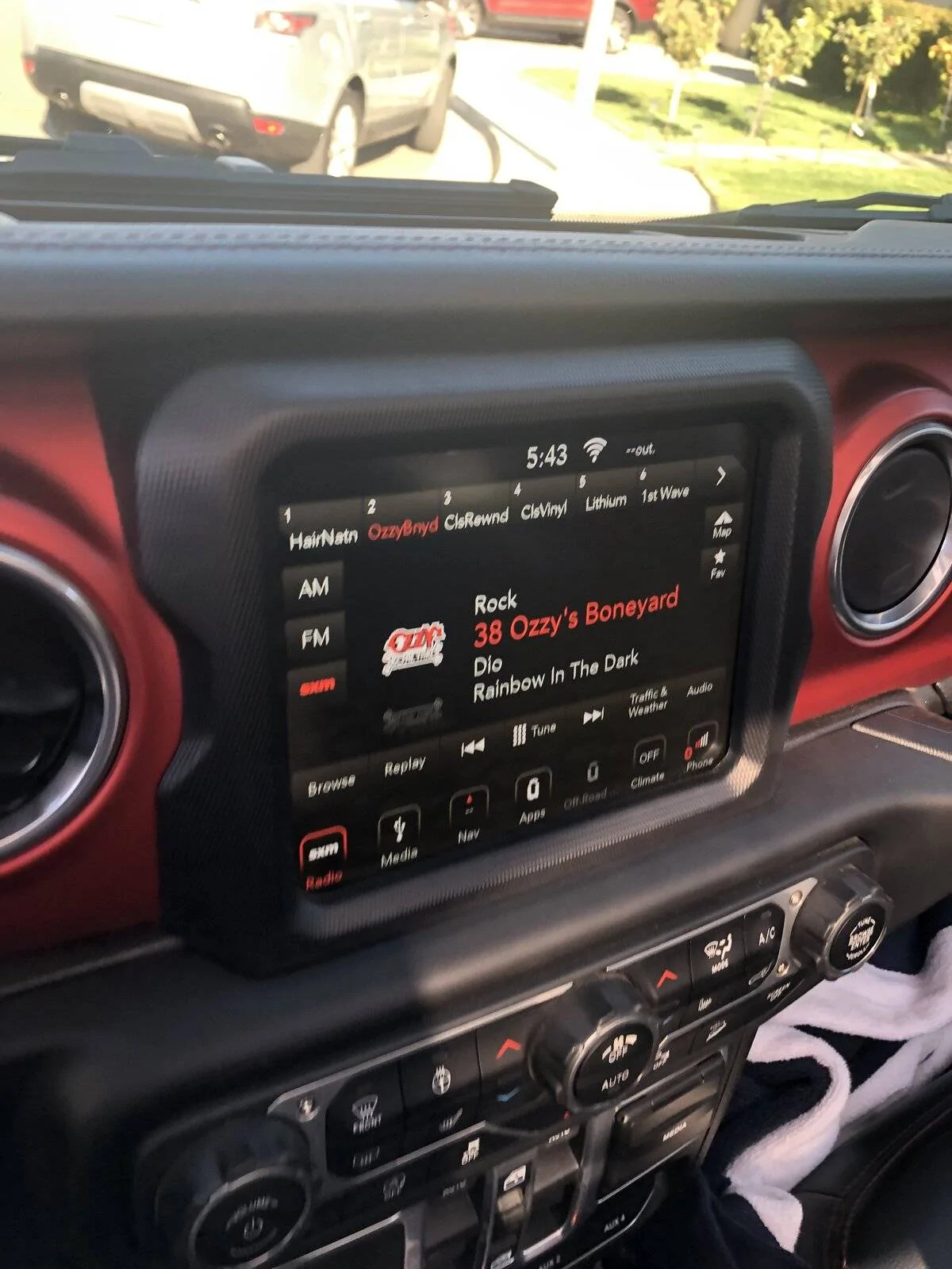

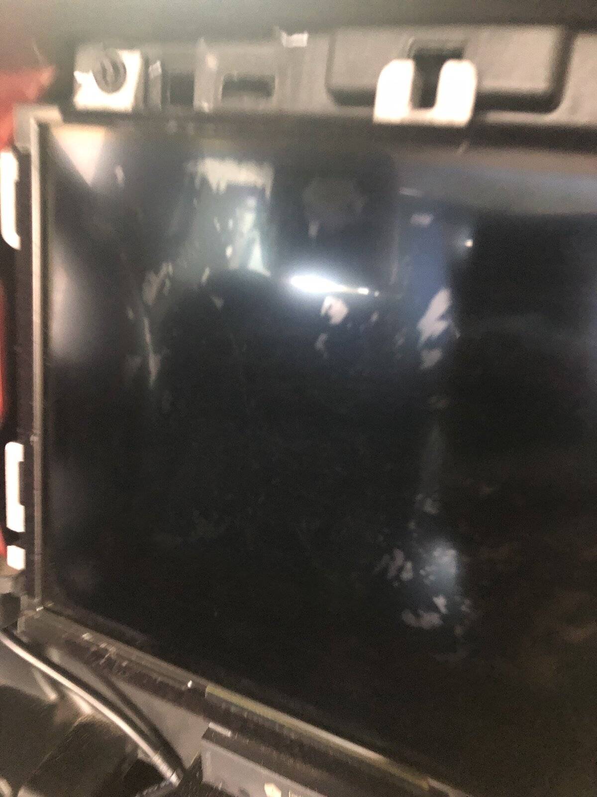

Crazy. I was able to buff out all that delimitation garbage with a soft cloth and invisible glass cleaner. I think the delimitation was funky coating they put on to make the screen a bit glossy. It has more of a flat look now rather than glossy. BUT LOOKS GREAT NOW.. see hardy..see photos.

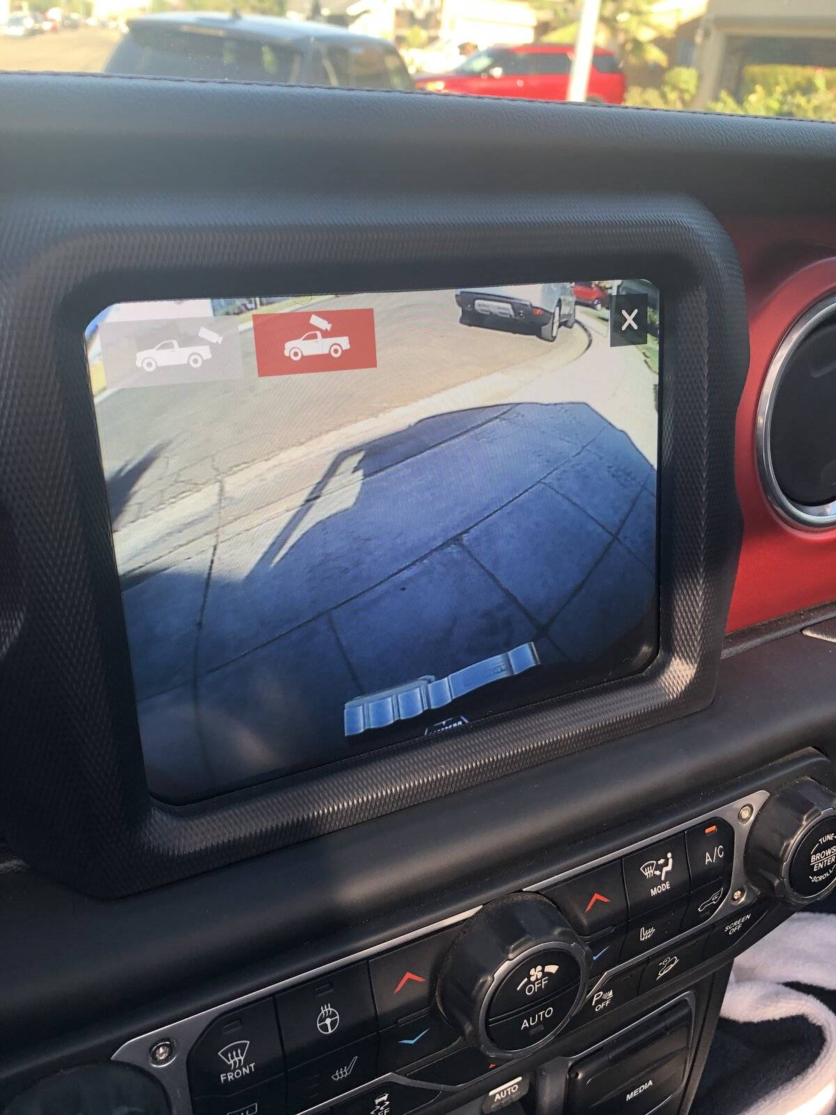

Crazy. I was able to buff out all that delimitation garbage with a soft cloth an invisible glass cleaner. I think the delimitation was stage funky coating they put on to make it a bit glossy. It has more of a flat look rather than glossy. BUT LOOKS GREAT NOW.. see photos.

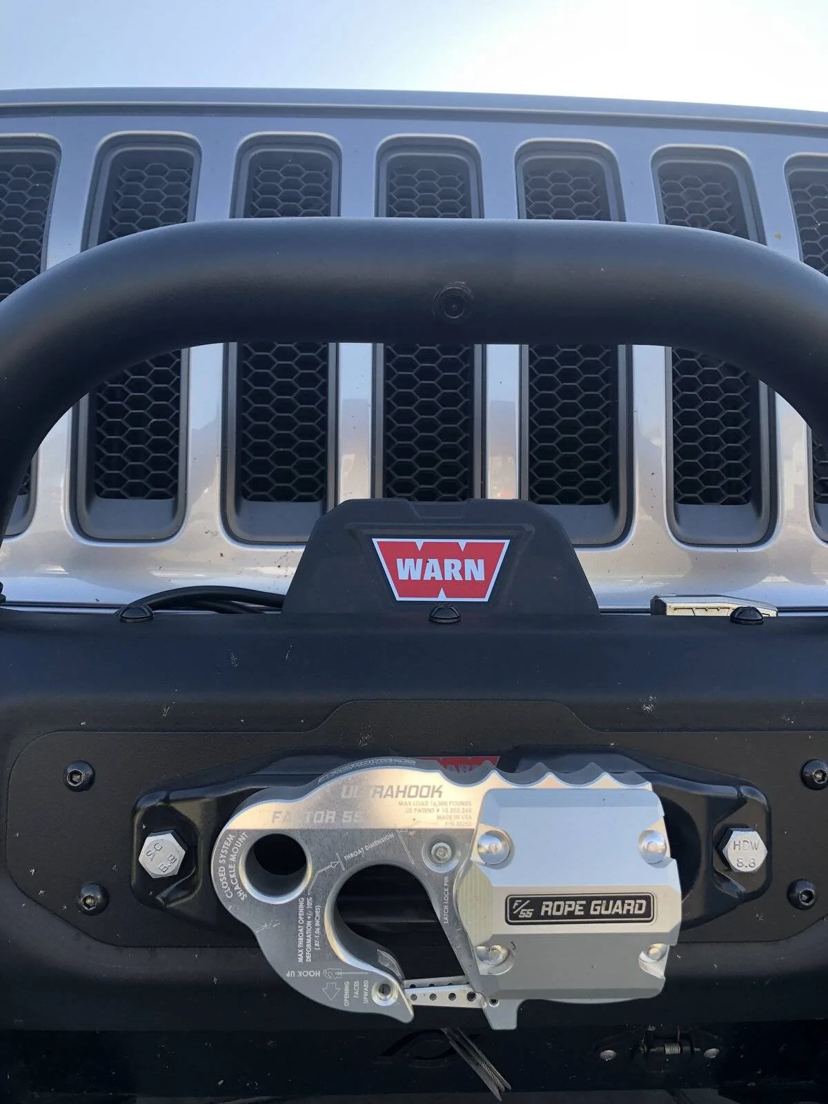

Also added a front camera. Love it can you see where I put it rather than in my grill. I can now see everything I can not see from the drivers seat
