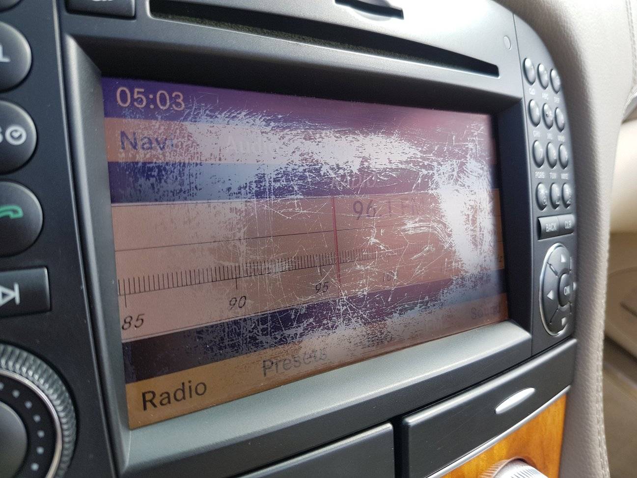

Do you just pull the lose delaminated glare cover off with your fingers? I will appreciate some pictures.
if its just the coating that is rubbing off then the alcohol works -
the anti glare coating is just a coating
if its a screen layer then that is another issue i know nothing about
and have never had it happen to me.
if you read post 72 by spank right under your post this is what i was referring to in alllll of my posts about that issue , not about an actual sreen layer the aka "outer film layer"
so if anyone thought alcohol would remove the film layer - part of the working layer for all laptops radios and other touch screen toys, sorry - this is only advice to remove the antiglare coating
pictured below - if your radio is like this - then this is the anti glare coating. this one is BAD but you get the idea .. the alcohol will work just rub it around untill the coating is gone and your left with a clean screen , minus the anti glare coating - then just add a screen protector with the anti glare coating on it .. u can even remove the radio bezel to get more removed .
