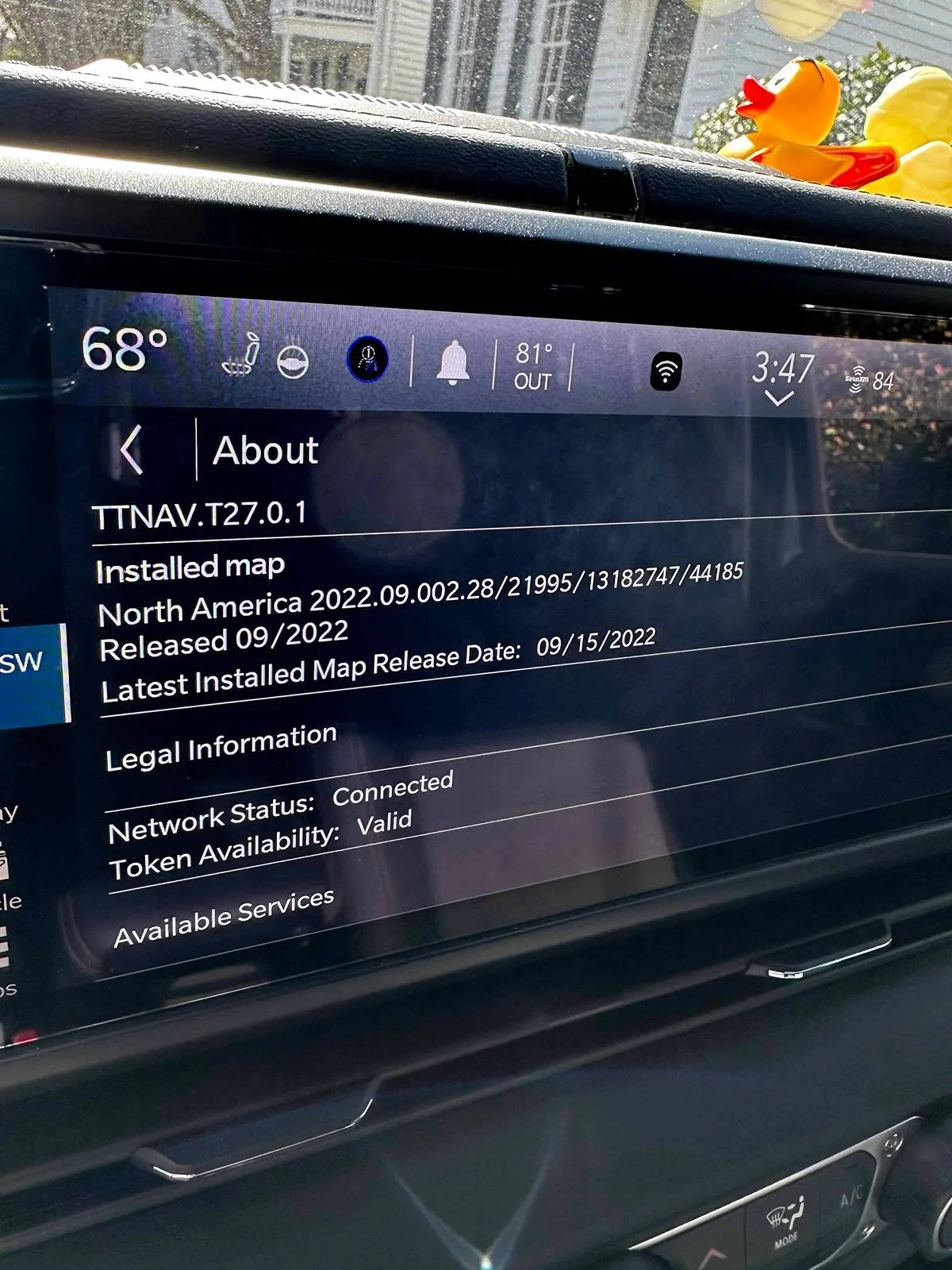

OK, I've done a little digging. @Ratbert was kind enough to share the street in question with me, and I confirmed that my map still shows it as one way. Apple maps also shows it as one way. I have not yet found a way to submit updates to TomTom.
I also dug through the map settings and it looks like it's a map version from September 2022. That's not good.

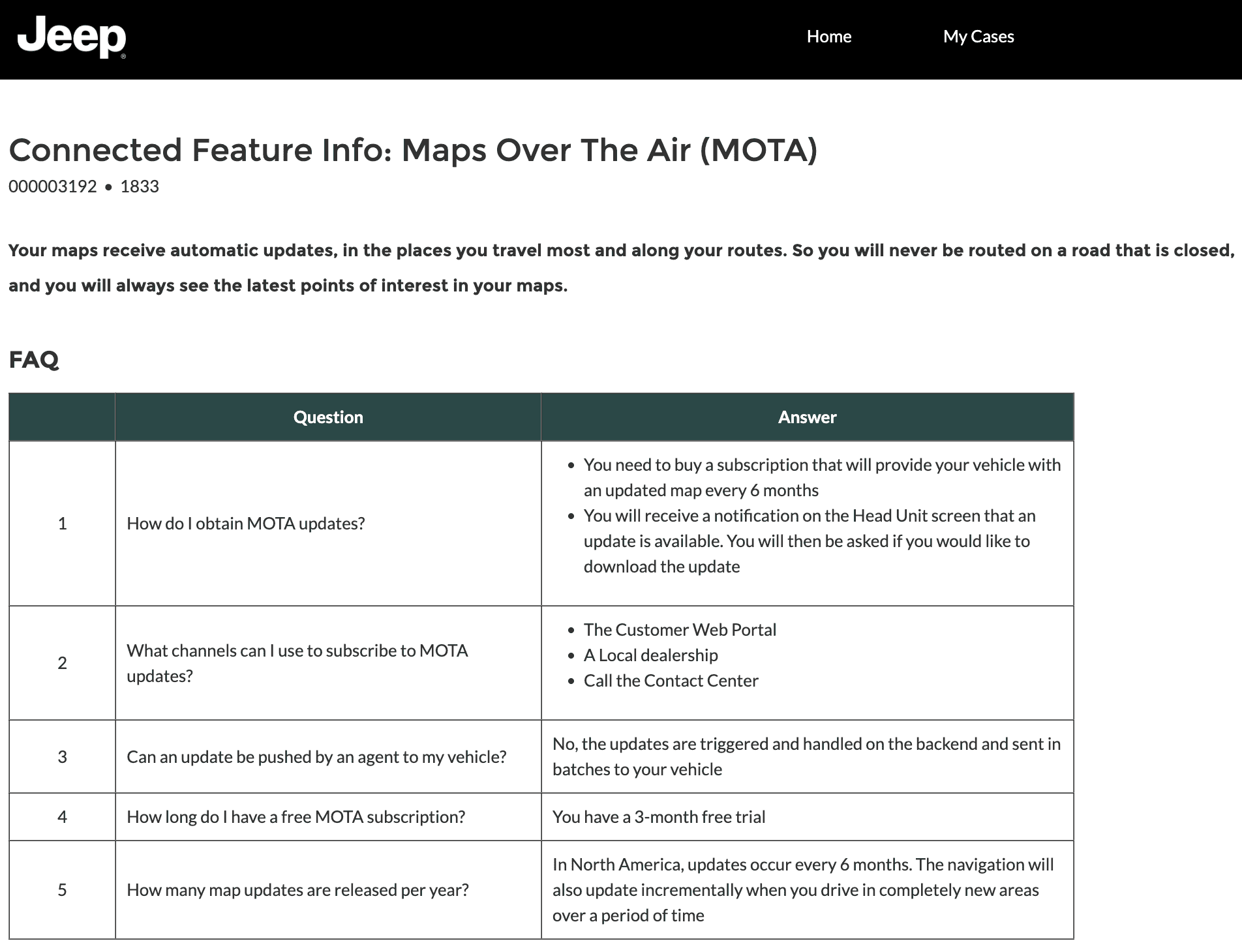

Again, this is for the 2024 model Uconnect 5 NAV feature. According to the Navigation service in Jeep Connect support:
https://fcagroup.my.site.com/gsdpv3/s/article/GSDP-MOTA-Maps-Over-The-Air
It suggests that map updates happen automagically "over the air" every six months, and incremental changes will happen "as you drive in new areas". I don't drive in Ratbert's area. :)
I will be contacting @JeepCares (case number 89295938) to see why I haven't received my 6 month update.

There are several factors at play.
In your screenshot, it says maps are released/updated every 6 months along with the incremental updates over time.
It clearly says that you need to buy a subscription for MOTA (Maps Over The Air). It also says you get 3 month free trial.
So unless you are in your free trial period or paying for MOTA, you aren't getting anything.

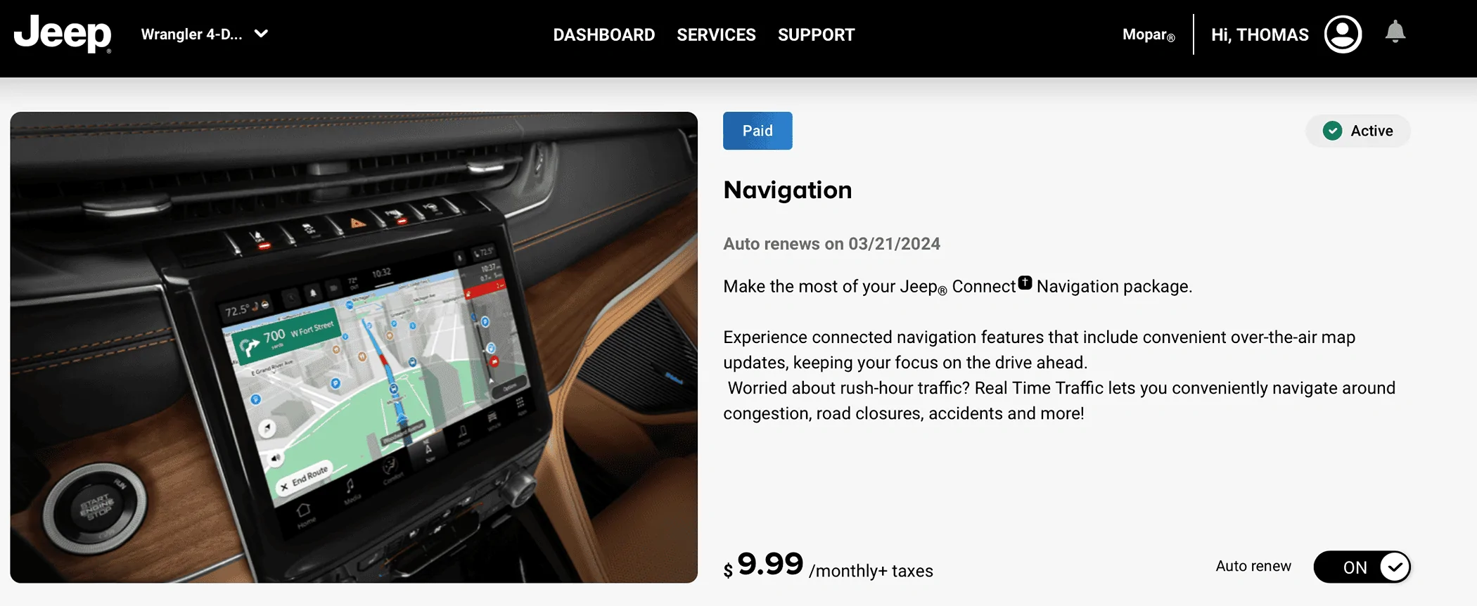

I don't think that what it is saying. There are several factors at play.
That's right. I am subsrcibed. I decided to try and it and see for myself if it's worth it. Otherwise I will cancel.
If it is anything like the crap updates they offer/offered for the older 8.4" NAV system, I think you'll be waiting a long time for nothing.
Good luck. Keep us posted as to whether Jeep Cares has an answer for you.
A year and a half old in a 2024? Holy crap. Fortunately the user experience is significantly better than in prior incarnations, but still, that's unacceptable IMO.

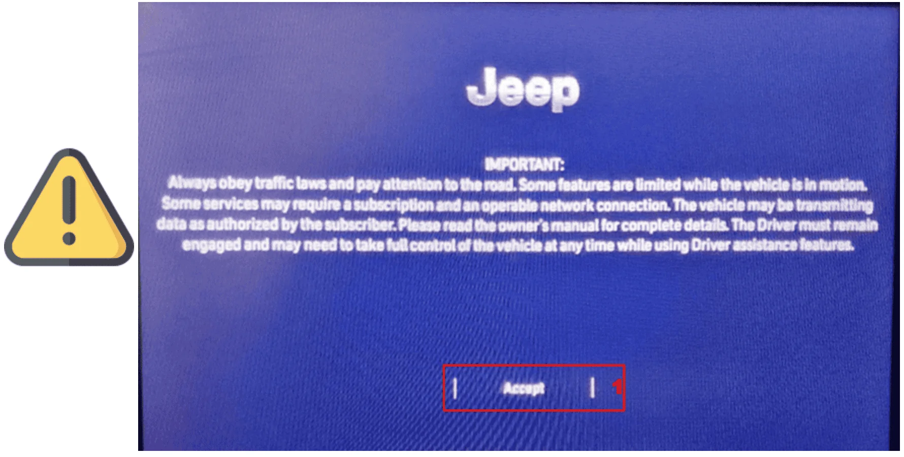

Complete
a radio reset via the head unit soft buttons. ACCESS VIDEO HERE
  1. CHOOSE APPS IN BOTTOM R CORNER
  2. CHOOSE VEHICLE TAB
  3. SCROLL DOWN AND CHOOSE RESET
  4. CLICK RESET RADIO
Screen will go black and restart will begin
Loading Screen will appear at the end of the reset. Customer will need to choose ACCEPT. The customer must begin the Clear Personal Data process within 10 minutes of the reset.

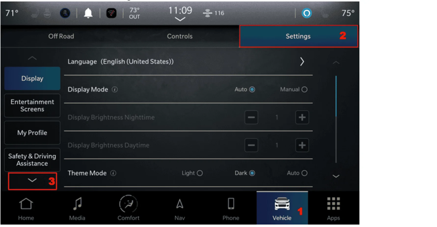

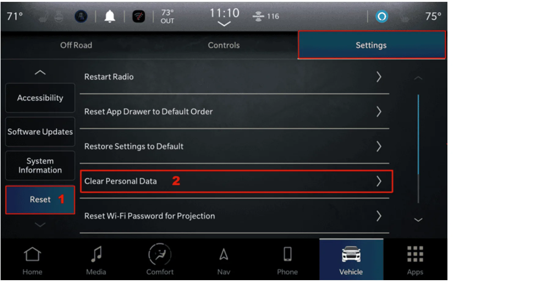

4CLEAR PERSONAL DATA: (THIS IS NOT THE SAME THING AS A FACTORY RESET)
Before beginning Clear Personal Data, inform the customer that they will lose all preferences, including profiles, radio settings, etc.
5On Head Unit choose Vehicle → Settings → and scroll down to Reset
Jeep Wrangler JL Uconnect® Navigation Map Upgrade Offer 1710439611919-rt
6Choose Reset → Choose Personal Data

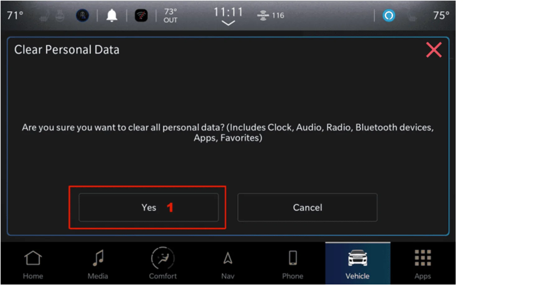

7Customer will then be prompted to clear personal data - Choose yes. Once the customer chooses yes, they MUST leave the vehicle running for the duration of the Clear Personal Data Process.
Jeep Wrangler JL Uconnect® Navigation Map Upgrade Offer 1710439655325-ac

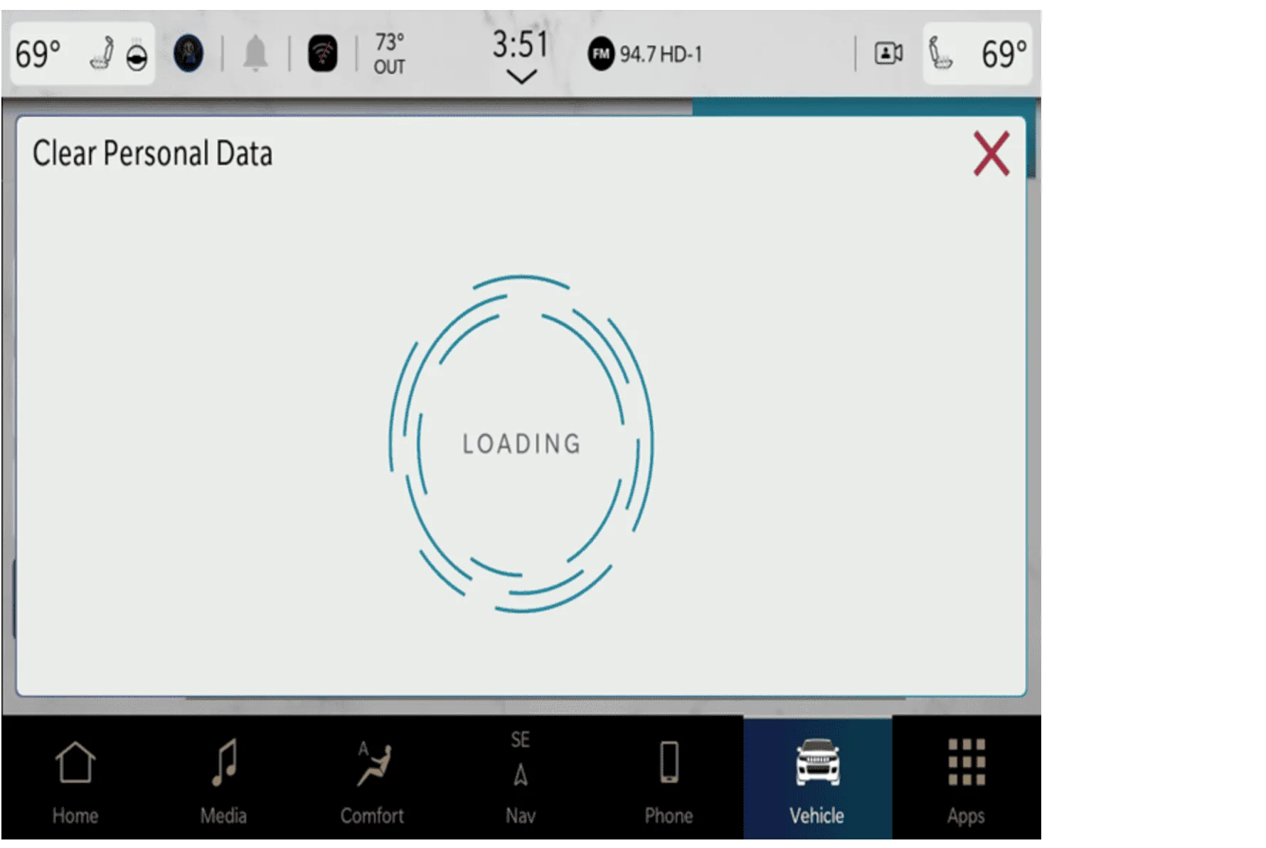

8After choosing yes, the customer will see the following Clear Personal Data loading screen. During this time, they must leave their vehicle on and running.
  • Do not click the X- it will cancel the process.
  • Vehicle must remain on with the engine running for the entire process
Jeep Wrangler JL Uconnect® Navigation Map Upgrade Offer 1710439686488-h1

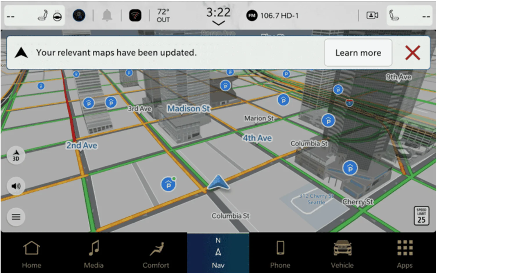

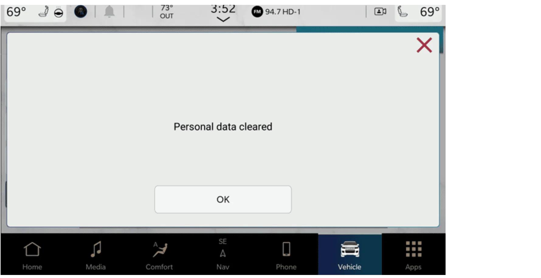

9When Clear Personal Data is completed, customers will see the completion screen and receive a message stating that their maps have been updated.
Jeep Wrangler JL Uconnect® Navigation Map Upgrade Offer 1710439707678-8v
10Once Clear Personal Data is complete, the customer will want to let the vehicle run, with the engine on, until the following message is seen on the head unit stating that the maps have been successfully updated.
Jeep Wrangler JL Uconnect® Navigation Map Upgrade Offer 1710439730567-dh
