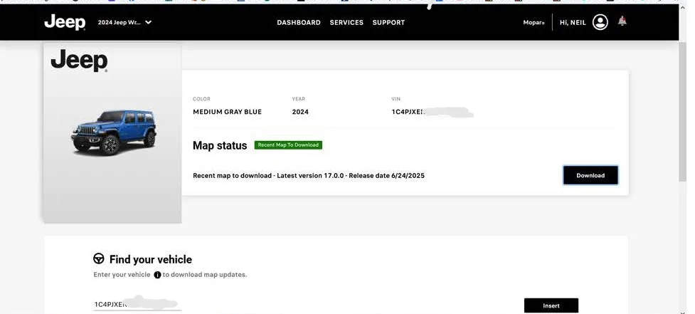

Good afternoon. Either am having a brain fart or my radio head is refusing to play nice with me.
First I attempted to access the new map from connect.Jeep dot com web page. It finds my vehicle and shows the new map version. I click download and the circle spins a few times and then stops....nothing downloads.
Next I reached out for assistance via their chat and the suggested that I download the FCA Toolbox to my PC, then take a thumb drive out to the Jeep and plug it in, then follow these directions shown here: INSTRUCTIONS Well, I am unable to find any icon anywhere that says "MAP UPDATE"
So then they tell me to download the map from from this web site. I was able to download the map, unzip it and move it to my thumb drive. When I plug it into the USB port, the light on the thumb drive blinks a couple of times and then stops. I've used this option before & it worked fine.
Do any of you have any thought as to what I am doing wrong?

I'm using the PC with Windows. I have v.2025.6 downloaded and unzipped. Only the 8 map files were moved to the thumb drive. (The last update before this installed flawlessly using the same machine and thumb drive)

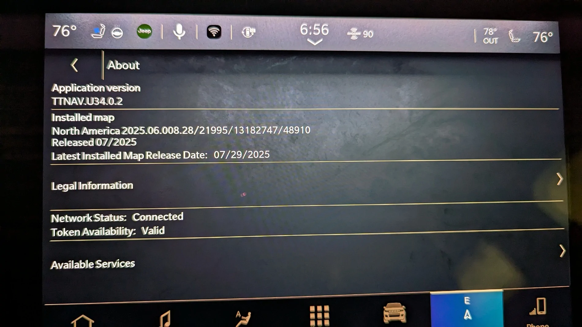

I finally got the V.2025.6 update to install via the thumb drive. It took multiple attempts and on the final try for the night, I reformatted the thumb drive again. This time I didn't select the quick format option and when the format was complete, I copied the files over to the thumb drive from the PC. It took about 40 minutes for the map files to transfer to the infotainment head.
