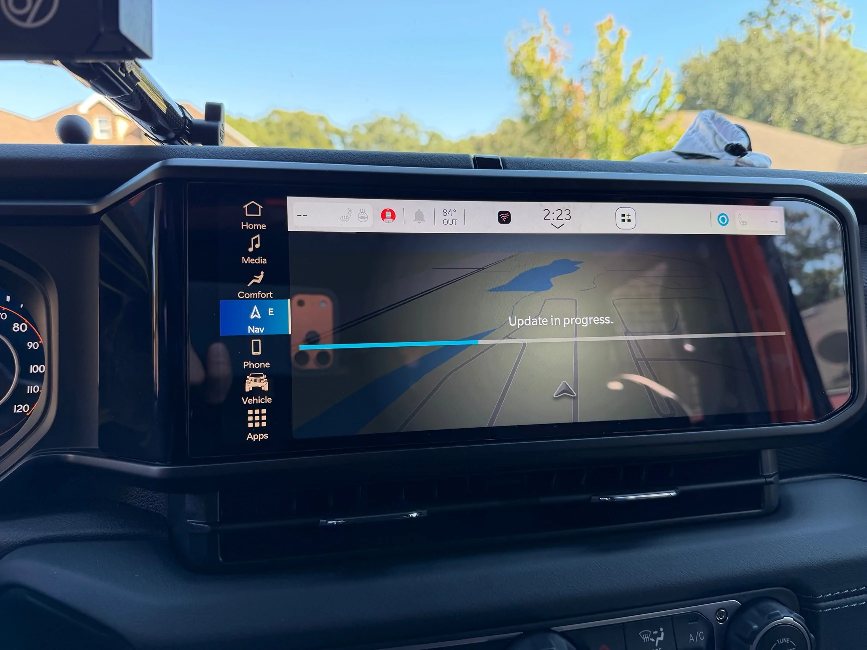

Downloaded files from Jeep Connect website after adding VIN and refreshing page (8 total). Formatted the card to NTFS (not xFAT). Turned Jeep to On, put drive in and asked to update. 25 minutes later maps were updated and my GPS time sync issues were also resolved. I have a 2025 that was running a 2024 version of the maps. “Great success!” And thanks to this thread!
Jeep Wrangler JL UConnect5 V2024.09 navigation map update available IMG_0079
