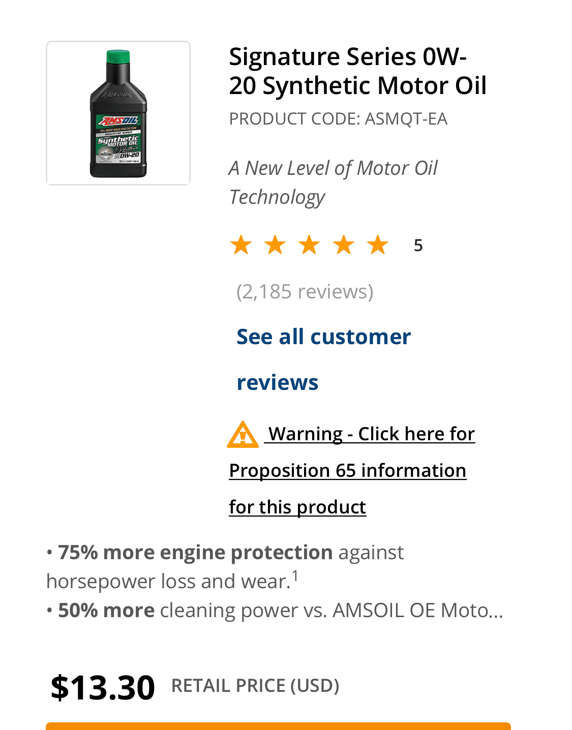

The above is AMSOIL's 25,000 mile oil (Mobil 1 nor anyone else has anything comparable) starts under $10 a quart. The AMSOIL OE is similar to the Mobil 1 your are buying and I can sell it to you for $5 a quart if you have a qualifying business. Do you have a business?
