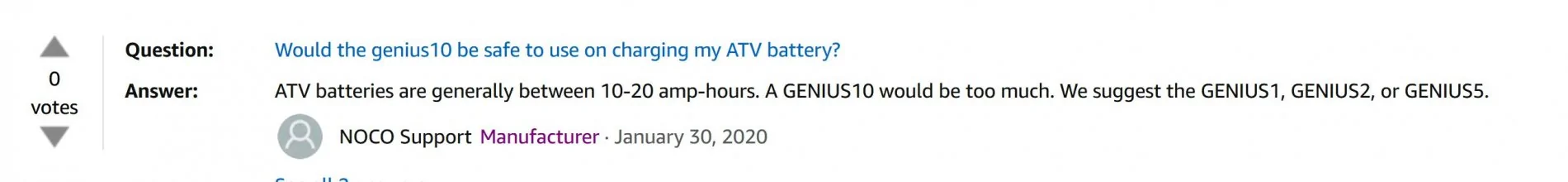

The Auxiliary battery on a stock, JL is a 12AH, AGM battery. It is not prudent / wise, to charge such a low AH, battery with a Noco Genius 10 amp charger. Even a Noco Genius 5 amp is pushing the limits and not suggested.
Below, is a post by Noco, Tech Support in regards to a 10-20 amp hour (AH) battery and using a Noco Genius 10 on it.
Even with the AH being much greater then the JL's, 12 AH Aux, Noco says not to use a Noco Genius, 10 amp charger on a 10-20 AH battery.
Sure people can say they have used a 10 amp charger on a 12AH, AGM battery, but that does not make it a wise or prudent thing to do..

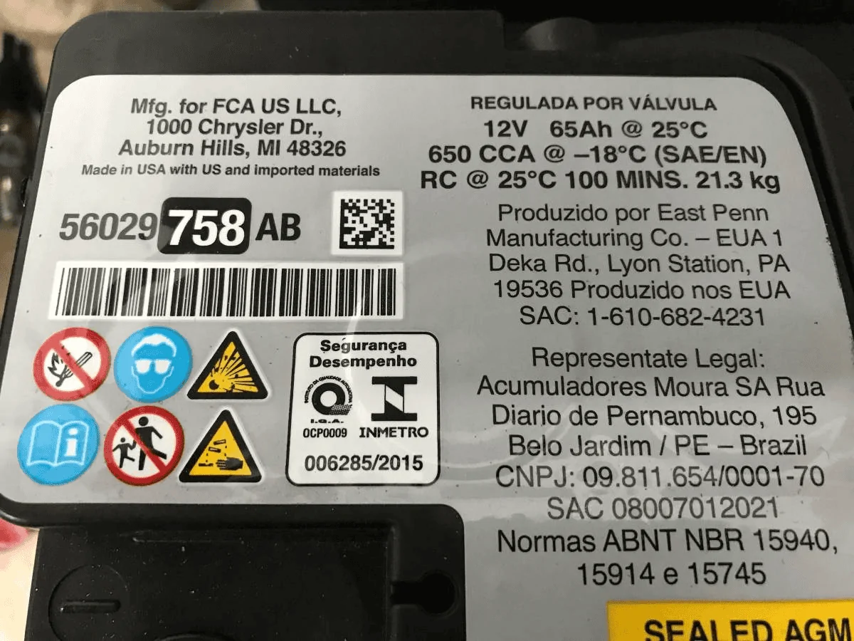

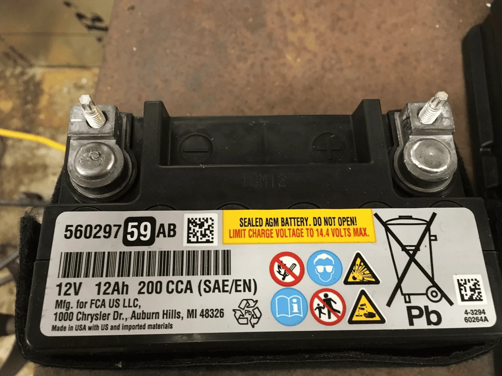

Hey Dan:
On the 3.6L JL the Aux battery is a 12amp hour battery. It can provide, roughly, 12 amps for an hour or 1 amp for 12 hours (2 amps for 6 hours etc.)
Jeep Wrangler JL Trickle Charging Procedure 1608433867062
The main battery is 65 amp hours.
Jeep Wrangler JL Trickle Charging Procedure 1608433927697
