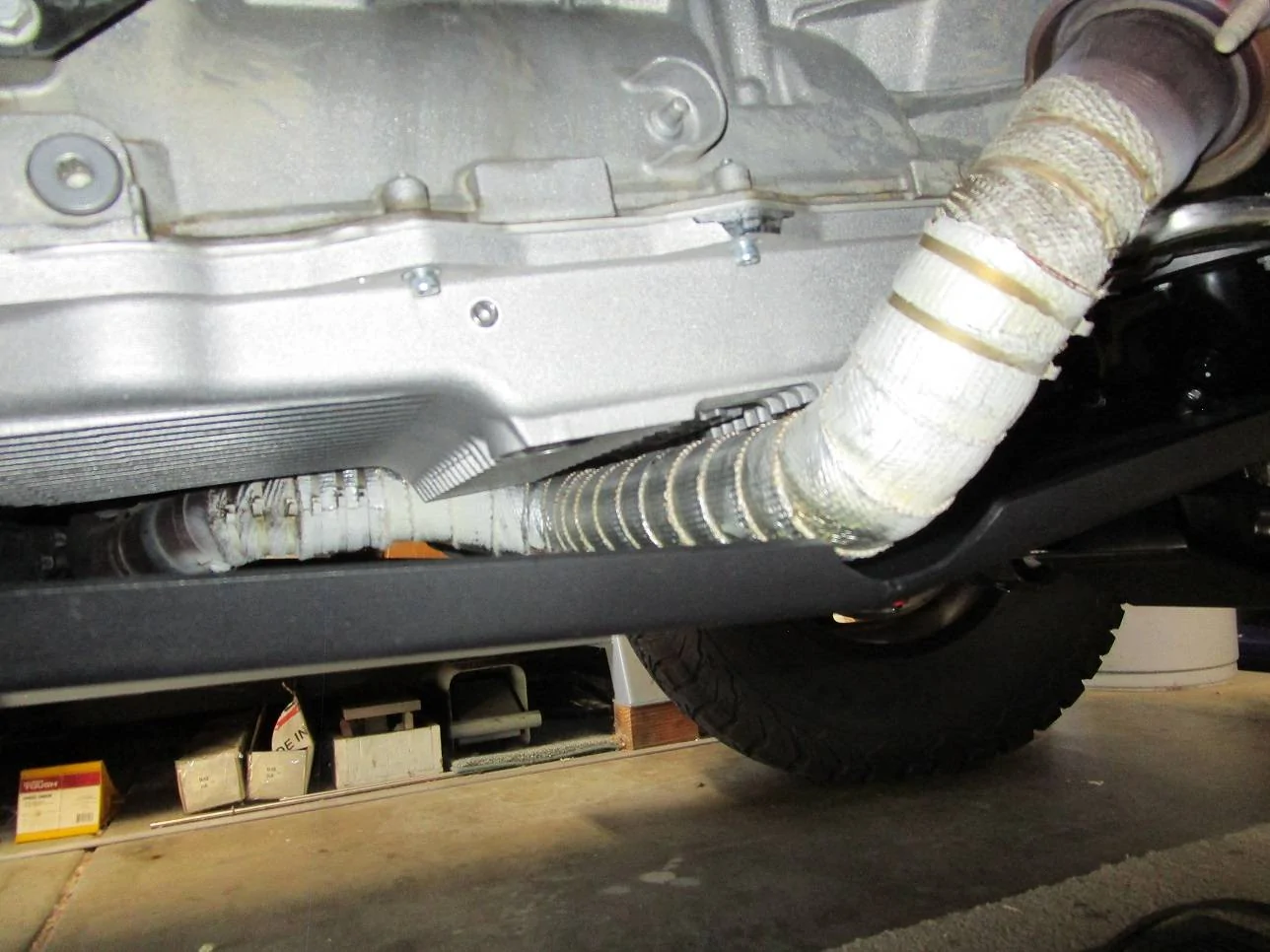

My would hit about 225 on a 100 degree day normal stop and go driving
So I had an idea
Rap the exhaust where it passes under the trans pan
First I just did a single rap with a loosely weave put did not see much of a change in exhaust temperature. About 400 to 450 degrees
Then I raped it over what I just put on with a foil backed tighter weave rap
Now the bare pipe is 400 / 450 put the rap is about 200 degrees
Now the trans hovers about 200 degrees on a 100 degree day. Even with my skid plate back on
Today outside temperature hit about 107 and still I am at 203 trans temp
I am still testing put looks promising
The only problem I have had was the foil backing on the second rap is starting to come off
I think I am going to remove the foil backed rap and re-rap with the foil down and see how that works
And yes. It ran 225 degrees with the factory pan and the aluminum pan
So I had an idea
