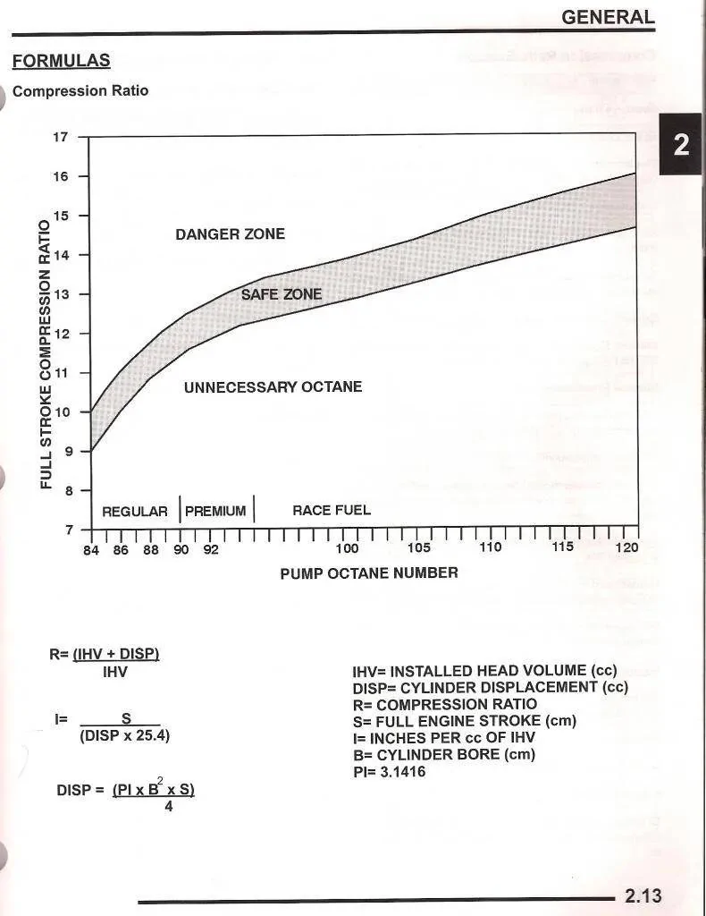

Well lets rationalize this a bit. Octane has a definitive reason for existing. There are many engines that require higher octane in order to deter pre-detonation. Below is a chart that offers a look into why that is.
Jeep Wrangler JL TrailRecon- Engine Failure 1748533251280-8
This is an older chart from an old textbook, but the information is still relevant. The 3.6 in the JL has a 11.3 to 1 CR. 87 octane is on the boundary between safe and danger. I believe that especially when hot out, one should err on the side of caution and run 89 when available. That's not sensationalizing anything, or insulting anyone's intelligence and ability to make critical decisions. Just showing facts, and offering my opinion based on those facts.

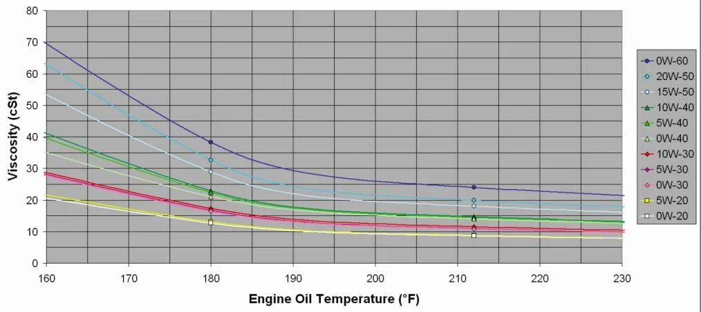

With oil, that horse has been beaten to death ad nauseum here before. It doesn't cost anything more to run a slightly thicker oil. And it again, adds a slight advantage to helping oil maintain the hydrodynamic layer of fluid between surfaces. This can be seen on the chart below.
Jeep Wrangler JL TrailRecon- Engine Failure 1748533927037-lr
0w-20 is very thin at operating temperature. Below 10cSt above 200F which all our engines operate at. Switching to a 0w-30, 5w-30, or 0w-40 is still within the specified range of viscosity for the engine at operating temperatures, while maintaining a better fluid layer at temperatures above 220, where the oil runs at frequently when in hot environments. This is why many, many manufacturers have different recommendations for viscosity based on where the machine was going to be operated at.
