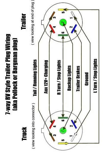

This shouldn't be that difficult, you don't need an adapter. You need to sort out the trailer wiring, do you have a multi-meter or a battery powered test light? You say the curt tester shows all is good with the JLU. If your 7/4 pin connector is like mine on my 2019 the 7 pin receptacle is rotated 90 degrees to the left i.e key-way facing left not on top. I would verify that Pin 1 (ground) is in the proper location on the Jeep and the trailer.
I agree it shouldn’t be this difficult. The JLU should be plug and play just like the GMC but that’s not the case. The trailer has a 6 round, the JLU has a 7 pin so yes an adapter is necessary. Look at the pictures I posted it will show what I’m working with. And you’re correct when I connect the 7 pin to the JLU it is rotated 90 degrees clockwise.
