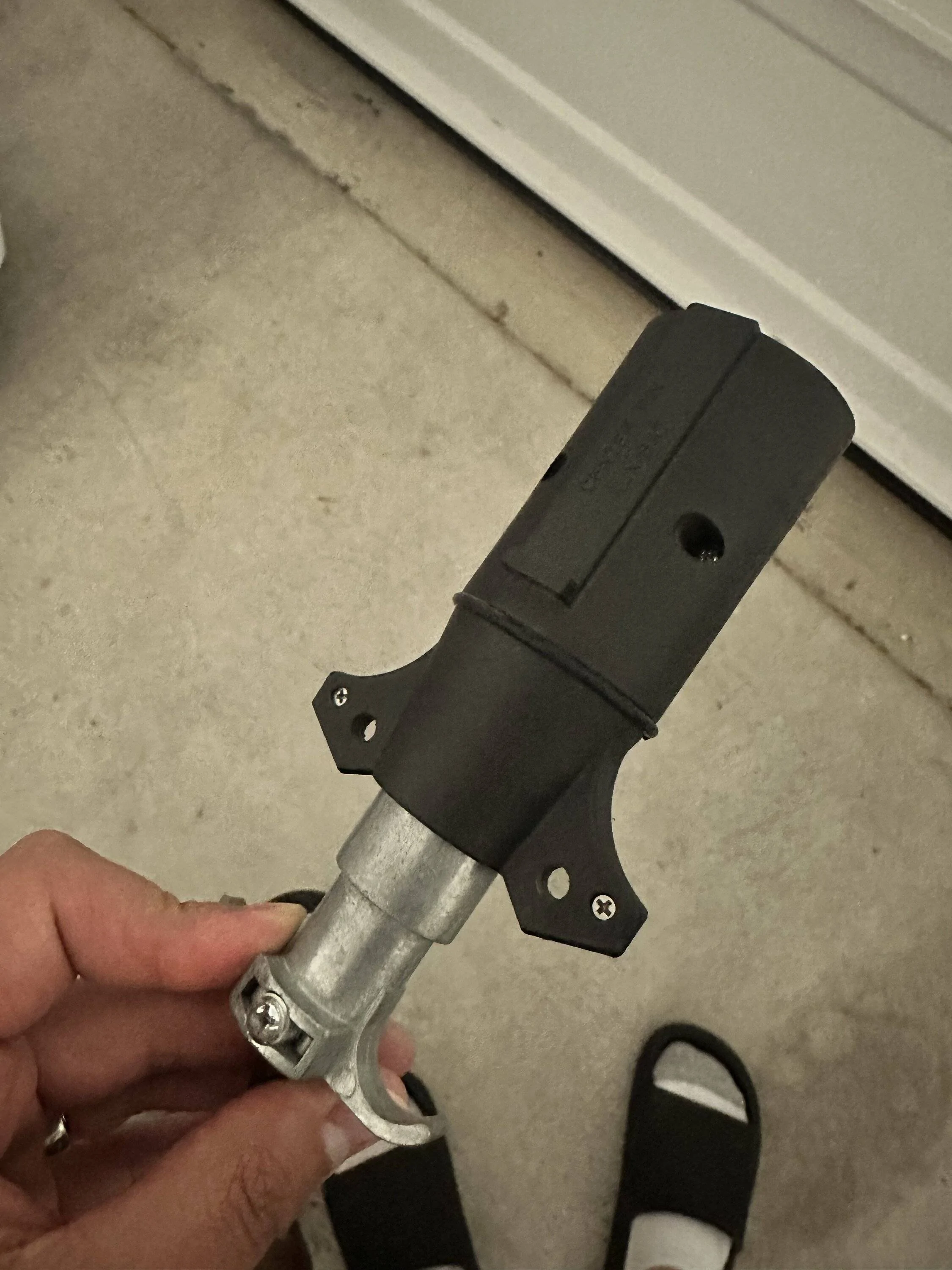

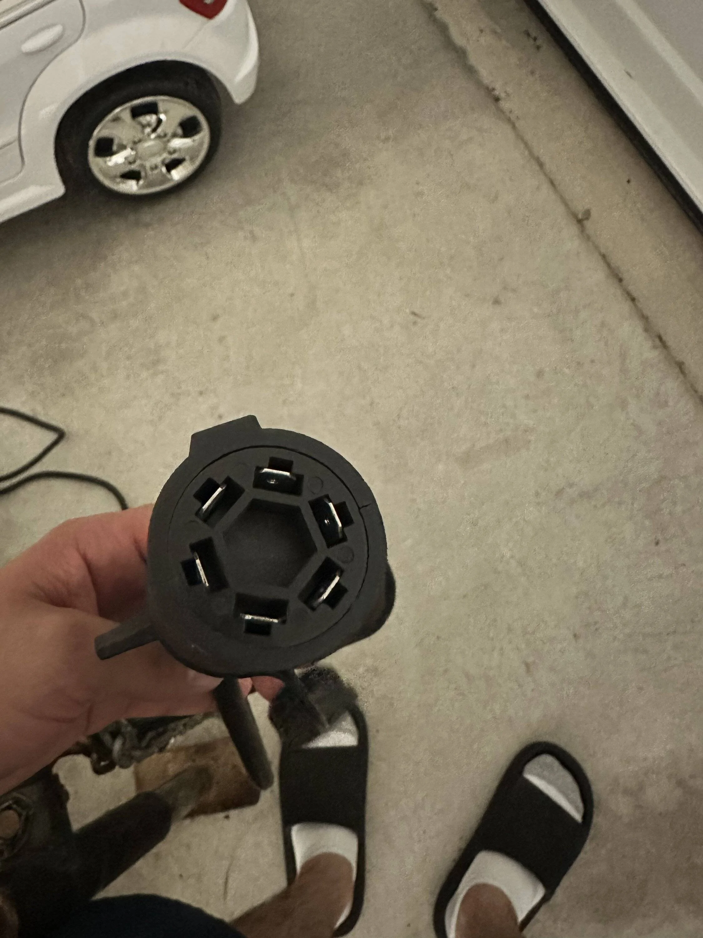

This is the adapter it is a 6 round to 7 blade. Would I need a different adapter for it to work with the JLU?
