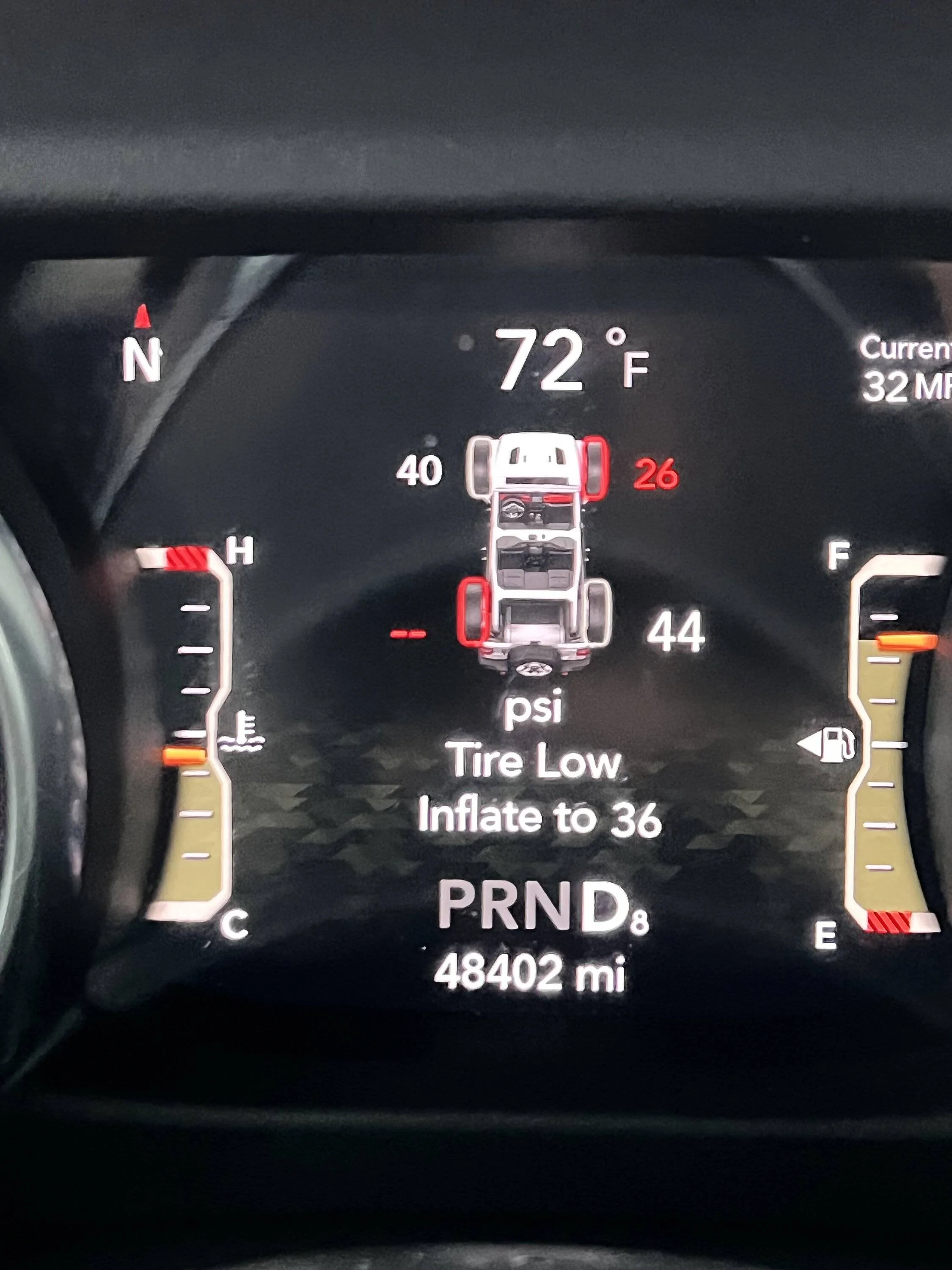

Ok,
So I have been reading and attempting everything from deflating the tires, disconnecting the battery, moving the tires to where the TPMS shows the tires... nothing so far.
The issue at hand is that one of my sensors is not reading into the system and shows as red on the display. I took it to the shop to get this sorted but they were never able to figure it out. A couple of hundred dollars down and no resolution, whatever. Then, I get a flat tire. TPMS display shows that the driver front is the one that is low/flat. I get out and look... it is the passenger rear... WTF.
I am not sure what to do or how to fix it. I have also swapped all of the TPMS sensors with OEM sensors and had them checked to ensure that they are able to read them with the scan tool and that they are on the correct frequency, all is well.... just not with the system on the jeep itself.
Has anyone had this issue?
It is bothering me on principle at this point due to the amount of time and money I have spent just trying to figure it out.

I was.
After swapping to new wheels and 35s I had whatever the tire shop had put in there.
after this didn’t work, I had them removed and then installed the sensors from my stocks.
here is a photo. The one that shows 26 psi is actually my driver rear. I have ascrew in it Abe need to patch it but I’m about to get new tires as I have too many patches as it is and I hate the road noise from these Nitto MTs and want to swap to an AT or Hybrid is quieter.

it currently picks them up, just in the wrong locations. Except one. It doesn’t pick it up at all

with that said, any ideait would identify mine in the wrong locations?
I’ve driven a couple thousand miles like this

I have the same issue with both the aftermarket and oem sensors. It reads 3 of them but all are displayed in the incorrect location
