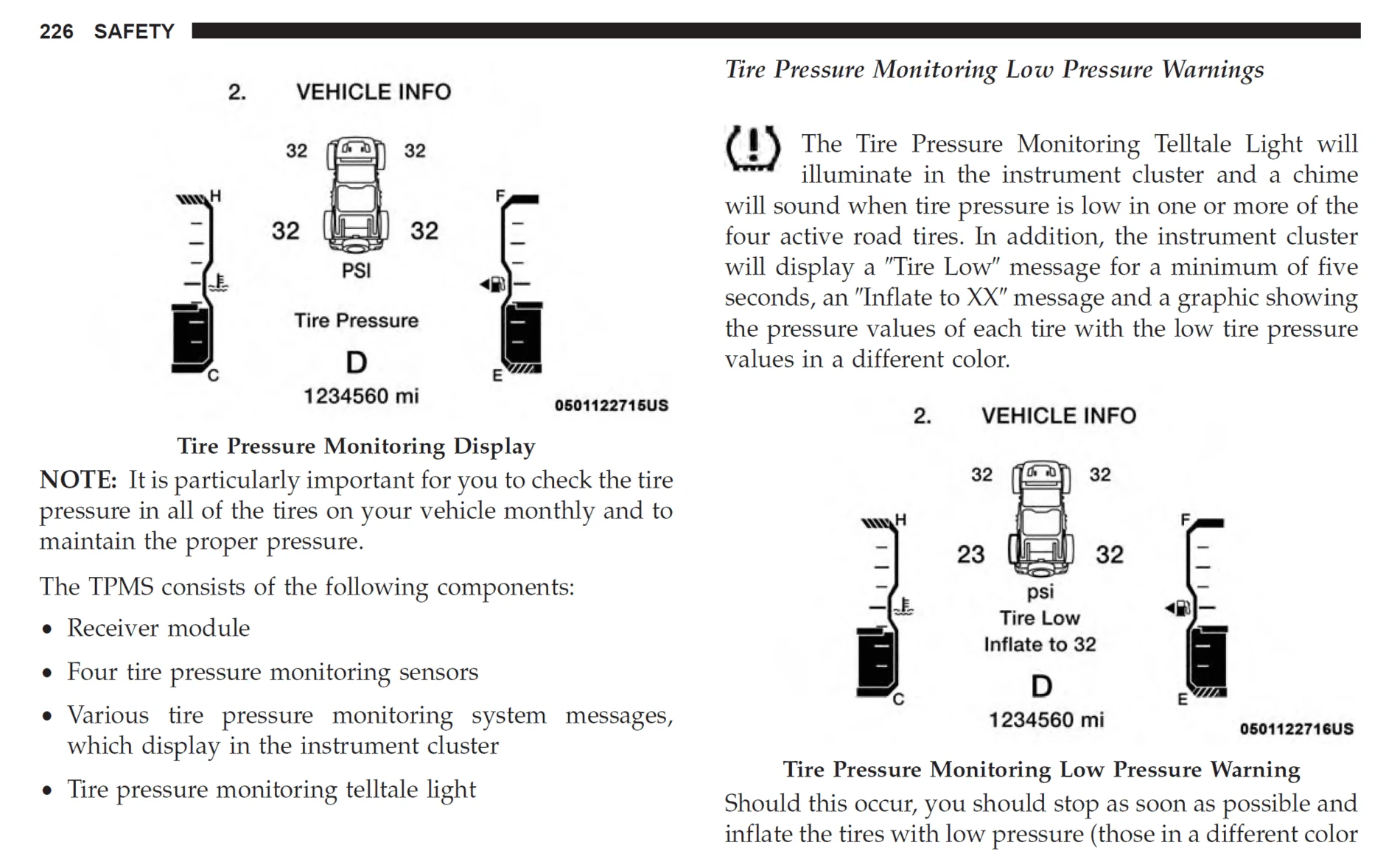

How does the JL/JLU know which tire/rim/wheel is where .....
Well, there are 3 sensors on the chassis that monitor the 4 TPMS Sensors found on the 4 tire (rim) positions.
Info from the 3 chassis sensors is transmitted to the Wireless Control Module. There is no need for a 4th chassis sensor as the computer uses the process of elimination to determine the fourth tire location.
Yes, your JLU/JL knows exactly which rim is where, within seconds of a tire rotation for example.
There is a TPMS sensor in the factory mounted spare but it is not read by a chassis sensor/ considered by the computer until it is placed in one of the 4 tire positions.
