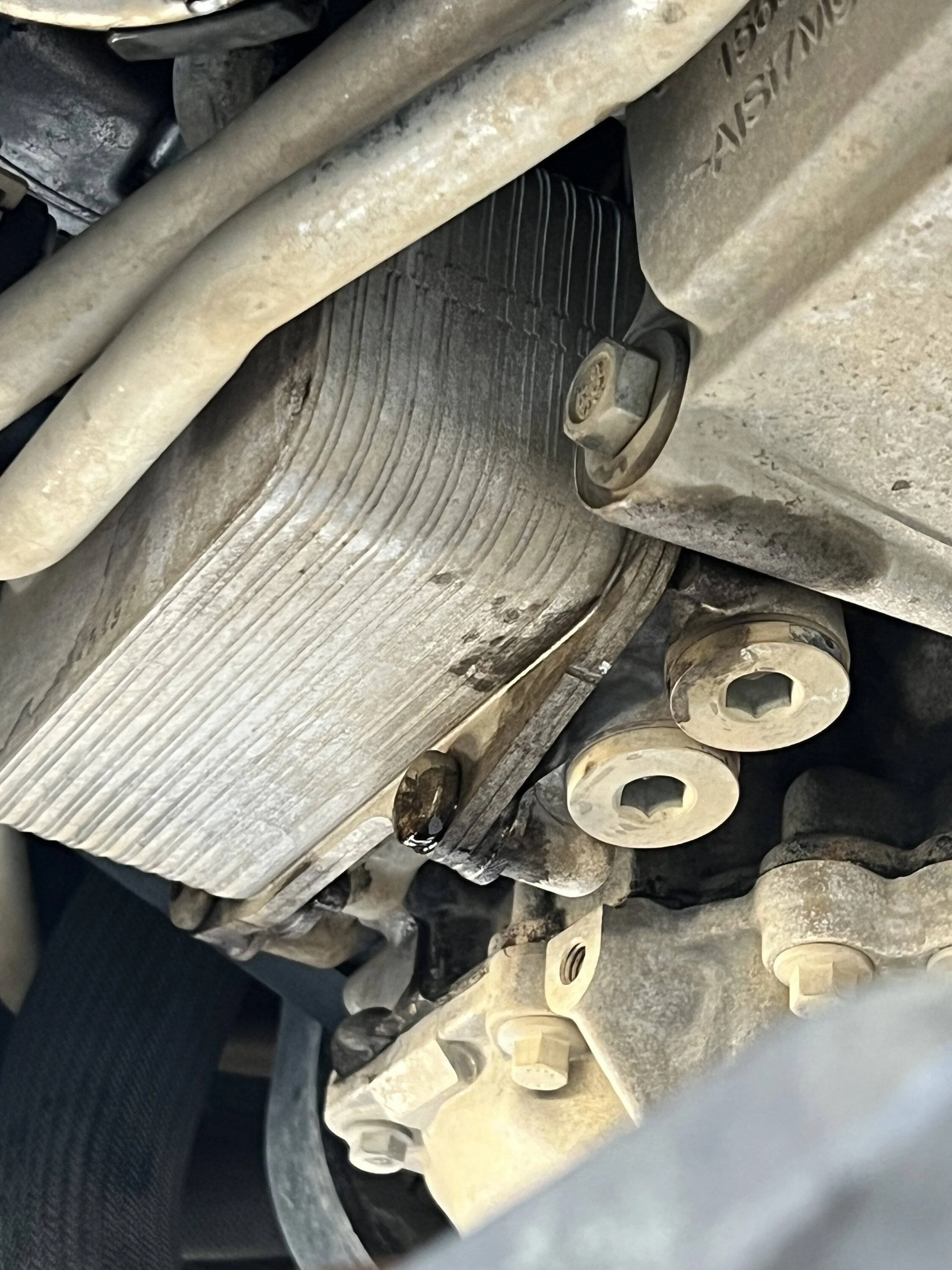

Well, I definitely have an oil leak.
Degreased and cleaned all surfaces, dried and then took a trip.
I think it’s the dreaded diesel timing chain cover leak.
