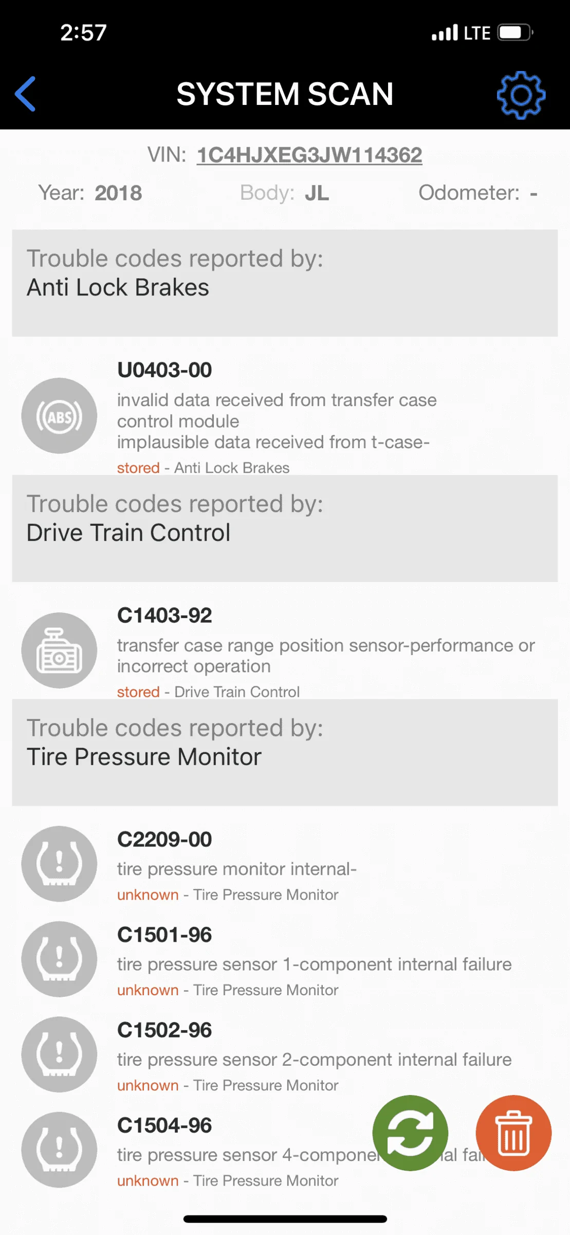

Was playing with tire sizes in my Jscan app in order to dial-in my new 315/70 tires. after a few tire size trials, I wanted to correct it one last time.
But I got distracted and opened the door before the requested 5 minutes. Thought that the worst case that could happen was that the new set tire diameter wouln’t register, but no….. drove a few feet and got the ā€˜ā€™service 4wd’’ message. Stopped and used the app to erase the code, properly re-did the tire size. Drove a few feet and that message came back. Erased it again, drove a few feet and it’s back. Any clue what the problem is ?
these are the codes…

Do a factory restore to factory settings and try adjusting tire size again.

Yeah ok, at this point I’ll try anything. I also messaged Jscan and waiting for input.

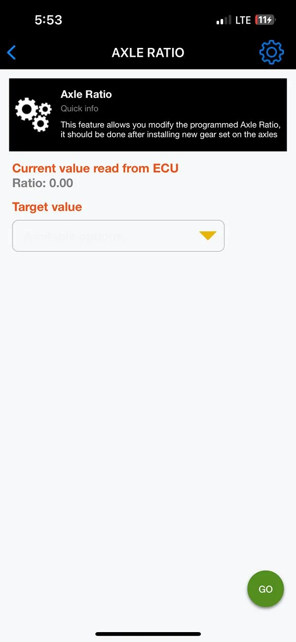

Alright guys, for futur reference on this subject, I have found the culprit.
Just as I was getting ready to return my Jeep back to stock, I decided to investigate further. Although I never touched it, my ECU had stored my axle gearing as 0.19 !?!?
I erased the error codes and corrected the axle gearing and all is well.
Seems like the fact that I opened the Jeep door before the required 5 minutes wait time after tire size setting, the ECU got all confused with misinformation.

Oh my thank God I found this thread. I’m dealing with this issue right now so I went back into JScan and I just noticed that my axle ratio was set to 0.00 after changing my tire size. Strange! I’ve had this thing at the dealer for a total of almost 5 months this year for this issue! Service 4wd, sway bar, collision warnings. Hopefully it’ll be fixed now
Cool, glad I could help. That’s the beauty with forums and the people that keep them going.
