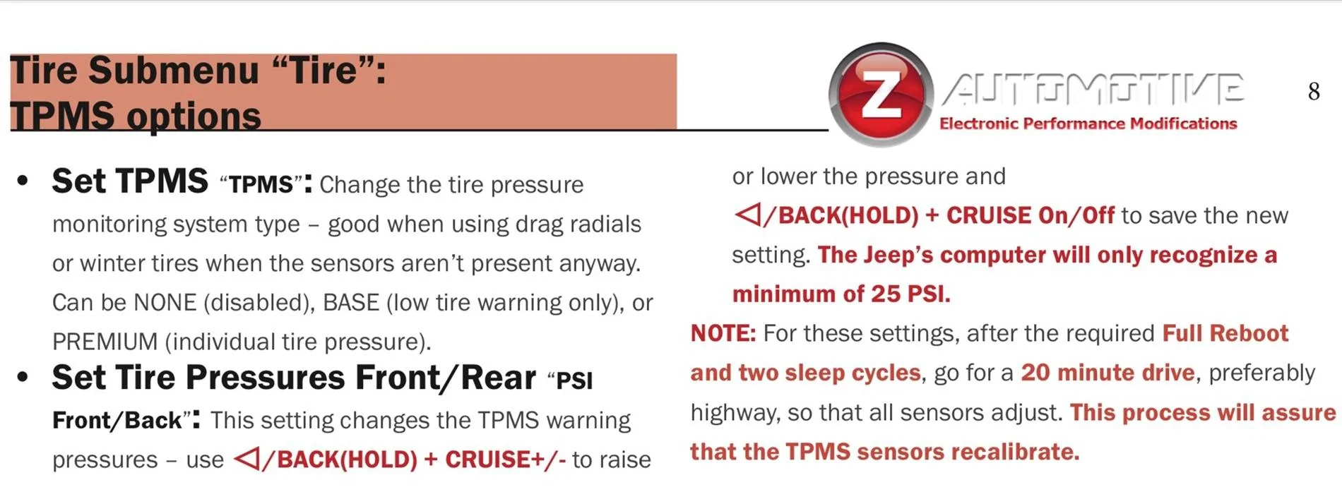

I got a tazer mainly to get rid of the FAD. But I also was able to lower the TPMS to I think 25 was the lowest.

Yes I just installed the Tazer a couple of days ago and you are correct 25 psi is the lowest.
ETA you can turn off TPMS reporting completely if you don’t use the tire sensors or don’t care to see tire pressure warnings.

Well I’ve only had the Tazer for a few days so I’m not 100% but when I lowered my threshold I couldn’t get it below 25psi
edited
Jeep Wrangler JL How to lower the TPMS warning threshold IMG_2106
