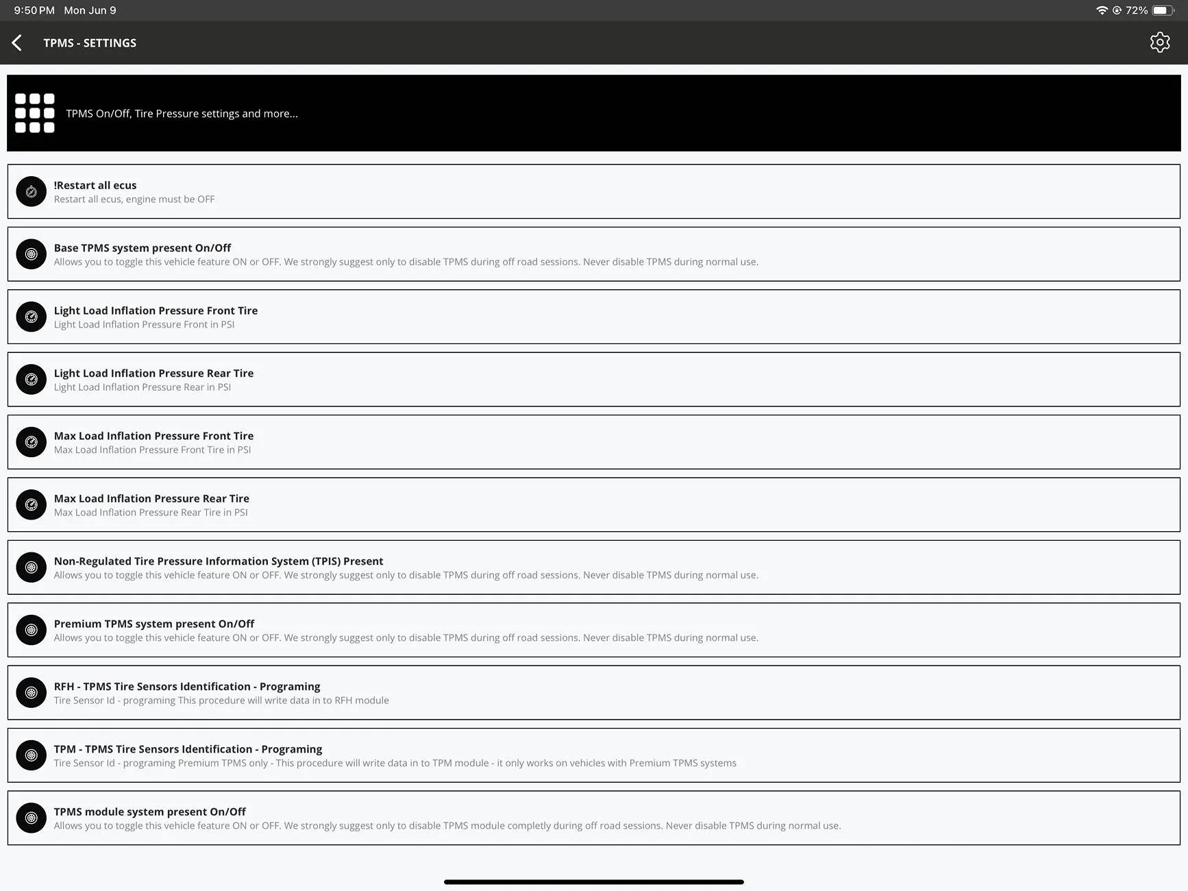

The JScan app has a number of program features that may or may not do anything with the Jeep TPM programs. As far as the pressure the app can set one psi increments between 20 and 30, as well as 15psi, 10psi, and 0psi, also higher values.

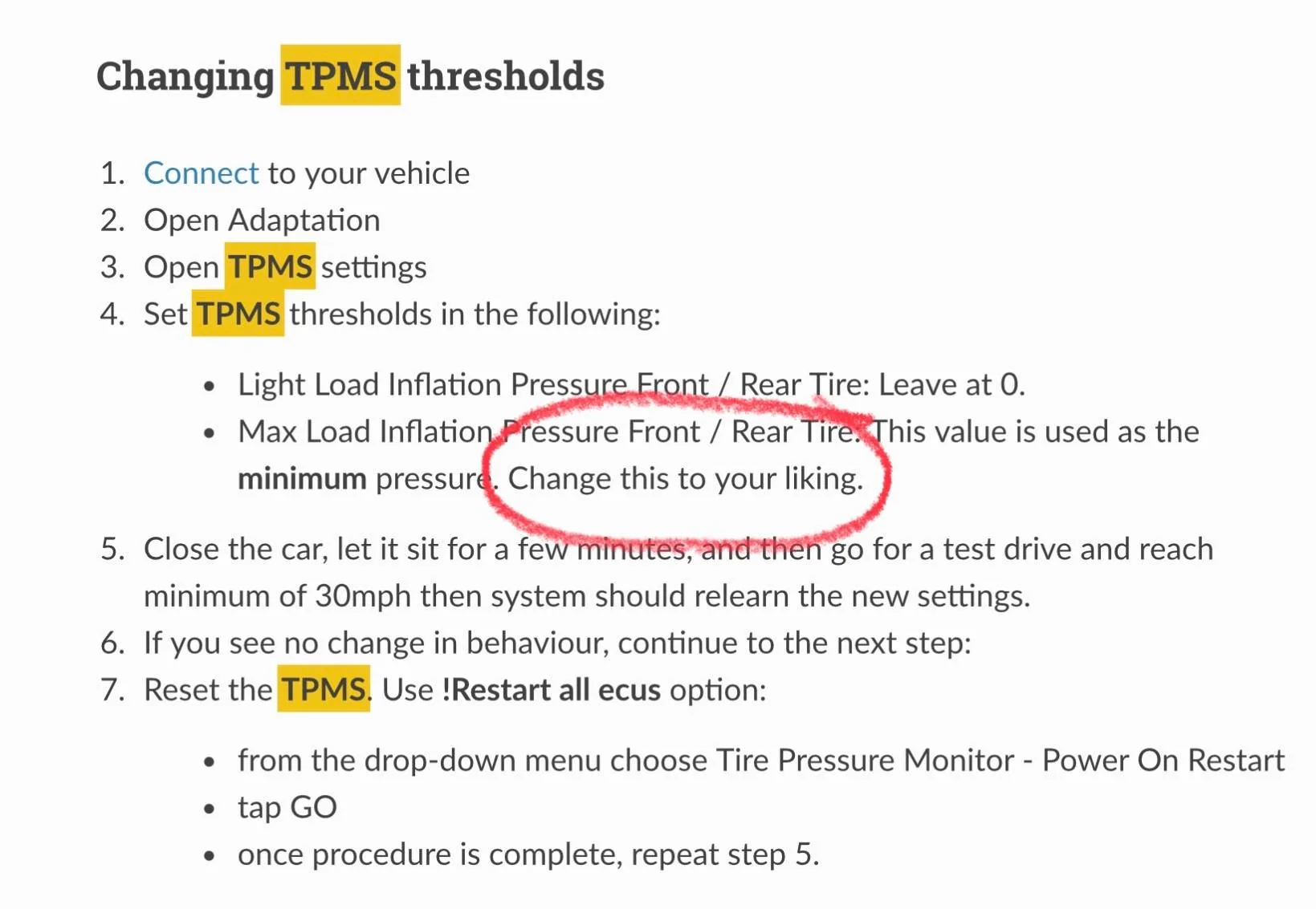

Does JSCAN say the same or different ? He claims 20 psi worked correctly with the warning at 19 šŸ¤·šŸ¼ā€ā™‚ļø
JSCAN says this but has also said other things that turned about to not work in the past. Maybe I’ll check it out this weekend.
