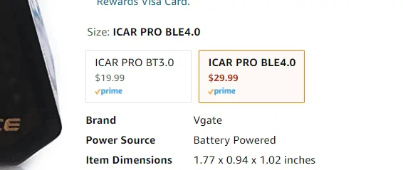

@JerseyMark Exactly what tools do I need to buy, to get the JSCAN?
The jscan website tells you the recommended adapters. You need two:
1. OBD II bluetooth adapter - Vgate iCar Pro LE is recommended - about $30
2. Chrysler security bypass cable - Autel chrysler 12+8 - about $40
there are pics and instructions on how to connect the adapter and cable on the jscan website
then download the app and follow the instructions
