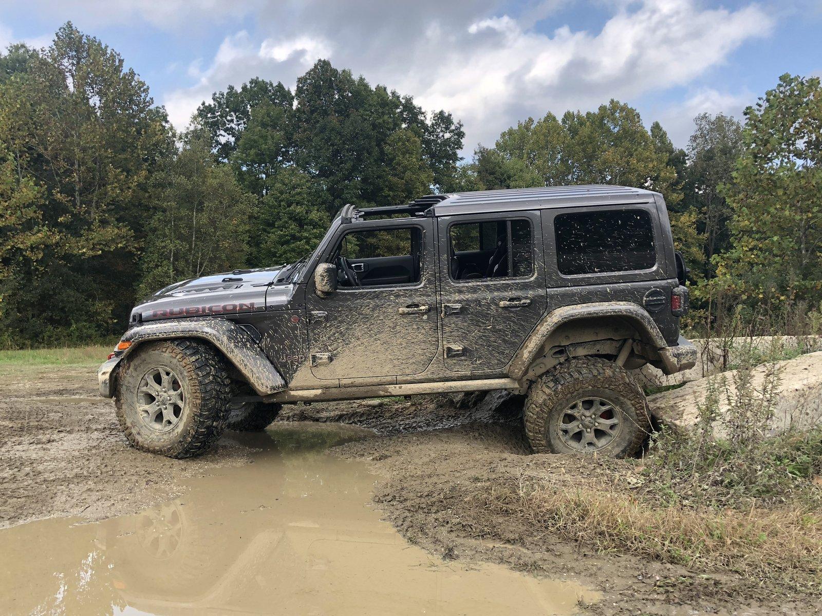

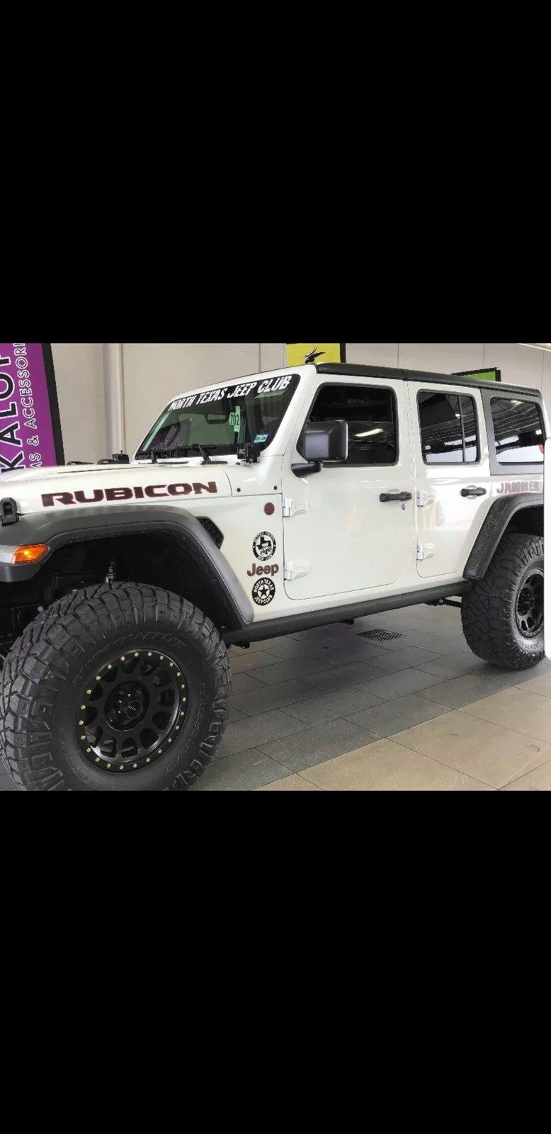

Mopar lift with 37s. No rubbing only had to use a heat gun in the rear fender to push the indentation back.Yes you can do that but I have the Mopar 2 inch lift kit which lift it 3 with 37's I would not do that now but I was going to but I'm so glad I didnt. I did the Mopar 2 with 37s it just doesn't look right without the lift kit with 37's in my opinion but anyody can do what they want. I really like the way mine looks and it rides like stock
Found that out the hard way. Ended up using a wire tie to pull it back until I got home. No big deal, but the sound it makes is freaking annoying...almost as bad as the jet engine fan. LOLYes if you're doing some serious off-roading you might want to push that in after you heat it with a heat gun just a little. Without the lift if you do some serious off-roading you're going to have more problems than that. I just like more wheel well then not
