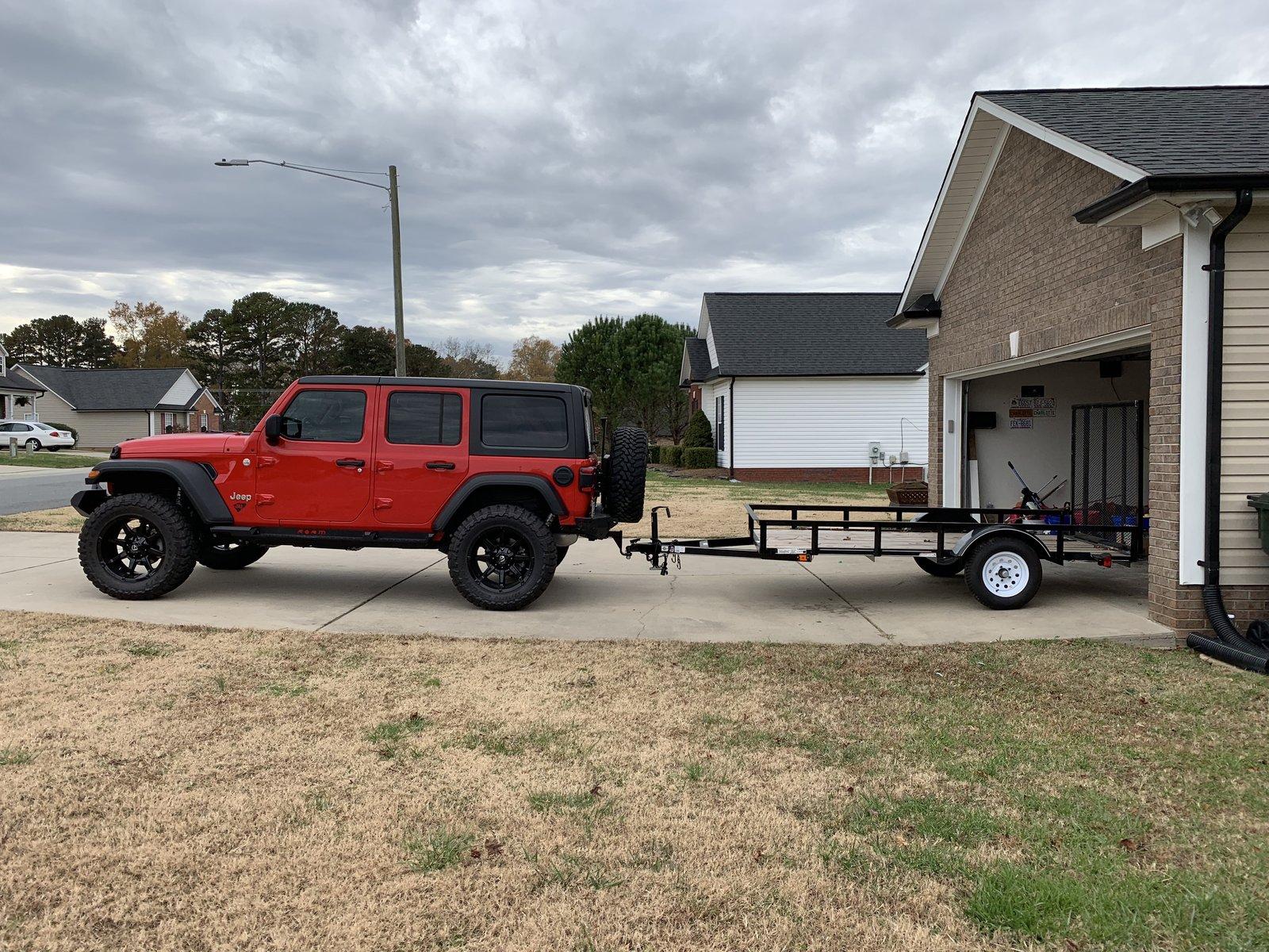

If you're lifted with bigger tires and you are running the spare you'll need a drop hitch, I am running the Mopar 2" lift and I have to run a 8" drop hitch to level out the trailer and a 10" drop would really do a better job. I also had to find one long enough to stick out past the spare otherwise you run the risk of the trailer tongue jack hitting your spare when you make turns. I also could use a set of longer trailer chains due to said extended hitch. In the pick below I was running a 6" drop which wasn't quite enough but was long enough to clear the spare.
Jeep Wrangler JL Towing a utility trailer 0IPTzLRHR0mHJxFLQffWo

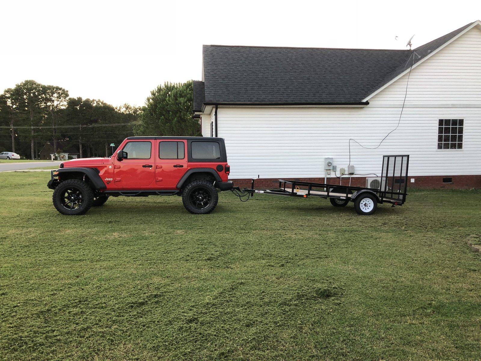

The pic below is with an 8" drop hitch but I need an longer one to clear the spare tire, you can see how close the jack is to the tire.
Jeep Wrangler JL Towing a utility trailer rhohrm1iRaet5yrl9IWZTQ

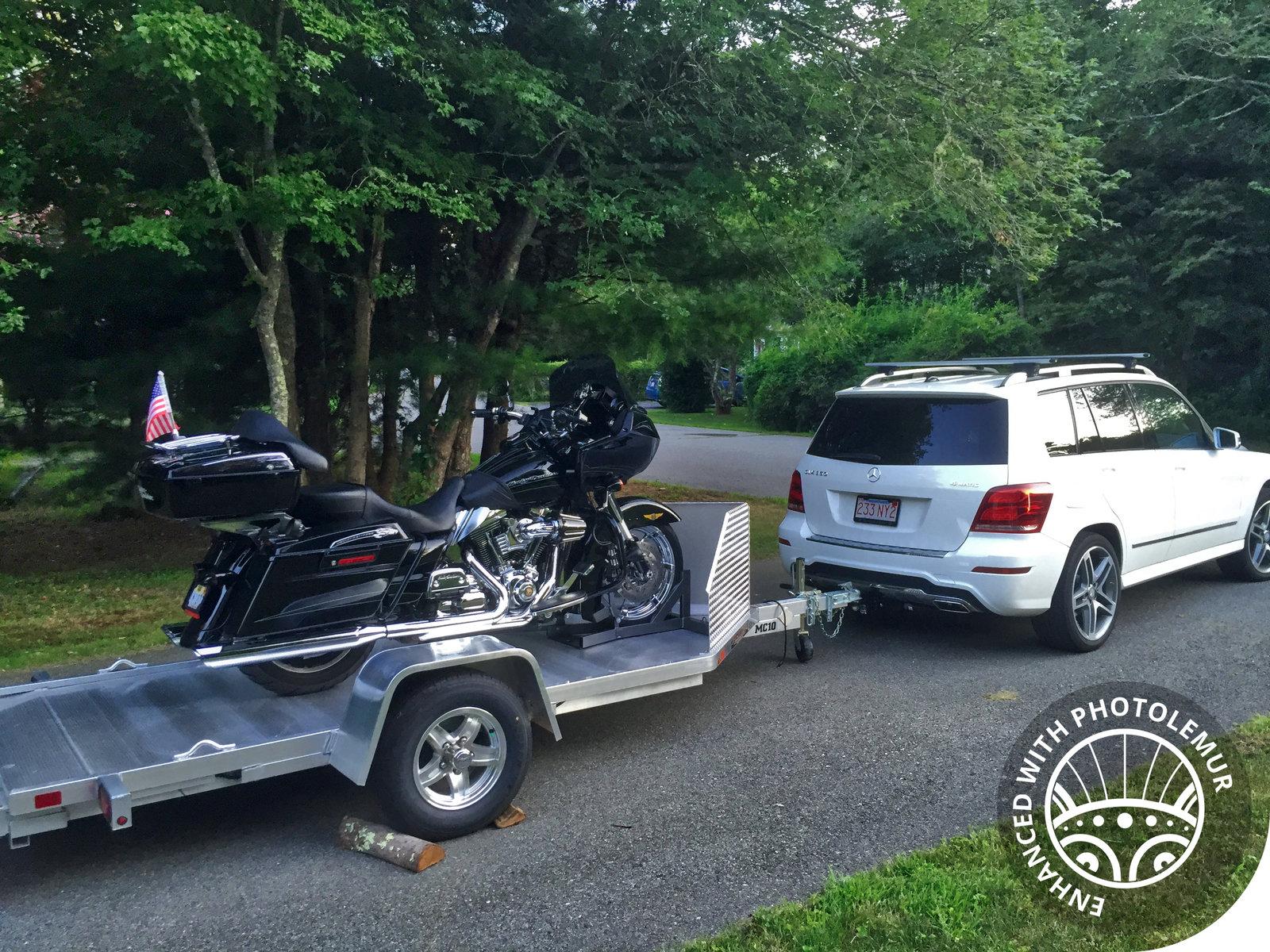

YES! The right trailer is important! Don't get one with small wheels if you plan on traveling across states. Wide stance, low to the ground is important. Here is one I use for long trips that take me through major cities. I'm in New England, so getting out of this area of the country is going through New York. Never fun on a bike.
