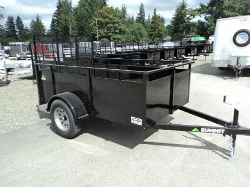

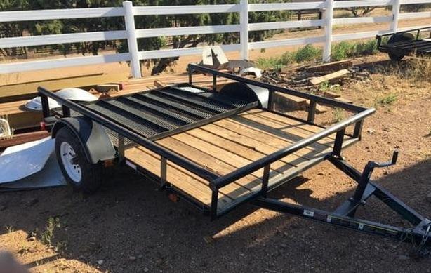

Trailers tend to be used for all kinds of things and sometimes borrowed to friends/family members that don't necessarily have the trailers weight limit restrictions in mind. They will throw the washer, dryer, fridge, etc all in one load and while that is fine for heavier trailers, it might just damage a smaller trailer. If I was going to purchase a trailer like the one that you want, I would be going for something that was going to last through some abuse.
If it's ever taken on dirt roads you may want a little bit more ground clearance and a wood floor so rocks/dirt/crap isn't thrown all over the bikes. Even on pavement you are going to have tons of stuff being thrown back on those bikes. It might be beneficial to look at something with a short wall that would protect the lower portion of the bikes or cover them all together. Also powder coated frame instead of painted in this case.
The one you are looking at ($900 with tax) is not that far off price wise from something considered a real trailer... something that doesn't have limitations of what roads/speed you should pull them on. The trailer you are looking at is roughly 400lbs and one that is a bit heavier duty would be roughly 700lbs. It would be stronger and be able to handle more weight/abuse. The start around $1200.
I would suggest something with a heavier duty axle (look up torsion vs leaf spring).. most likely in the 3500lbs range. Look for a heavy duty wind jack (2000lbs), wires protected through conduit (not exposed), 15" wheels/tires min, DOT lighting, treated wood on the floor. Solid sidewalls or rails 16-20" high so you can build your own walls.
Examples of sidewalls version:
Jeep Wrangler JL Towing a utility trailer Trailer4
Jeep Wrangler JL Towing a utility trailer Trailer2
Jeep Wrangler JL Towing a utility trailer Trailer3

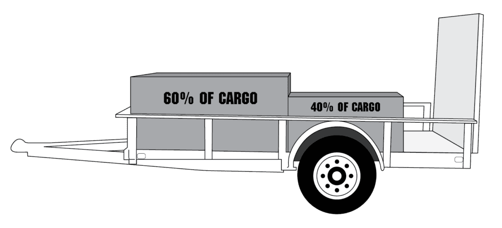

Load the trailer properly 60/40. This is even important when carrying light loads.
Not for nothing but that diagram shows 80% of the load in front of the axle.
