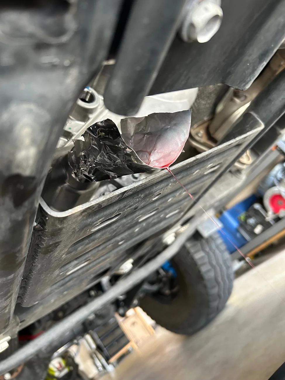

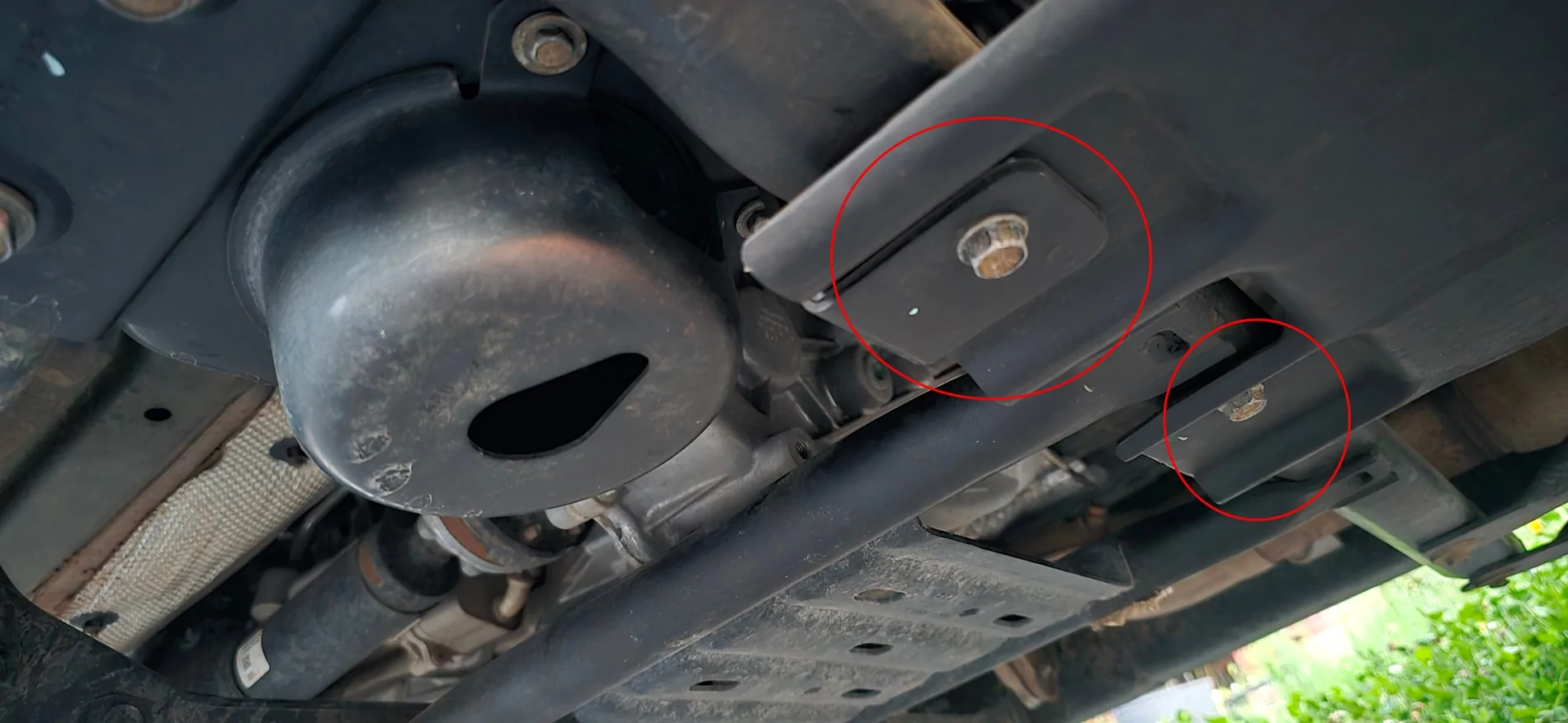

Hey folks, definitely tried the search function and the specs I came across can't be right (48 ft-lbs) for these on my JLUD? My digital torque wrench is showing about 20 ft-lbs on these currently and they are SNUG.
Also wondering, I'm going down this rabbit hole before changing the TC fluid, can I get away with leaving this skid plate on if I have my funnel / pan game in order? The drain & fill plugs both have a green line marker, should I try and re-align or try and get the torque wrench in there?

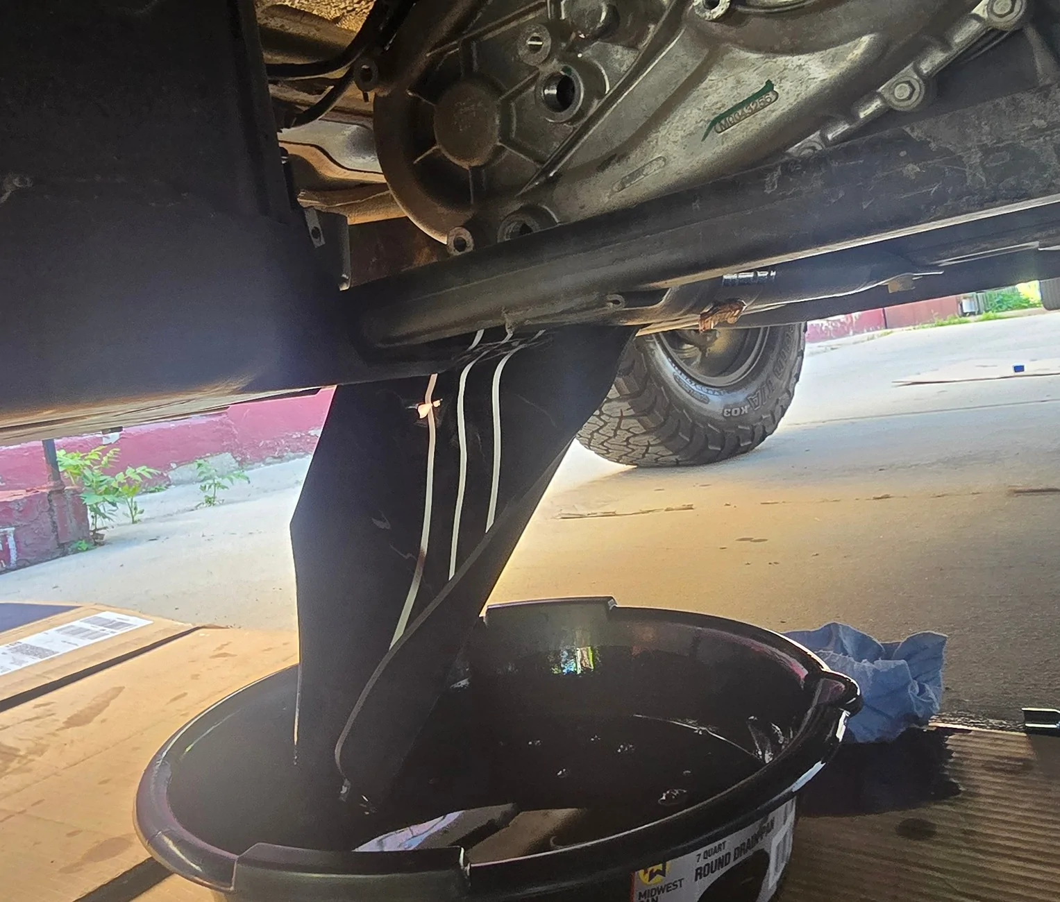

you can drain and refill without removing the skid. use some kitchen AL foil to create a catch basin of sorts or use something like create-a-funnel.
About the T-Case skid bolts, mine looks a little diff than yours, at least in the service manual and those bolts that goes on the cross member have a spec of 15 ft-lbs. the other side that goes to frame is spec-ed to 55 ft-lbs

I did the same aluminum foil trick on top of the skid plate too. Just wrap it around a small block of wood on the front side of the skid plate so it creates a slope to the drain pan on the back side. So much easier than dropping the skid plate.
