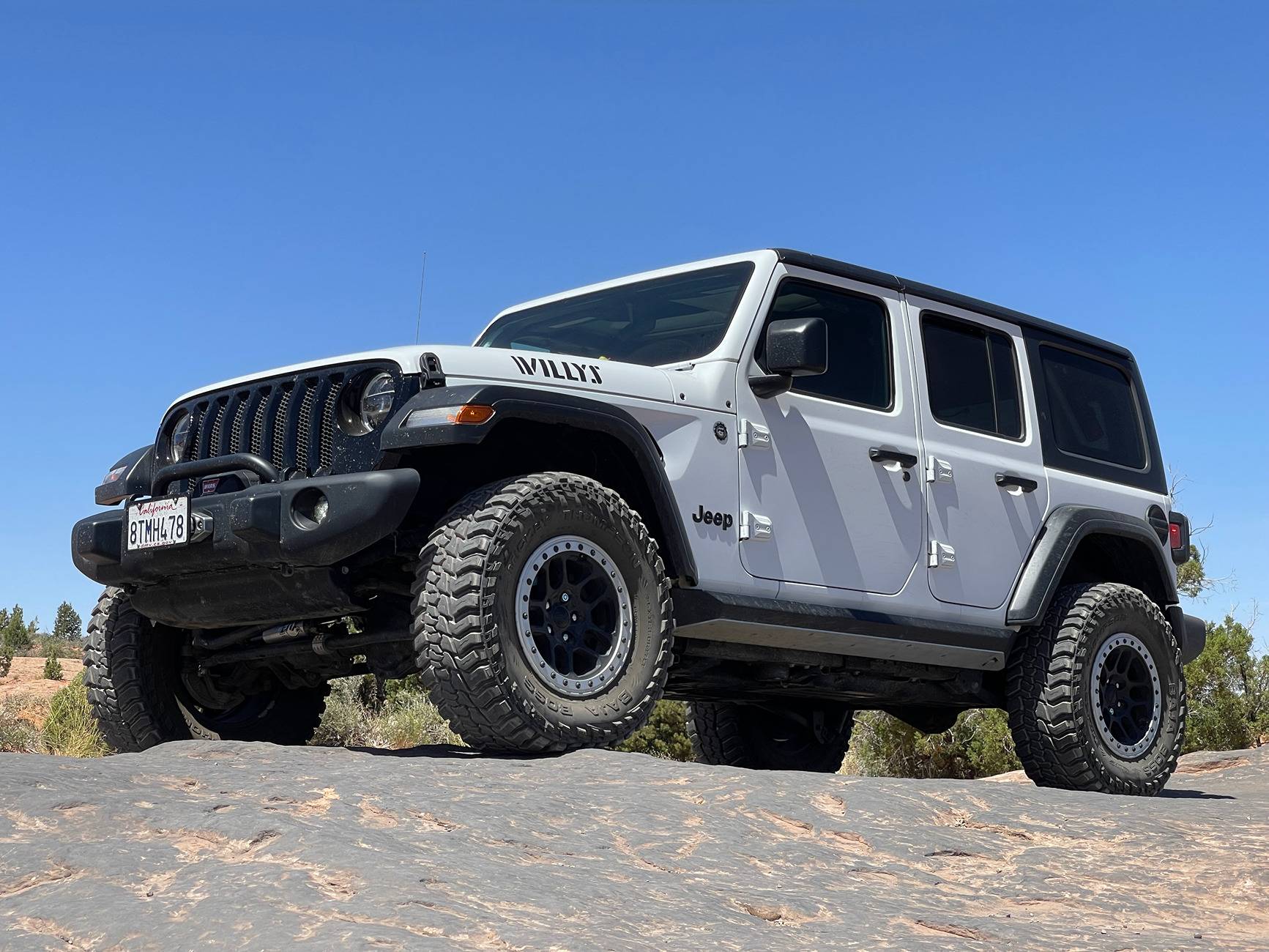

35/12.5 Mickey Baja Boss MTs rubbed a very tiny bit at full lock with the Mopar lift.
Load Range D, and very smooth and surprisingly quiet running.
but you could either put a stack of washers underneath the steering stops to minimize that, or just not turn that hard. ;)
I'm curious where they rubbed?

rubbing i had with 35s was very lightly on the Lower Control Arms, and only at full lock.

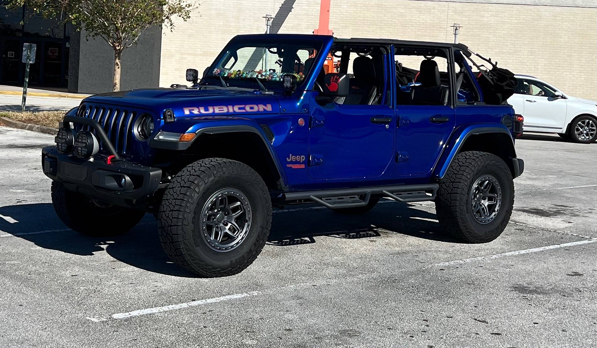

Hey almost neighbor…just seeing this post…I know I have a JLUR but I have only a 2” Rancho Lift running with Falken Wildpeak A/T3W 315/70 R17 (C rated) and ABSOLUTELY love them in the rain here in FL!!! I run 34 psi
