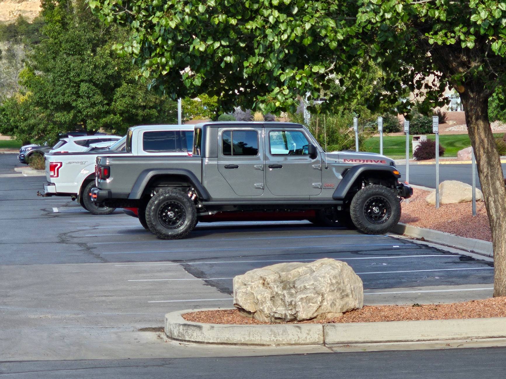

Here is my wife's JT Mojave with a Mopar lift and Nitto Trail Grappler 295/75R-17 tires (~ 34" tires). I think it looks fine.
Jeep Wrangler JL Tire Size Recommendataion 20230916_175634

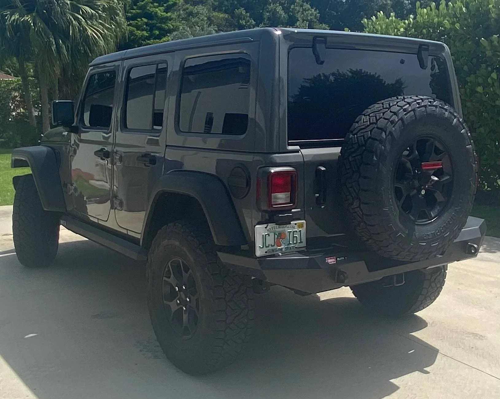

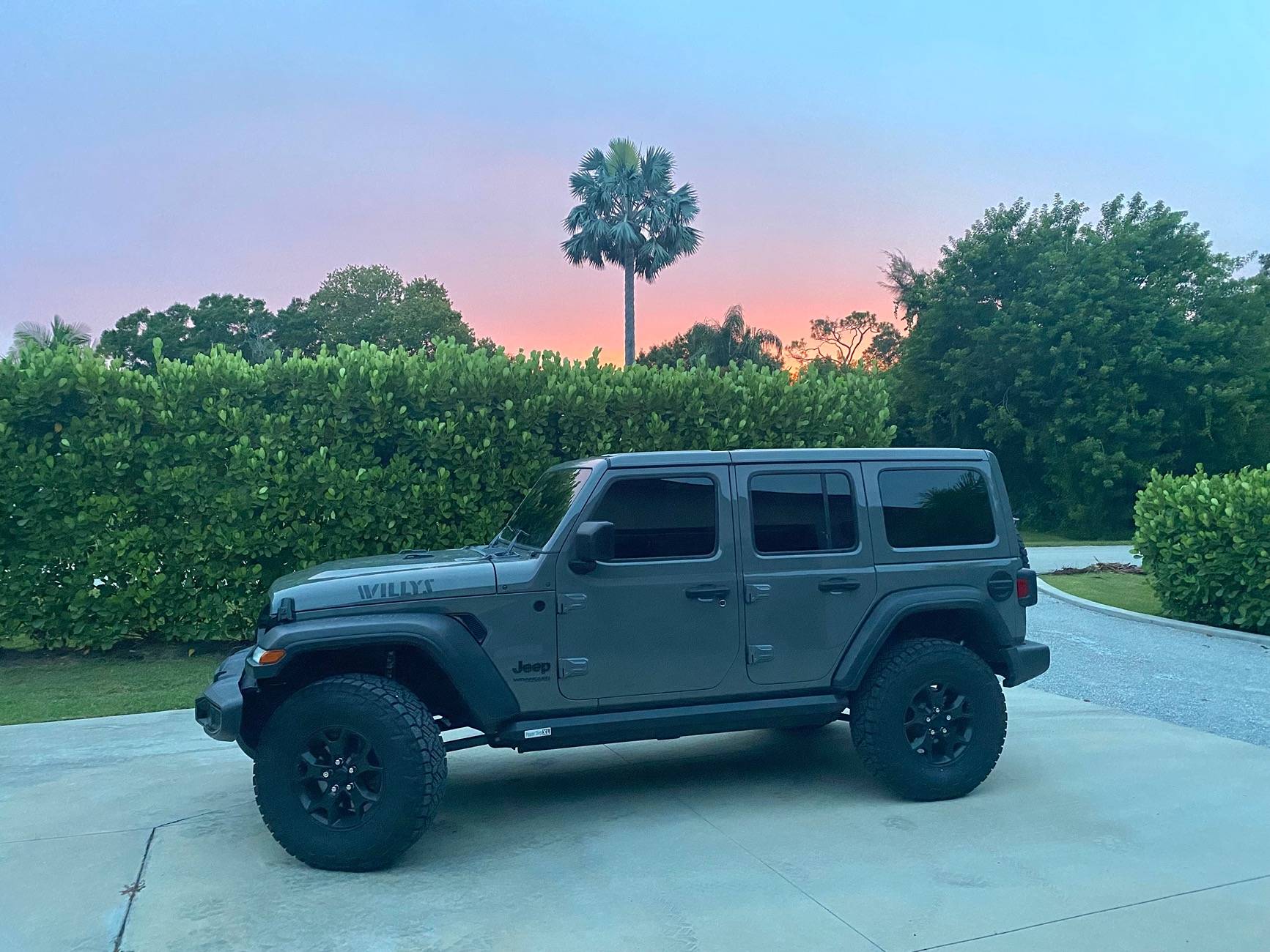

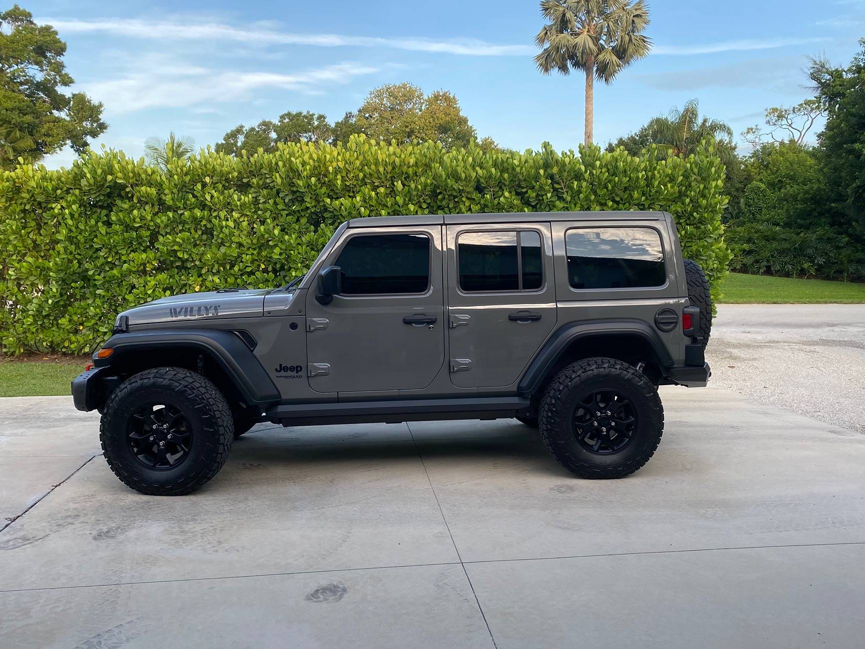

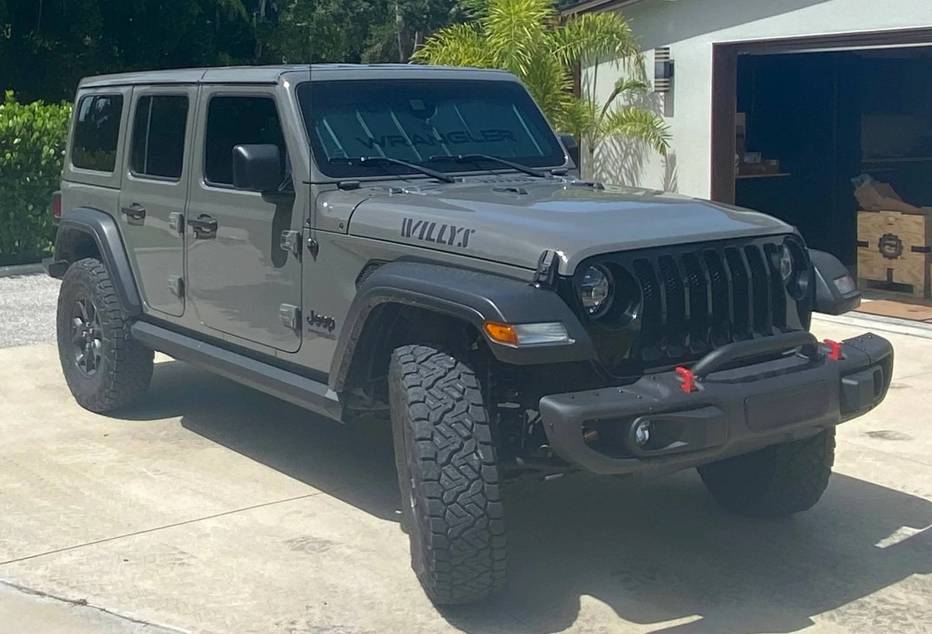

Here is my 2021 Willys on the Mopar 2” lift with 35 x 11.5 on the stock rims.
Tires are Nitto Recon Grappler in 35x11.5 r17 on stock rims. They are Load C. No rubbing / no issues. I really like them. Smooth and quiet compared to the Destination Mud Terrains that came on my JLUW
Jeep Wrangler JL Tire Size Recommendataion IMG_1748
Jeep Wrangler JL Tire Size Recommendataion IMG_1754
Jeep Wrangler JL Tire Size Recommendataion IMG_1755
Jeep Wrangler JL Tire Size Recommendataion IMG_1761
