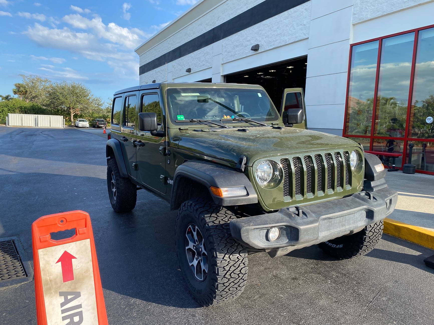

Yeah, I think I’m getting a little rub at full lock somewhere. The sport bumper panels are gone, I’ll check the LCAs.
Picture below are the KO3s, they put the KO2s I ordered on this morning, looks the same but not KO3s.
