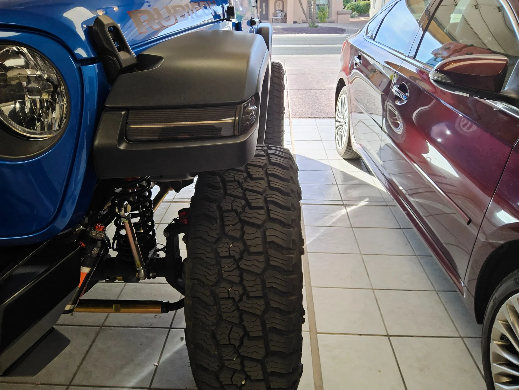

I am running Mickey Bajas 315-70-17s on Method 106 Beadlocks with no problems on my 23 Wrangler Rubi 2 Dr.
Jeep Wrangler JL Tire size? 20241208_145845
