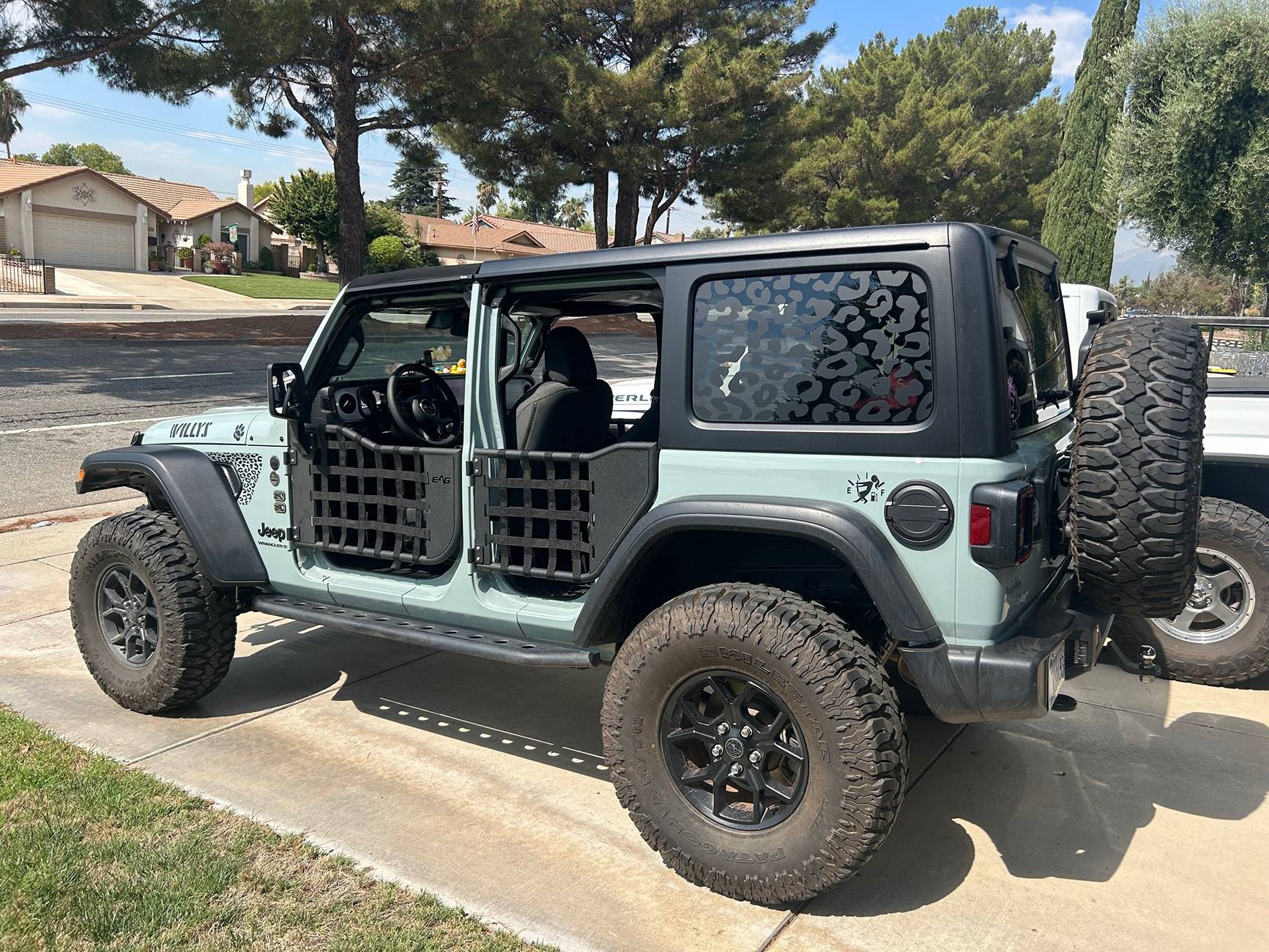

I believe if you go up to a 295 or larger tire, you start getting into that area of making additional adjustments for shift points and the likes.
has nothing to do with tire width and everything to do with height. A 255/85r17 is a 34” tire but much skinnier than a 295.
And the question about will this tire fit on a stock rim, the answer is yes. I run 37s on stock rims on my wife’s JLU Willy’s.
Jeep Wrangler JL Tire size question for base Wrangler IMG_7898
