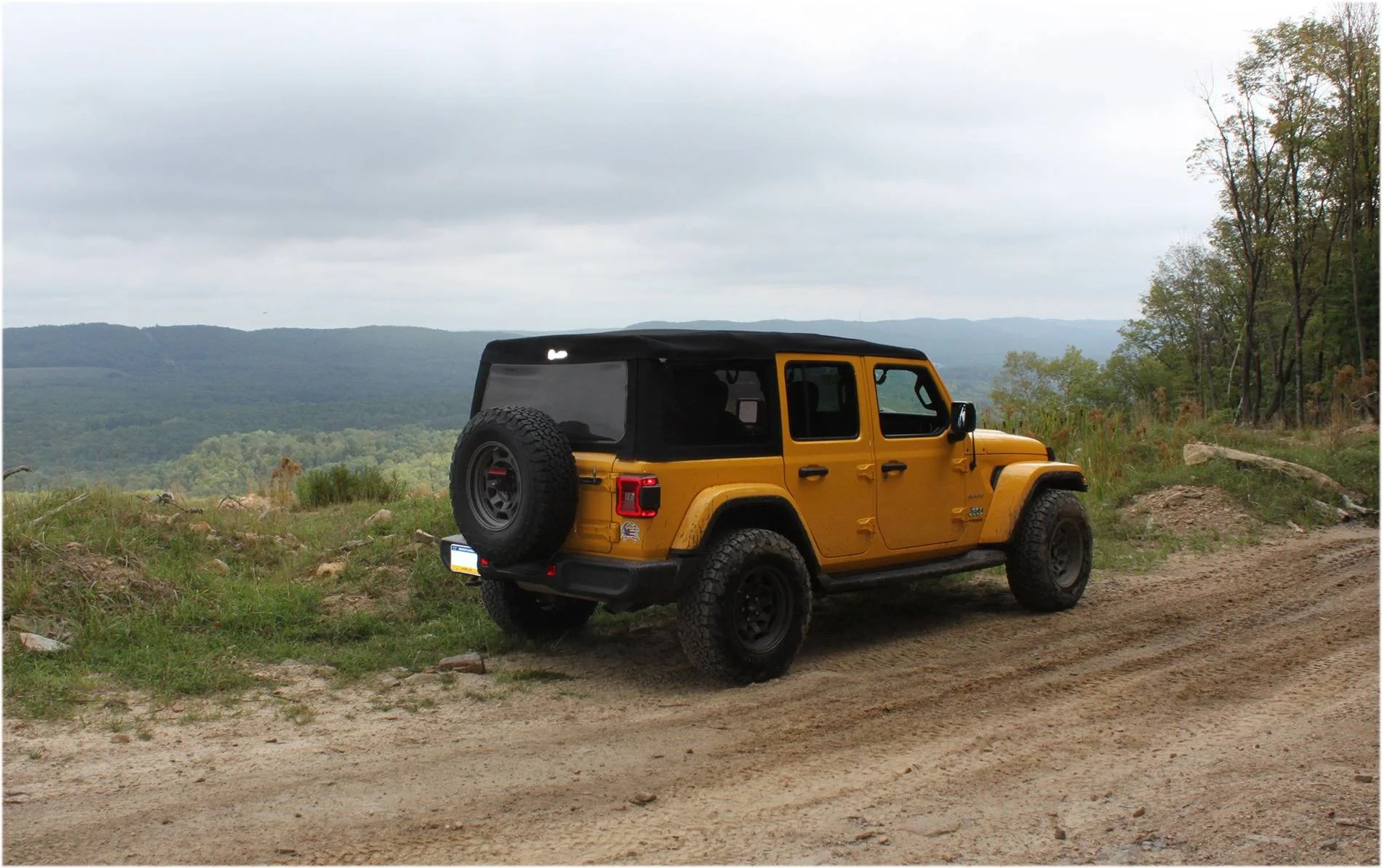

Jeep Wrangler JL Tire size question for base Wrangler scenic
285/70/17 BFG KO2's on Rocktrix RT117's with a -12 mm offset. In essence, that's a 33 inch tire. There is no rub while turning, nor off road. No hit to MPG. Still see all the gears on the highway. Honestly, this was a very nice upgrade for our JLU.
Same here on the tire size without any issue.
