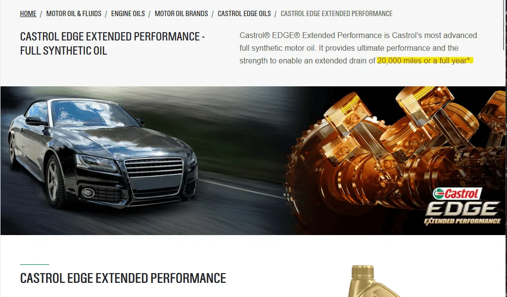

I have the 20 Sport 2.0 JLU. It's just about time to change my oil. I've been running full synthetic. I saw one the other day at Walmart, (Castrol edge 5w-30) that claims is good for 20k miles!! They also had the oil filter too, (Fram xg10060), which also says it's good for 20k miles.
Does anybody trust this?

It's all wishful thinking and I'll tell you why.
Jeep Wrangler JL Time for an oil change.. 1666270200389
Jeep Wrangler JL Time for an oil change.. 1666270240676
MOISTURE. Water turns motor oil acidic.
If you're putting in excess of 20,000 miles on your vehicle in a year, most any high quality synthetic could be extended out that long. That's a lot of freeway miles, high speed, constant and consistent heat. Lots of "on" time. Keeping that oil free from moisture. At that point you're mostly fighting shear, degradation of viscosity -- the additives in the oil literally wearing out. "Mechanical breakdown" of the oil.
You put 5k miles on in a year? 10k? Lots of shorter trips. That's a lot of "off" time. Lots of time for condensation to build up inside your engine as it cools down, especially during the colder months. This is degradation due to chemical reactions, more than the oil just being worn out from being scraped off cylinder walls, and crushed in bearing journals as simplistic as that sounds.
20,000 miles, or one year. Whichever comes first. Because the oil is being degraded even when your engine is off, if not more so.
Look up the oil change interval for a semi truck, 10k, 25k, 40k miles. On dino-juice Rotella or Chevron Delo. Yes their oil capacity is measured in gallons, but they also put down more miles than any of us will in our cars, the moisture build-up isn't so much an issue. Mechanical wear of the oil is fought by having five gallons do the job of five quarts in a smaller engine.

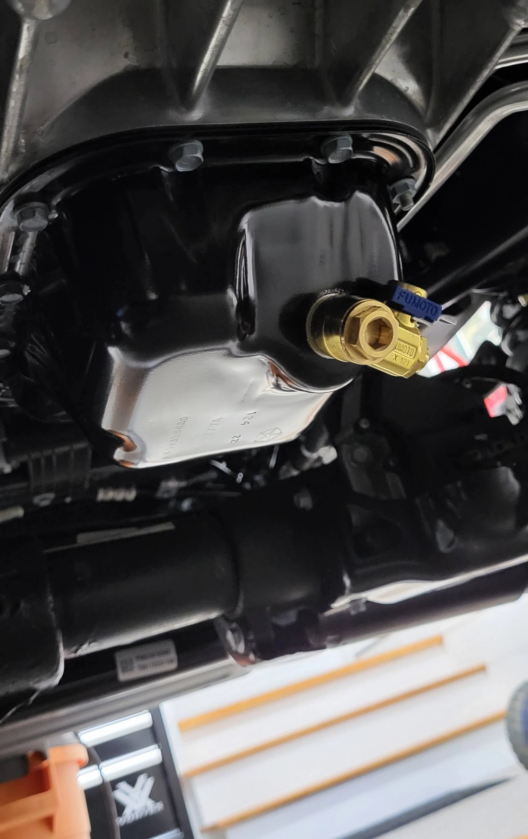

Also, it’s stupid easy to replace the oil filter since it drops in from the top. ??????
Ahhh YES!!! I love this part! Plus, I Just installed the Fumoto valve! I'll just now drain directly into a container to take to the recyclers. Clean-up just got easier!
LOL!!!! I sooo need this. I change mine in the driveway so I gotta put up some handmade “Shield” to stop the wind from blowing the oil around when it’s coming out in the smallest stream (when it’s about empty). Lol….I try my hardest not to change it on really windy days ?
Where’d you get that valve??? ? It looks brillant!
