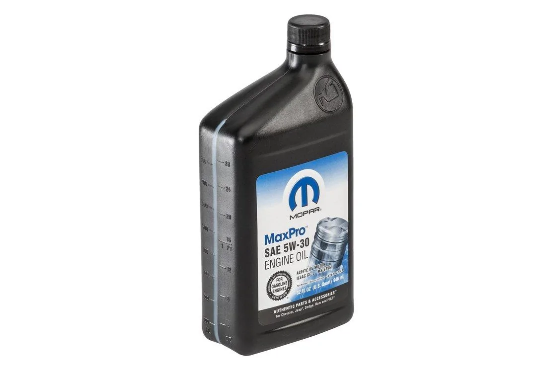

2.0l oil change kit
2.0l oil change kit

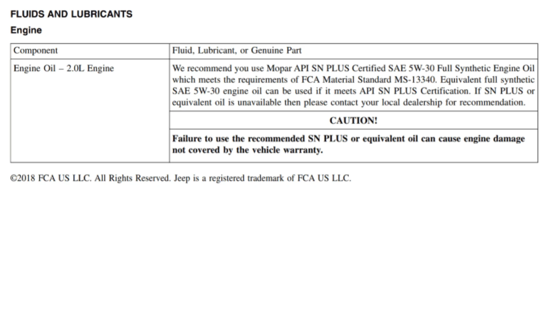

It’s a full synthetic.What engine oil on 2.0L from factory?
Synthetic or blend?
Thanks.

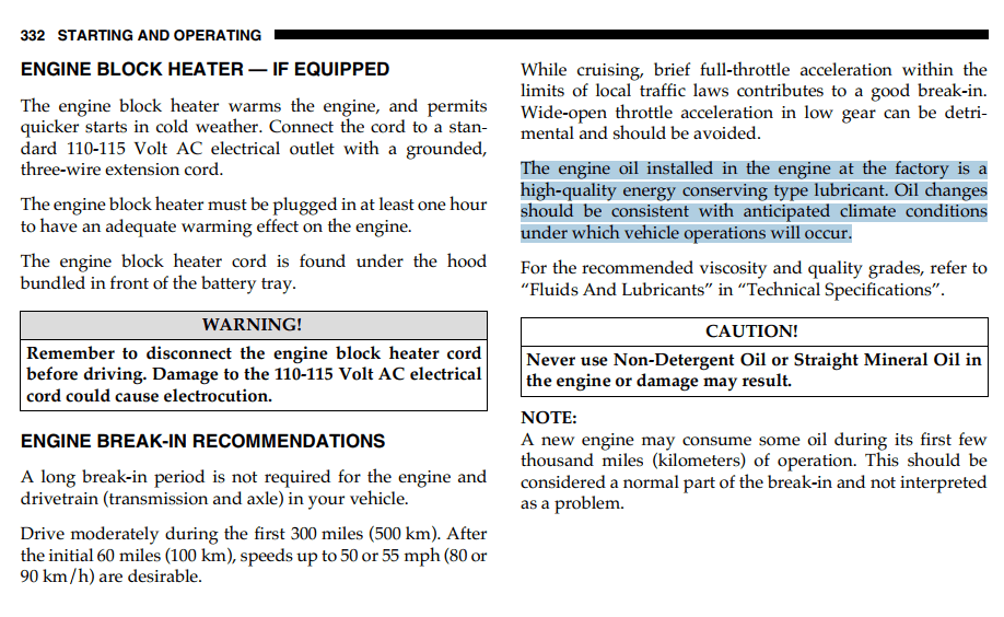

The factory oil was said to likely be Pennzoil Platinum 5W30Actually my question was specifically on the oil put in by factory on the 2.0Ls.
Would this oil highlighted below is probably synthetic too?

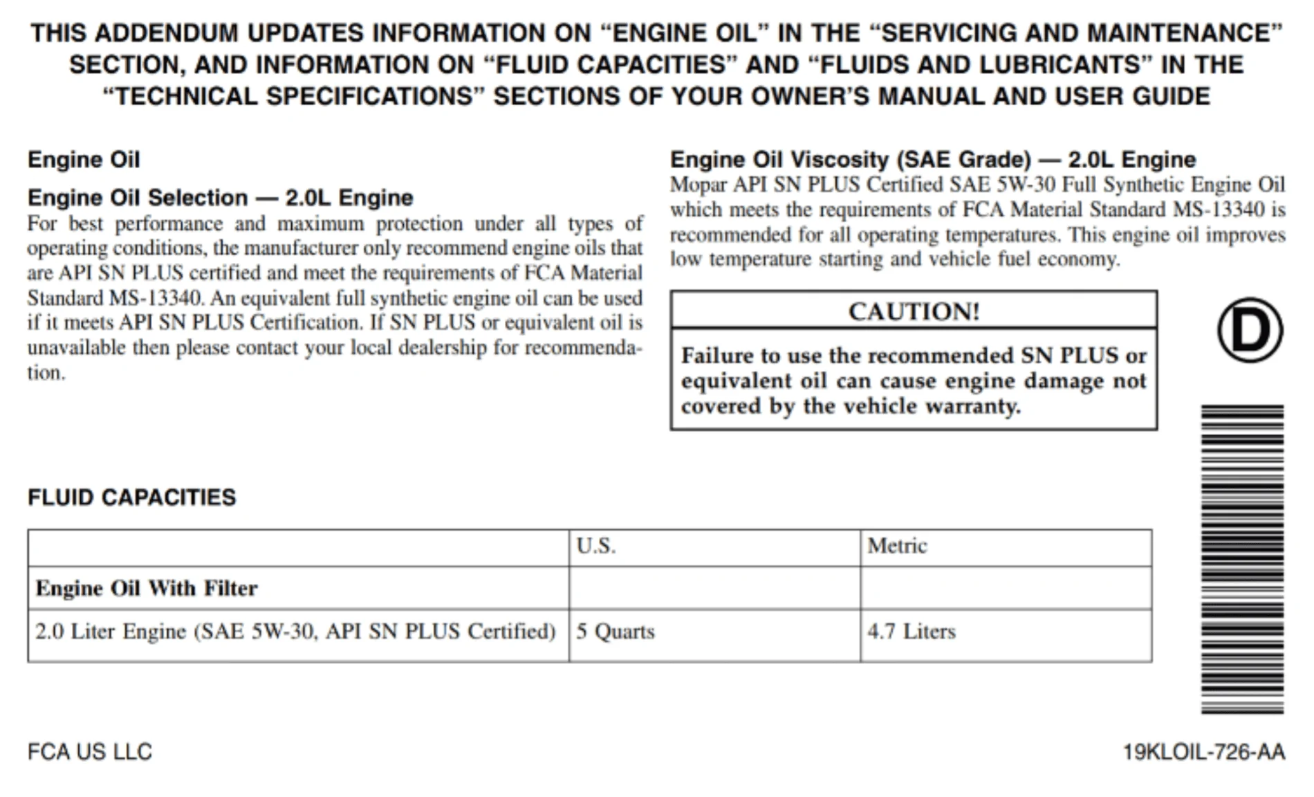

Interesting Amsoil has no recommended products for this engine. I assume because they don't contain the Chrysler designation everyone speaks about.I do all of the oil changes on all of our vehicles. I plan to change the factory oil on our new 20 JLR at about 1000 miles. Not because I think the factory uses bad oil, but because the initial fill washes out any small particals or debris from the manufacturing process. Back in the day, it was called break-in oil. I know they say this no longer necessary, but I will do it anyway for peace of mind.
I use Amsoil Signature series oil and Amsoil filters on everything we own, and this will be no different.
Awesome, thank you.The factory oil was said to likely be Pennzoil Platinum 5W30
SN+ is what is needed by Jeep and the Amsoil Signature is. It’s more than qualified to run in these engines.Interesting Amsoil has no recommended products for this engine. I assume because they don't contain the Chrysler designation everyone speaks about.
