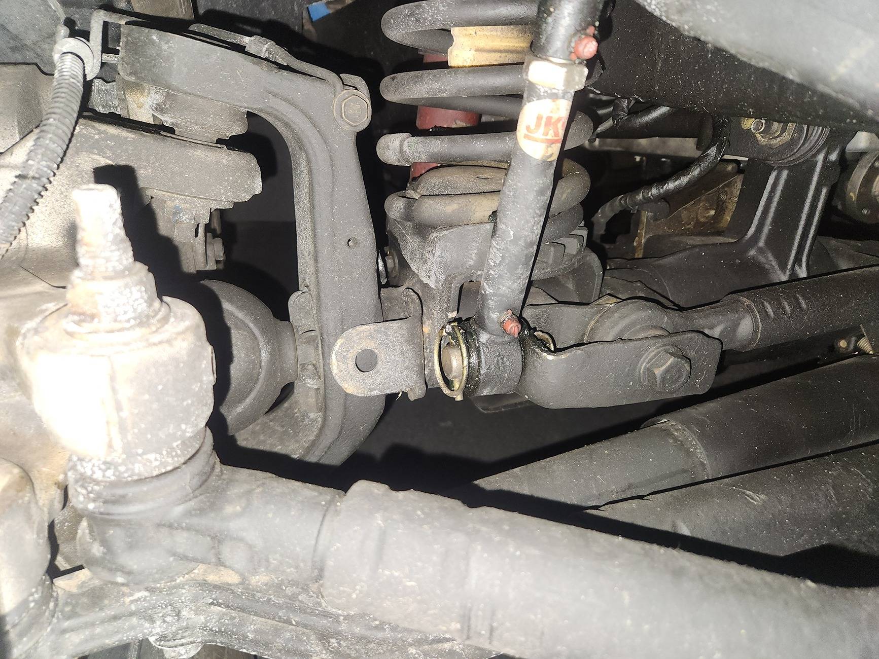

I used heat and beat that tab with a hammer to be parallel to the axle. If I ever need it back, I can bend it back.

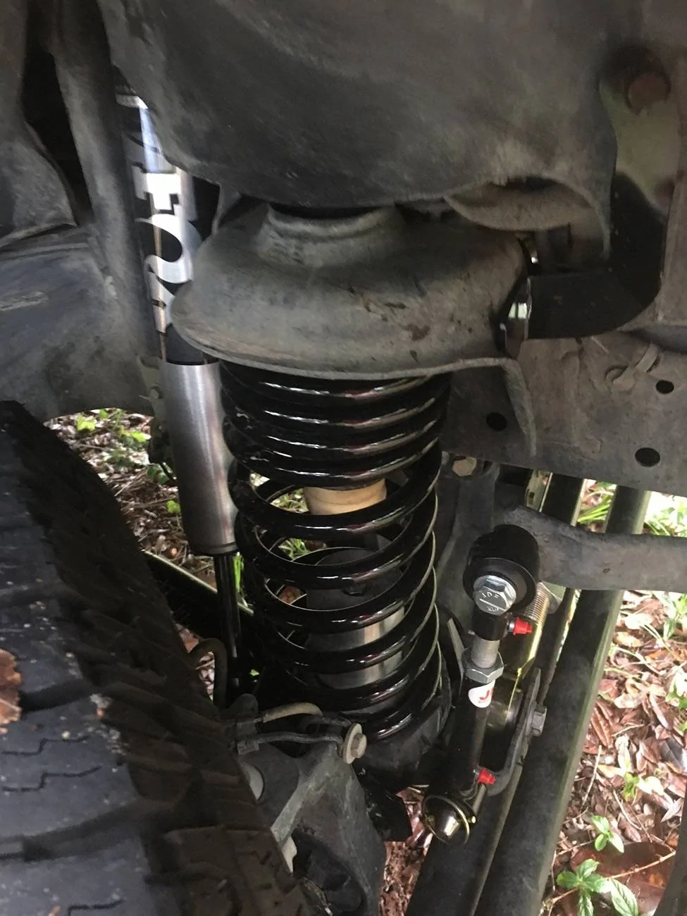

I ditched the tab too; it serves no purpose. As far as the process for connecting and disconnecting, you just have to park on level ground. I always carried a rubber mallet and a short pry bar, as I’m ”old” with various bad parts. It was always a piece of cake to disco and connect, only took two minutes total, without having to use a jack, crawling underneath, etc. You only need the pry bar to get the sway bar lined up, with little muscle or effort. The rubber mallet is for tapping the link in and out of the hole.
