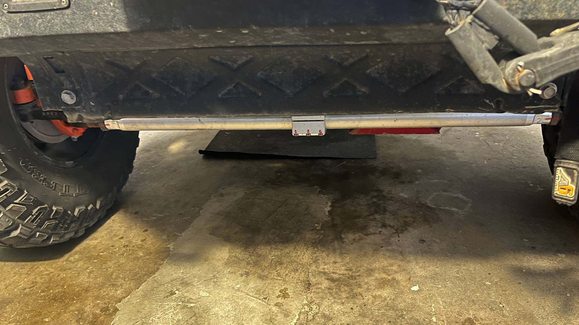

It's the plastic piece that hangs down under your front bumper.
Unless you got rid of it already.
I got rid of mine but I still have a metal skid plate of some kind there. I could easily reach behind it though to use the EVO manual disconnect. The guy at the shop mentioned you can get Rubi swaybars for $250 but I've yet to find that price.

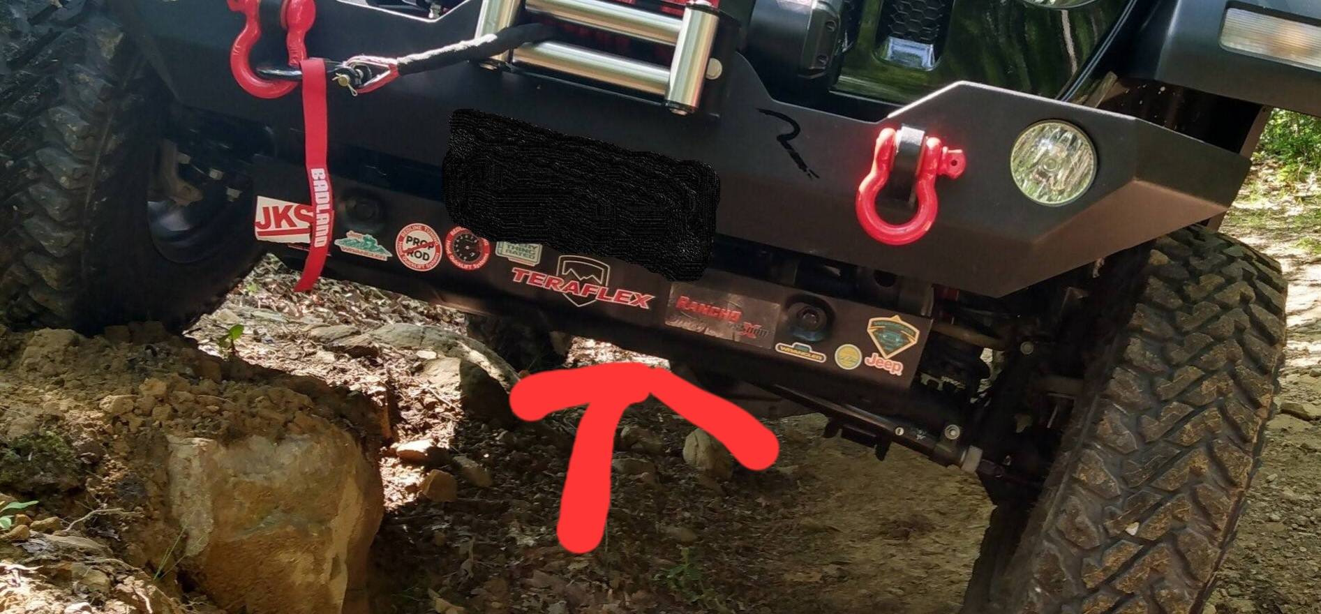

Somewhere around here?
Yeah you have an aftermarket bumper so it's not a concern for you.
