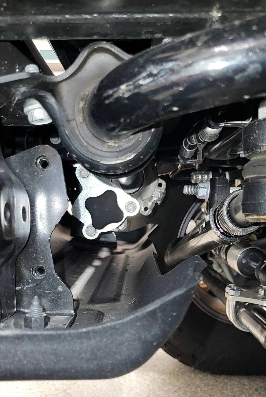

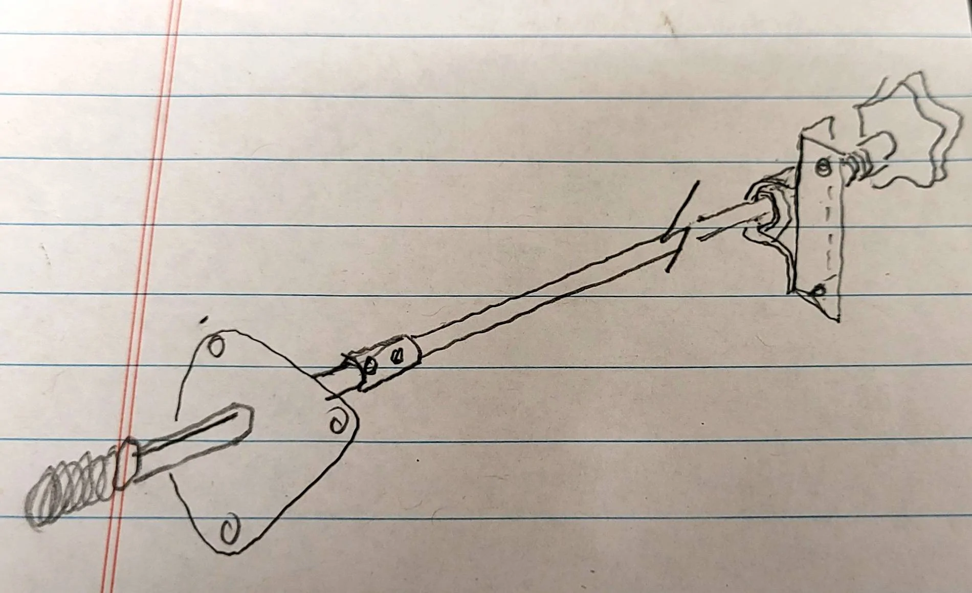

The "un-elegant" aspect of the Evo actuator, is if you have a Rubi bumper & steel skid plate (as I do). Getting to the Evo palm wheel is a bit awkward, (especially for an old guy like me) 😆
One night while imbibing in the shop, I came up with this solution. It can all be done with a few parts from the trusty McMaster-Carr catalog/website. A bit of easy bracket fab, a pillow block, coupler, and rod stock, and the knob can be located to a convenient spot under the pass. side frame horn. There are even threaded holes conveniently located for your pillow block bracket. Easy Peasy!.....
Have I done it yet? NO! 😉
You could even use a removable knob option, if you're worried about nosey fingers.
But I digress, don't mean to hijack thread.
