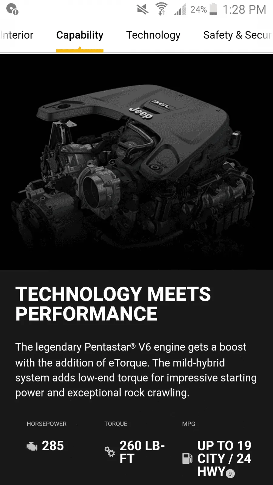

We can argue symantics, but my point is that those that have eTorque would read the header, as they do not consider themselves hybrid.
Hell, my 1983 S10 could be a mild hybrid if at the top of a hill---I could turn engine off, turn up radio, roll down windows, hold in clutch and go a long way.
Hybrid Jeep only exists in the 4xe.
Jeep Wrangler JL 2018 JLU mild hybrid 12v battery discharge Screenshot_2021-01-25-13-28-54
