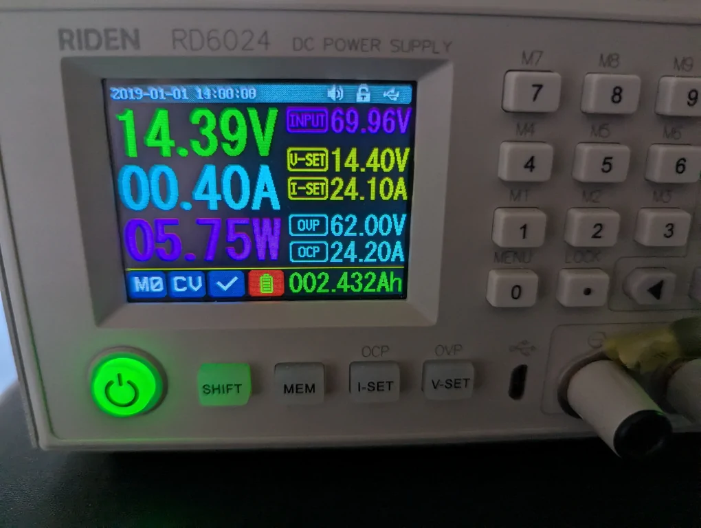

My JT sat for a full week while I was out of town. It took around 2.6Ah to full charge. That means it was still at 97% state of charge after a week.
After 2 hours at 14.40V it had taken 2.4Ah:
Jeep Wrangler JL Battery discharge at rest 14.4v.2.hrs
It's nearly done at this point. Most smart chargers would drop into maintenance mode before it even got this far.

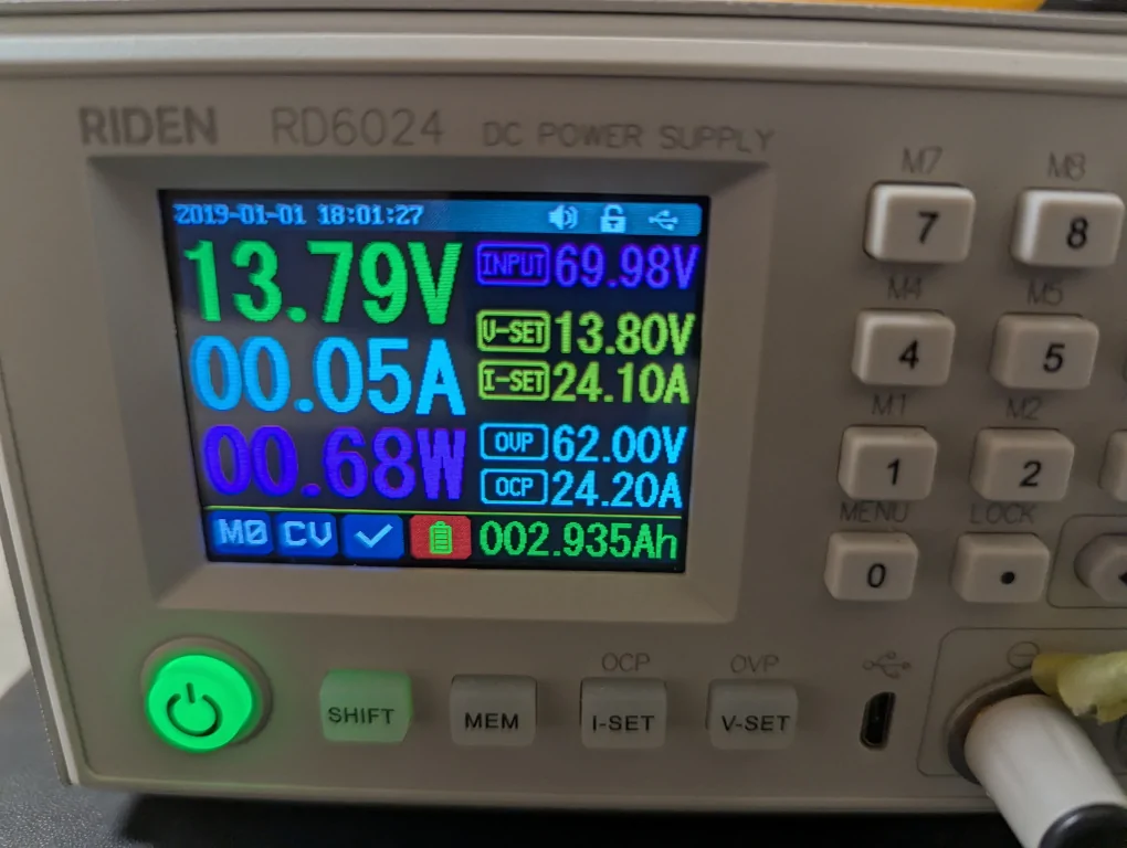

I turned it down to 13.80V and left it on for 4 more hours. It was done accepting charge by the time I got back to it.
