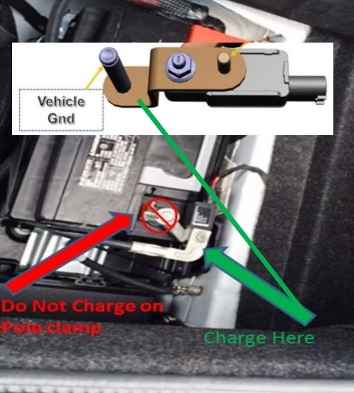

This is from a recent Jeep service bulletin
That’s basically the identical same place where I connect my maintainer to my Challenger.

I guess I’m just confused because the lug is pretty much flush with the top of that post, is it fine that the charger is just barely grasping on to a lug instead of a larger more solid contact area?
Yep, on the lug, as best as you can attach it. The IBS monitors battery usage and charging. It apparently gets confused if you leave it out of the loop when charging externally. I don't know what it does differently/wrong when it has been left out, just that it matters. Maybe it thinks you don't like it or care about it and it mopes around for a while doing things slightly wrong to get back at you for not keeping it informed.
