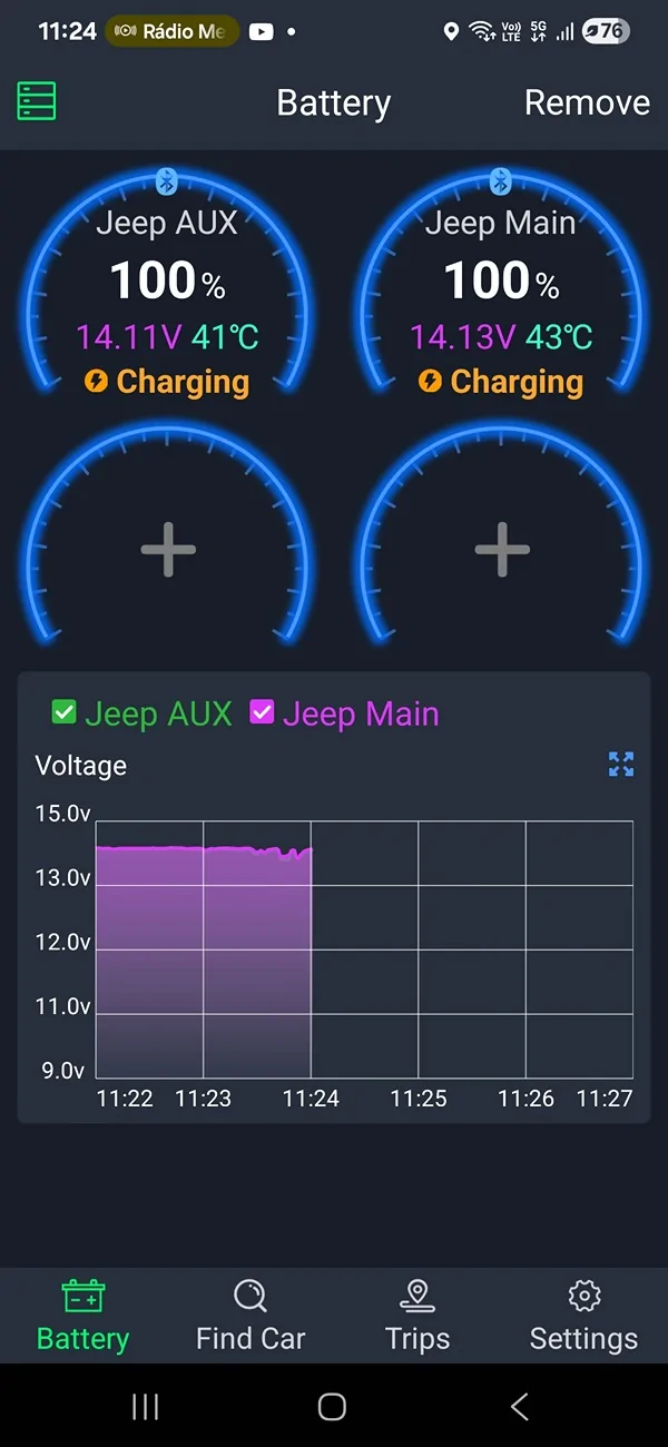

I replaced both the main and auxiliary batteries. I put dynamic AGM 70Ah and 12Ah. I drove and charged them to 100%. After about 4 hours with the car parked and locked, both batteries dropped to 88%.
That means about 9Ah in 4 hours. That's about 2.2A per hour. And the car would be completely discharged after less than two days.

Your photo shows voltages and percentages (apparently SOCs) during charging, both irrelevant for determining inherent and parasitic loads after shut down. So I don't think it useful to decipher and consider your reported data for diagnostic purposes.
