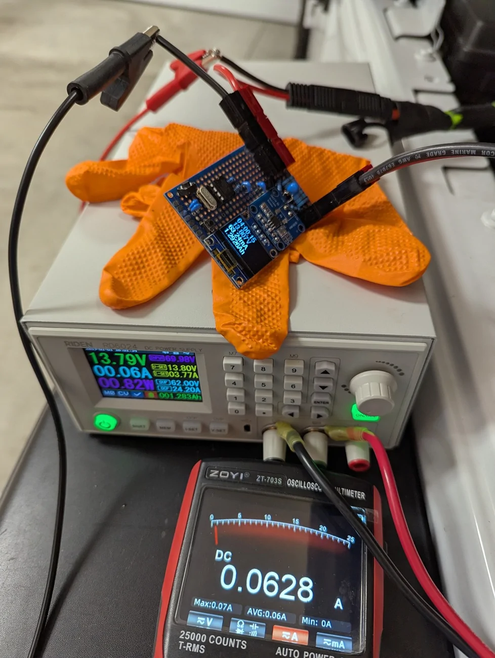

For fun, this was the situation after parking my JT overnight, moving it into the garage this AM, opening the hood and letting it sit another hour, then charging at 13.8V for 4 hours. There are two devices reporting charge delivered. All three show current:
Jeep Wrangler JL Battery discharge at rest charge_4
The 1.3Ah delivered includes whatever the Jeep drew since it was parked yesterday, plus the discharge of a cold start, plus the draw of the vehicle since shutting it off again, minus whatever the alternator managed to charge during the minute it ran.
The battery is almost fully charged at this point. The current would eventually drop to 30-40mA at 13.8V if I left it on.
Why 13.8V? Isn't that too low for end-stage absorption phase AGM charging?
13.8V is enough to fully charge an AGM. It's safe(ish) for a few hours at high temperatures and for much longer at lower temperatures.
A typical smart charger terminates 14.4V absorption when current falls below about 500mA, or after a couple of hours, whichever comes first, to avoid damage due to overcharge.
Just to see, I pulled mine up to 14.4V this AM. Current fell below 500mA in less than 10 seconds and was just over 100mA 10 minutes later. It would eventually fall below 80mA at 14.4V. The battery had been held at 13.4V overnight.
