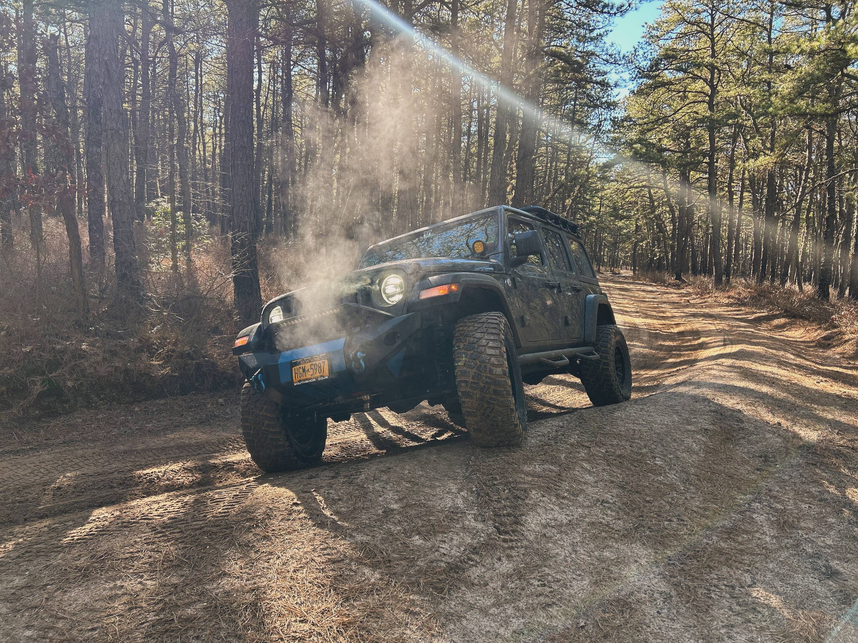

I got a little worried because after going through the water this happened. But I guess the water was sitting on top of the hot engine.
Gotta figure anywhere the water touches the engine block is going to be around 200F. Gonna instantly steam off.
Also with all that muddy water, probably be sure to spray out your radiators. Probably have some trapped mud that can cause cooling issues.

I did flush out the radiator. I guess I have to check the axle and transfer case tubes. Thanks for the advice.
