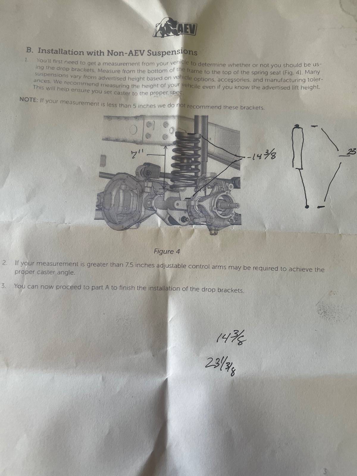

Teraflex replied with their bracket is designed for 3.5 of lift and probably wint work. I took these measurements.
Jeep Wrangler JL Teraflex control arm relocation bracket work with mopar lift. 87122A14-D7F6-46D2-AC5F-20BF06C35413

you will be golden. I have those same measurements(with 2000 miles on the lift) on my AEV 2.5 and run the square washers in the 3.5 position and have zero wander. one finger steering at 85mph. remember if you just installed it you will settle a bit after 1000 miles or so especially if you add weight..

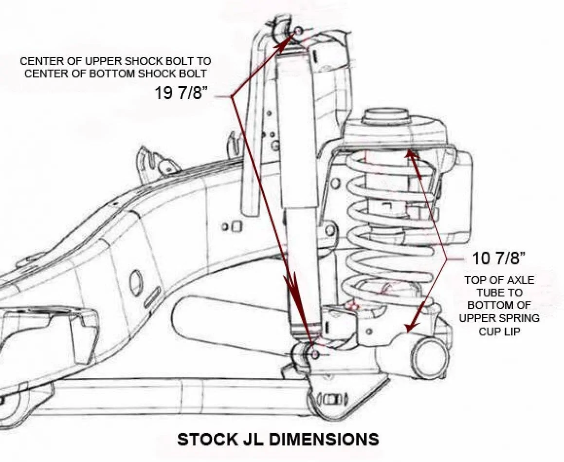

According to the diagram above compared to your measurements you got 3.5” of lift….
