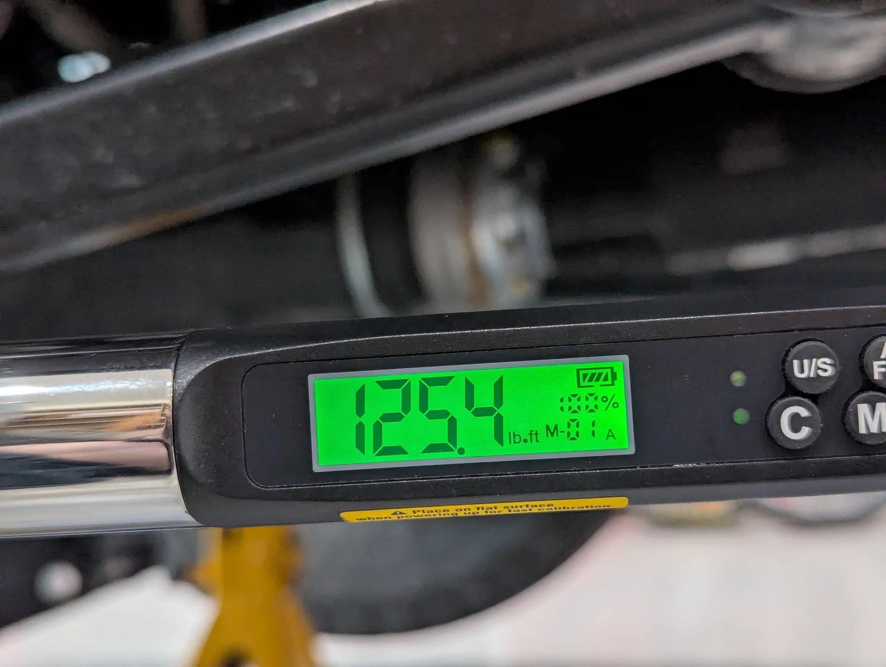

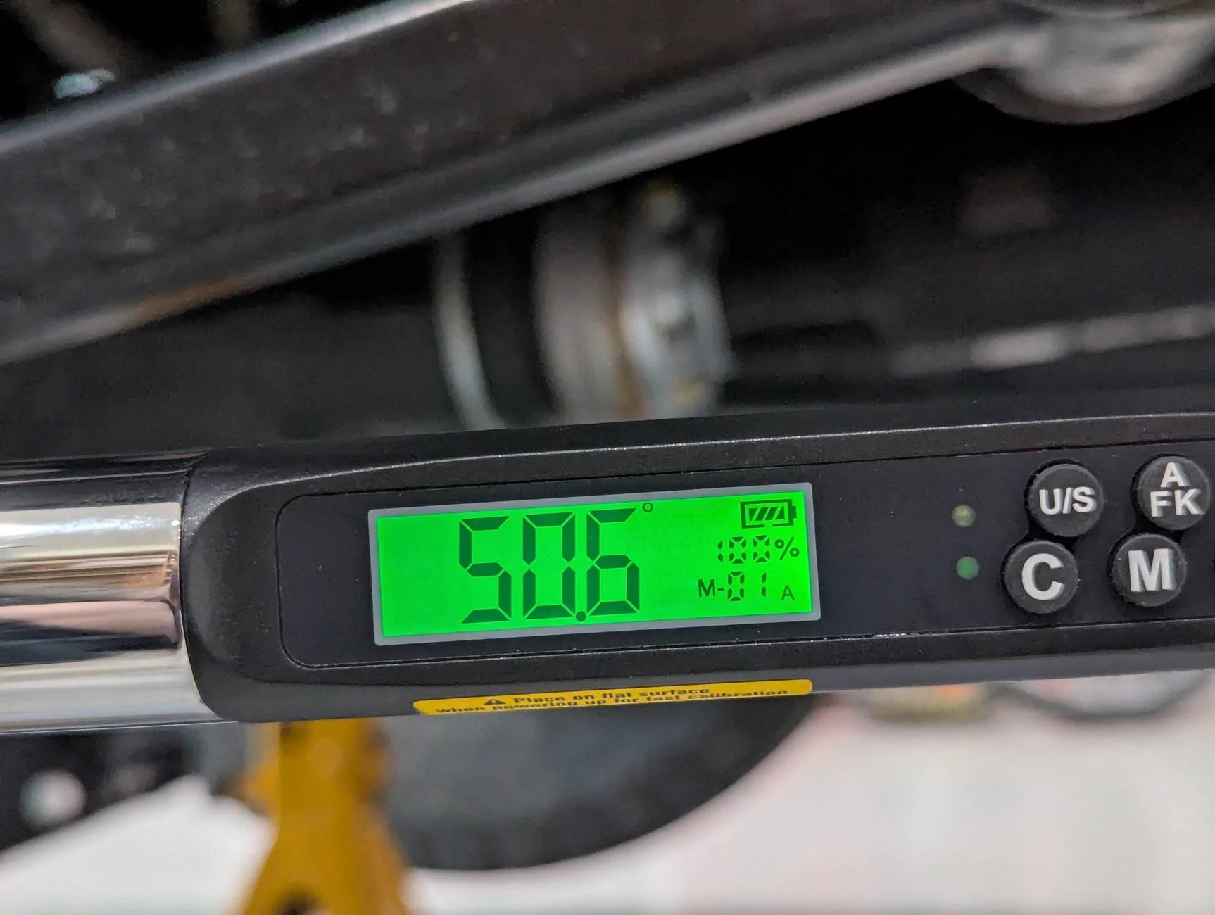

The rear lower control arm to axle torque spec in the FSM is 74 ft-lbs + 50° - That translates to about 125 ft-lbs. I say ‘about’ because one side hit 125.4 ft-lbs as the final torque and the other side was 129.3 ft-lbs. I calculated that it would be about 117 ft-lbs so I don’t feel too bad about the calculation. There could be some small error from the friction coefficient that I used or the modulus of elasticity that I used or something else. The Mopar lift instructions suggest 90 ft-lbs for that bolt. That’s quite a bit lower, but it’s probably what you want if you’re reusing the fasteners. Just don’t try to go to 190 ft-lbs like my instruction sheet said. You can see the results of that in the bolt that stretched. You can see the elongation compared to the new replacement and you can see the necking that happened compared to the straight edge of a ruler. The galvanizing was also flaking off of the bolt. I’m glad that bolt didn’t break!
Final angle measurement on the digital torque wrench.

And the final torque after going to 74 ft-lbs + 50°.

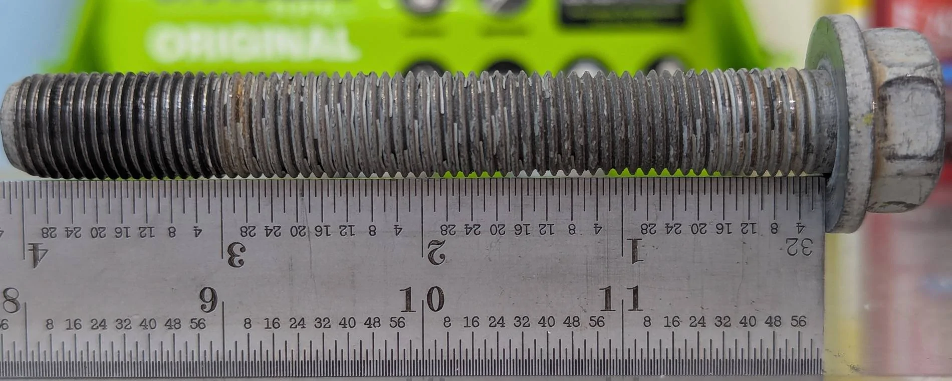

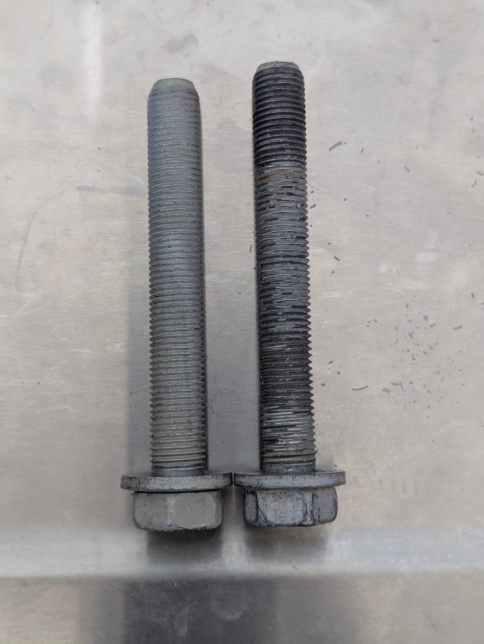

These bolts should be the same length. The one on the right was stretched an additional ~3mm while under tension.
Jeep Wrangler JL Mopar Lift - Control Arm Torque Question PXL_20250725_174328093
Necking deformation of the failing bolt. So glad this didn't break!
