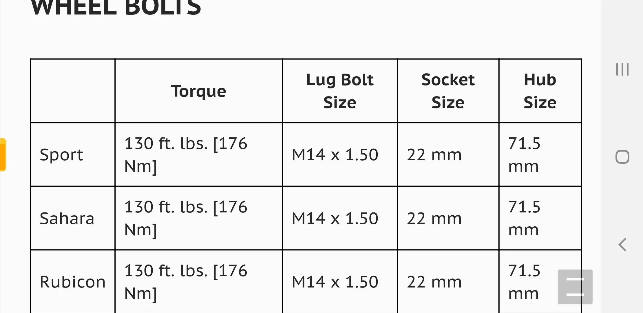

Are those spacers hubcentric, like those from Borah and Synergy? That's an important part when it comes to wheel spacers. Also, torque specs call for 130lb/ft on the lug studs.

yes, they're hubcentric. I'll re-torque them tonight when I get home. Thought I read 110 somewhere.. Thanks!

Some wheels only state 100ftlb.. like my beadlocks.. So I have no doubt it varies.
