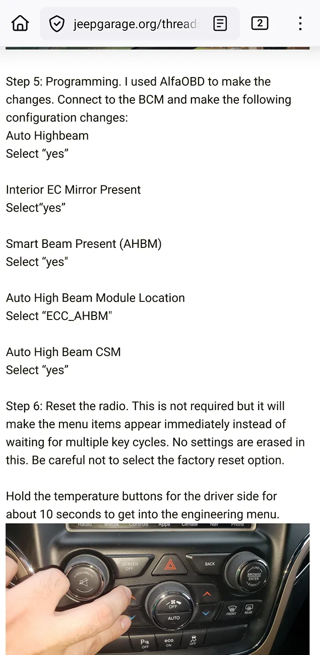

There is a YouTube ZAutomotive Tazer capabilities video about the need to remove the tazer for temporary service. I have done it myself, just for experimentation. It works, easily with extension cable to remove the tazer and plug things back in. No reboot prior to removal, no need to unmarry. The only difference is no live options and code entry to unlock security during start (Jscan does not have that).
One thing I will do is obtain AlphaODB to modify settings that Tazer enables for Auto High Beam, but does not fill in extra bits required to make it functional. Here is what is needed to allow tazer addition to radio settings High Beam in the menu to work.
Jeep Wrangler JL Tazer versus JScan {filename}
I like this and will try it out. I enabled in my Tazer, selected it on the radio in the Lights section. Check mark it then 3 secs later it unchecks. Will get AlphaOBD and try again. Unplug Tazer and use the SGW bypass cable to make these changes?
