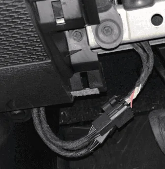

I have the extension cables to make access to the Tazer module easier. I did not reconnect anything to the SGM, just removed the Tazer JL. It sounds like user error on my part. And thanks for clarifying the "unmarry" before the dealer visit, not just remove. I'll try again now that I'm not rushed sitting on the side of the road before entering the dealership!
When you remove the Tazer, reconnect the OEM/vehicle cables into the extension cables. Leave the extension cables in place. You want it to look like this when the Tazer is removed:
Perfect. Thanks for the photo - that always helps.

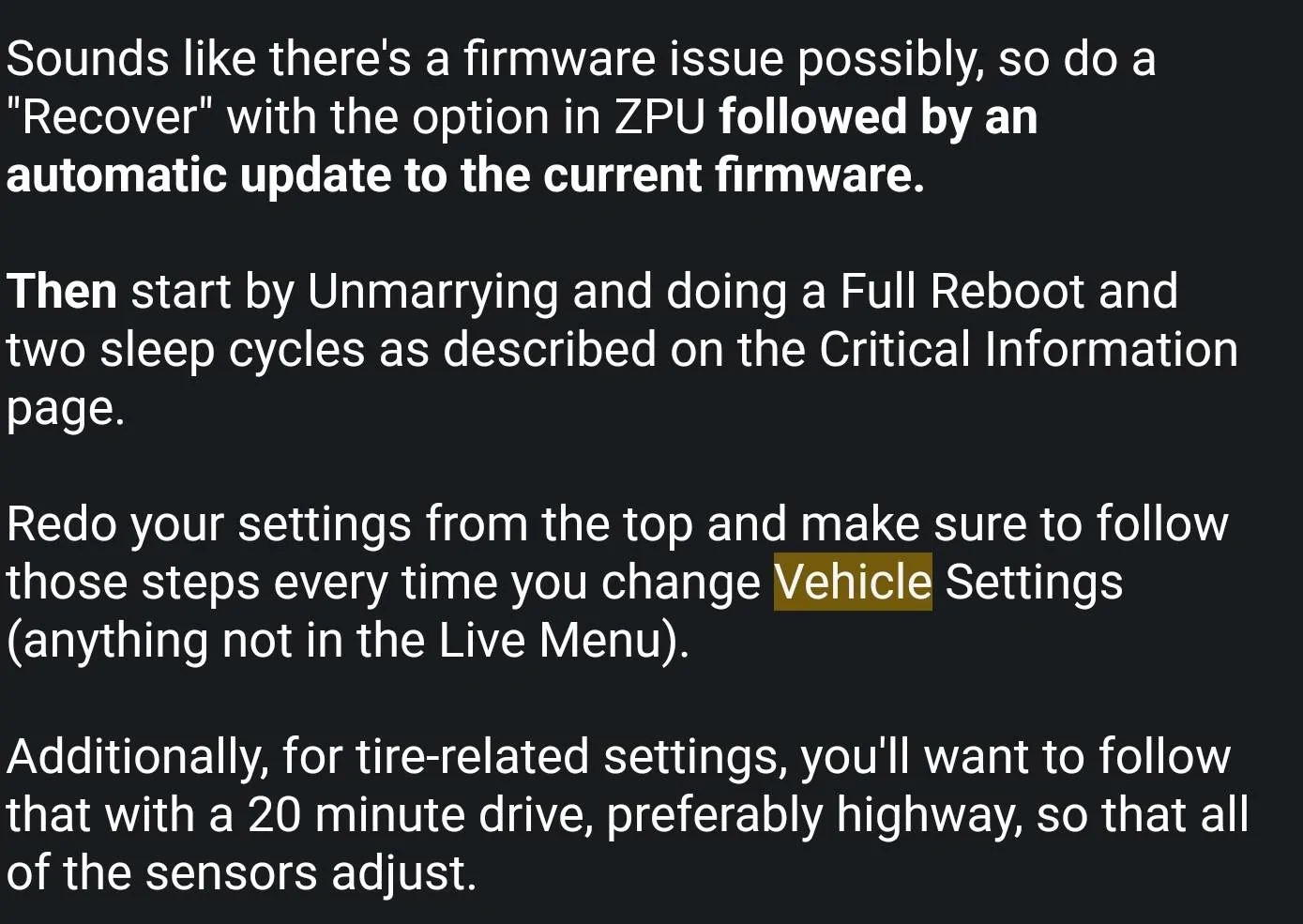

It's when you connect the Tazer to your computer, run their software, then have their software push new code into your Tazer (whatever terms they use for that process).
If that process doesn't go perfectly then it behaves strangely. That happened with mine.
They sent me this email about it finally.
Jeep Wrangler JL Tazer JL Screenshot_20230401_180235_Gmail
Which is what I assume the same as what you're speaking on. It returned things back to stock settings. I followed all their advice to the T, went out and it finally did change my lights to the amber turn signals, but the main issue for me is the 'Service Shifter', because it changes my gears when I drive, and beforehand would auto-park my vehicle several times at low speeds and once at a stop light - extremely unsafe.
That 'Service Shifter' warning came on once again after following all of their advice, doing the reboot and sleep cycles fully, and I have video of it changing gears on the road, even in manual mode, which is not comforting.
I would like and have tried to give it my best shot, and benefit of the doubt, but it's a liability.
I'll be responding to them with my videos as I did before.
