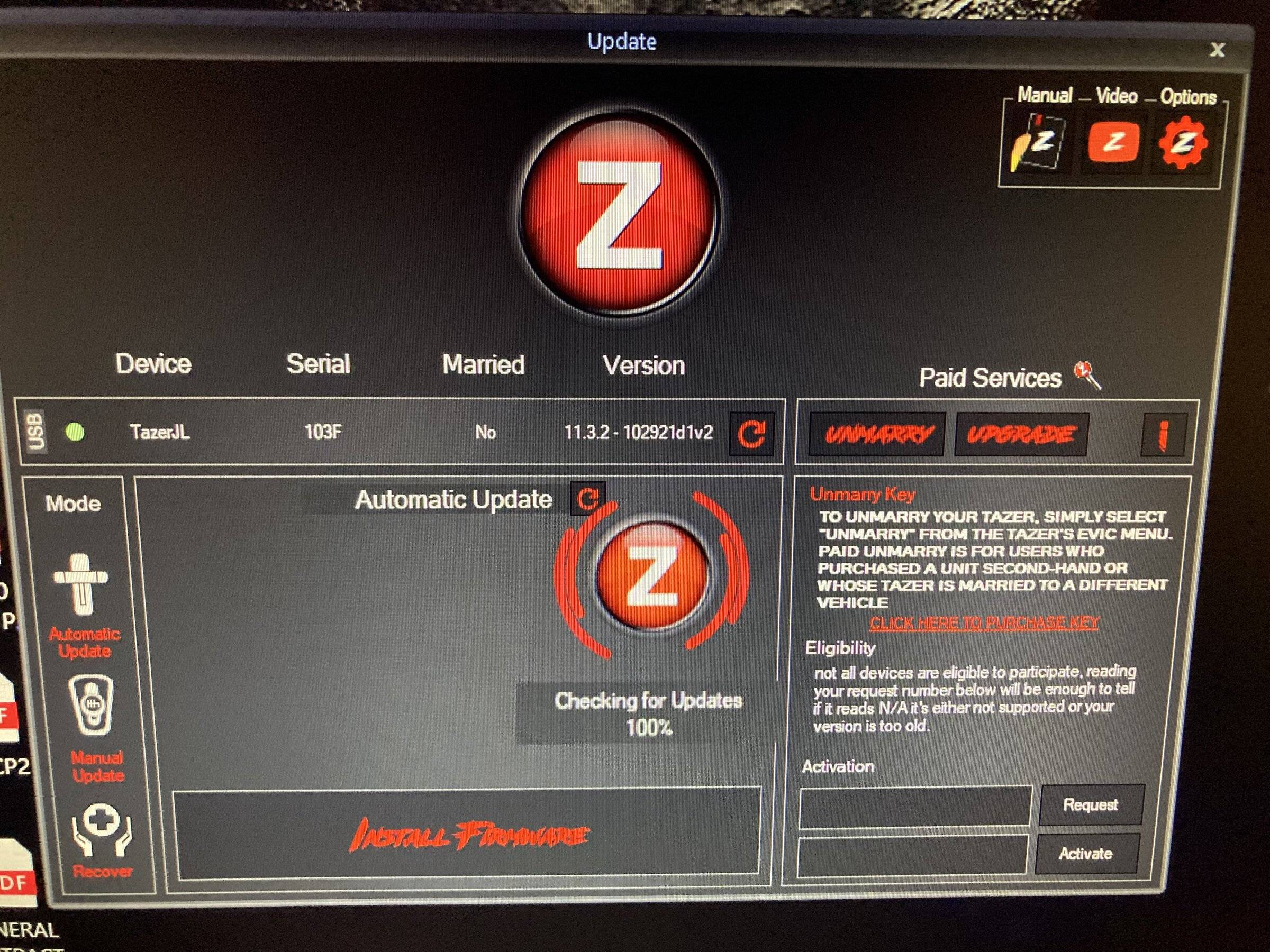

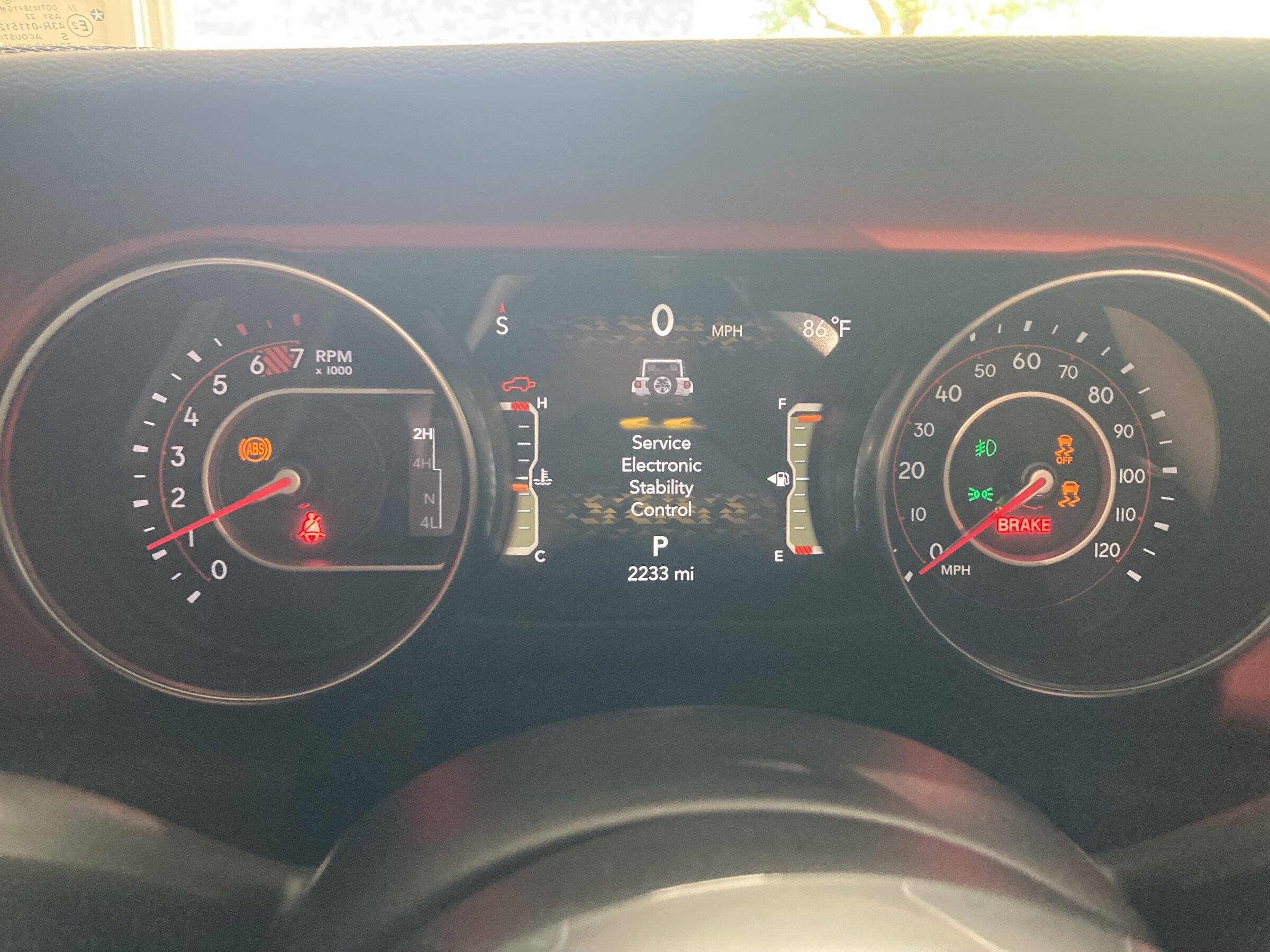

Hate to jump in someone else’s thread with my issues but it seems like this is kinda a free for all.
I received my tazer yesterday. I downloaded everything to my PC and tried updating it. No luck after multiple tries and almost 3 hours. It just spins the progress icon and goes nowhere. I finally said screw it and went out and installed it. Everything seems to have worked but I discovered something today.
I decided to turn the traction control off for the first time. I was curious if it changed anything with the engine tuning. I did this stopped at a redlight. No issues with one press but I decided to press and hold it as this disables more nanny features in some vehicles. When I did that I get service abs, service stability control and almost every other warning light on the cluster. The engine surged to a higher rpm for a second and went back to normal idle. I drove it about a mile to where I was going and shut it down. When I restarted it everything appeared normal and no issues on the 3 miles home. I went out and tried it again a few minutes ago and get the same results. Anyone have any ideas? Is this some short cut to something in the tazer or just some random glitch that pisses it off? I have not unmarried and removed it yet to see if this stops but I feel like it’s probably related to it. I guess it may not really be a problem but I am curious.

@Jwb211
There's no way I would plug a potentially problematic PROM in my vehicle. I would sort out the update first. Unmarry, update Windows, reboot, reinstall the Z utility, reboot, redownload the latest firmware and try again with a different USB port--a USB 2.0 (not blue) that is on the motherboard connectors. If there's still a problem, I would contact support.
Also, did you do the full reboot and two sleep cycles?

Unmarry the Tazer, and see if you still have issues. I have had NO PROBLEMS with the Tazer. I bet you don't have any issues.
Sorry to hear Your experience may be different.
Idk about this press and hold on the traction control. I haven't tried that on my Jeep.
Unmarry it, run the software updates again, and if the updates aren't working, for heavens sake, don't plug it in your Jeep!
I was VERY WARY of this product. But I've had zero bad experiences, and absolutely no issues with it. Maybe I've been lucky.
It may not be a problem as everything seems to be working including all my changes. Holding the traction control button down probably doesn’t do anything in the Jeep but I was curious. Ford and Chevrolet both make or have made vehicles where holding it down turns everything off versus one touch just turning traction control off. I had no concerns with using the tazer as I thought it was “the way” until I started reading some on here.

From what happens with my experience it is normal. If I don't hold TC button for long press I will still have some nanny controls working. All the lights and warnings you have is what happens with mine. When I wheel and need 4 LO I don't like the nanny stuff. What I have found is when the TC button is activated by 4 LO engagement or if I short press it I have some of the nanny stuff working. What I have found out in my case is that if you don't have an updated version, when you long press TC button front axle will not engage. All the lights you commented about light up. You now have low range but only rear wheel drive. Shut off jeep and restart and all is back to normal. I updated tazer to latest version and now when I long press TC button and do a double tap on TC button I have both front and rear axles engaged. So I guess I have a choice now to run in LO range with rear only or both axels engaged. The long press of the TC button operation is listed in your jeep manual. I believe that with the newer JLs that the electronic clutch in TC is different. I could be wrong. All I know is that it now works as I need it to. Hope this helps. I would be curious if this works the same with you.

Here is a quote that I received from Z-Automotive.
"I'm thinking you may have old firmware in your Tazer. In the older firmware, there was a setting called Front Axle which would delete the entire DTCM module when set OFF. This would also kill the lockers and the transfer case position indicator. The old firmware also did not have the ForceAWD when in TrackKill mode.
Please check the firmware and make sure it's updated to the latest version (11.3.6) or at least 11.3.5. Unmarry first before updating in your case, as we want the DTCM enabled but FrtAxle set to NO. Then you can remove the FAD module entirely without issue.
With this new firmware you'd then press and hold traction to kill it altogether; invoking the factory Dyno mode where the factory tests these jeeps on a RWD roller. Double-tapping traction then would toggle you between AWD and RWD."
