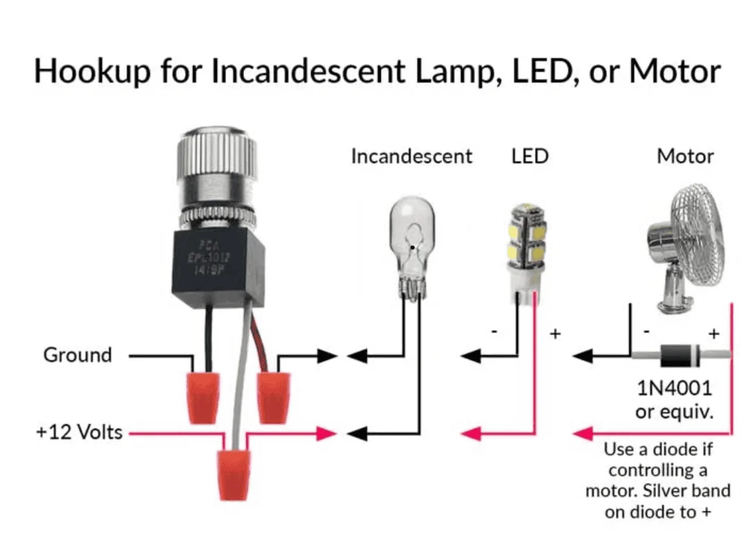

I just ordered this same switch for my install. Looks like it has three wires - black, red, white. So, do I connect the black to ground, red to the supply (cigarette lighter), and white to the Brawlee light? Thanks!
It should come with an electrical map in the package and below is the setup I used when installing mine. Hardest part was finding an incandescent bulb and fan to hookup along with the LED. Kidding!
My one recommendation would be to buy some extra wiring so things don’t become so tight back there. This helps with two things: 1. more options on where to place the switch; 2. if you ever need to take that paneling off again, you won’t have to worry about ripping the wiring.

I’m working on a fully custom LED strip with magnetic reed switch so it will automatically turn on when I pull up the tailgate window and that dimmer switch is a pretty good addition, if it also fully turns off the power in addition to dimming it.
My three wire version shuts off power and it looks like @dpike confirmed the four-wire version does as well. There is an audible, and quite satisfying, click when turning the switch on or off.
Awesome thank you! That good-feeling click is indication that it indeed does completely break the circuit, instead of just lowering the voltage enough where the LED shuts off.

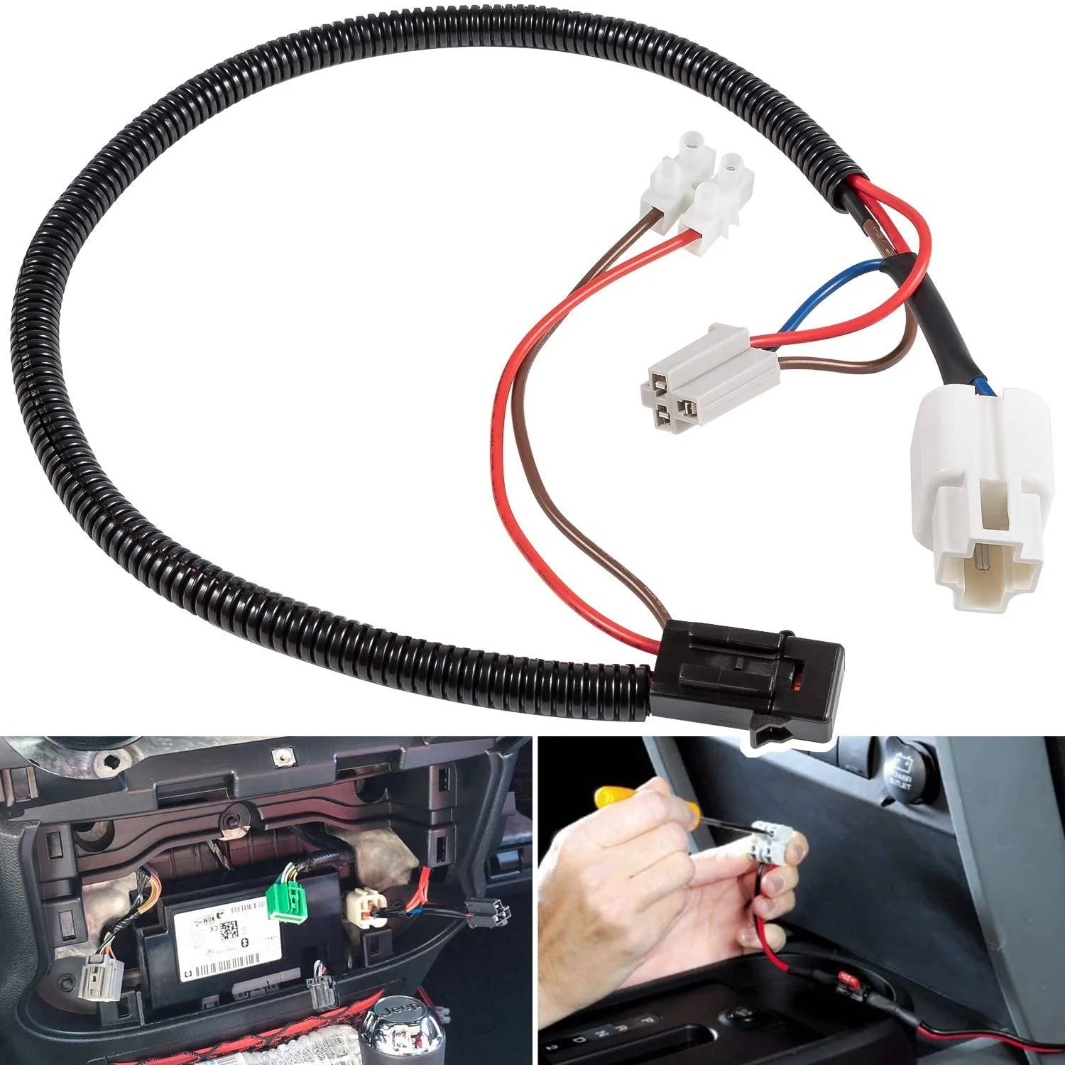

i was able to just push the connector thru, maybe a little jiggling, but it wasn't a hassle.
i used one of these taps from amazon when i did mine. plug and play, didn't need to cut or splice into and OE wires.
Ah cool. Do you have a link? So assume one end connects to the OE 12v plug and switch then the other end the light bar wires terminate into?

One last question. As you said one end to the 12v lighter, the other w/fuse to the led bar. The 3rd part (on the end where 12v lighter goes) is that where your switch terminates? Might be obvious but wanted to be sure.
the back of the 12v port has a clip where you can remove the wiring harness to it. the grey and white ends connect to those. so youre basically splicing inline this connector to the back of the 12v port and the harness that goes into it.
so the first end i mentioned has 2 connectors, a male and female, that inline splice into the existing wiring to the back of the 12v port, the other end after the fuse(little black box) connects to the led (but you'll need to use a switch or that dimmer otherwise it will always be on)
if you have any other questions feel free to PM me.
